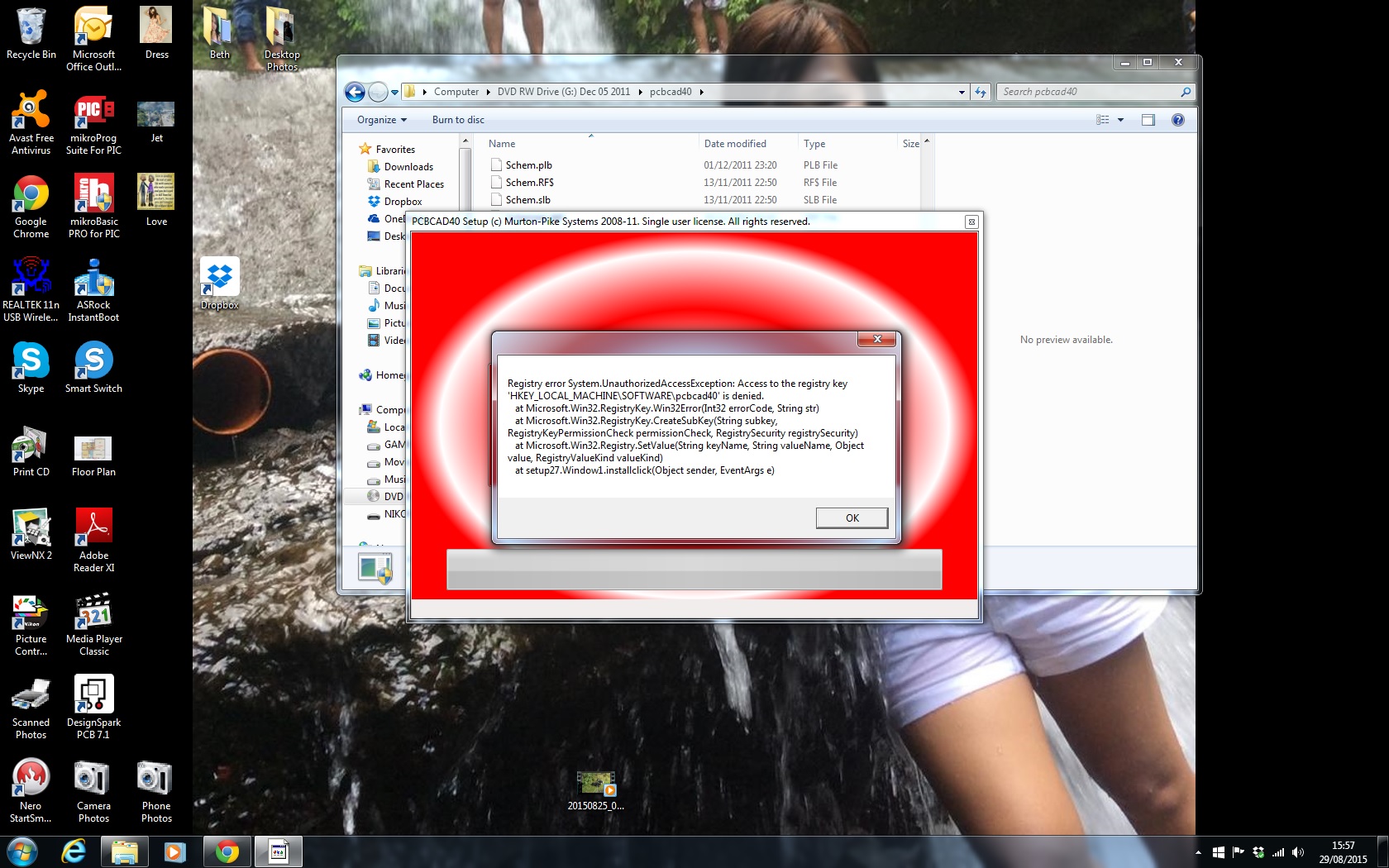

Try installing it while logged in as administrator or right-click on the installation file and choose "Run as administrator."
I've contacted Nigel but all he wants to do is sell a more up to date version. My Dad paid good money for this and never got it to work.
It does install using Admin rights but it doesn't work. Why is the original publisher so difficult to approach ?

It hasn't installed because you didnt follow the instructions in installation sheet. I have sold 1500 copies so know what problems arise.
I've tried DesignSpark but I can't seem to locate any component libraries. The raw libraries don't have many through hole components.
I followed the instructions to the letter.
Then the issue must be with your pc.
It worked on dozens of other customers computers.
If you pm me I will send you a link to a download of pcbcad51 and I will give you a software key for it.
This will be free and offer of good will to a previous customer.
