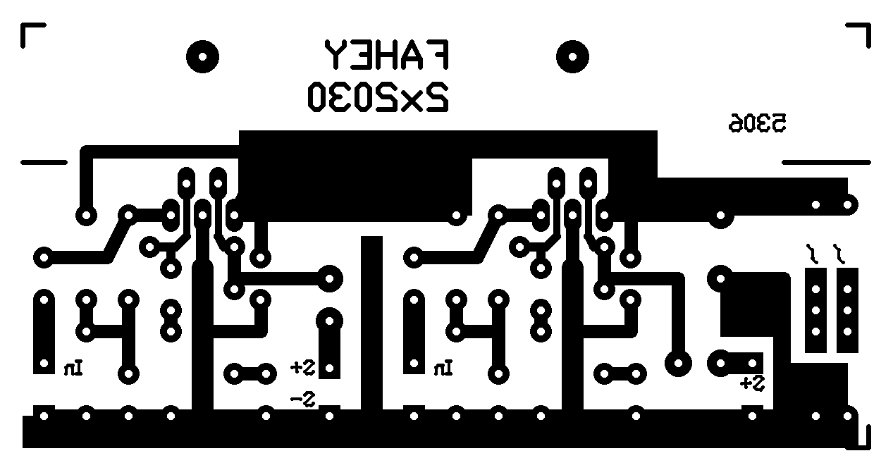

FWIW, although you *can* go down to 10 mil traces in toner transfers PCBs, I prefer to use 30/40/50 mils if possible , even more in power/ground/speaker tracks (70/100 mils) and liberally apply fills, specially to ground.
Never use the cheesy automatic copper fill, but hand apply fills where *I* want.
I *might* neck down to 15 mils for a very short length, as in passing between 2 transistor pads, but go up to 30 as soon as I'm through.
Problem with toner is that it's a "barely melted solid", and it does not "flow" to cover pinholes.
Now, a pinhole which does not matter in a 30 or more mils track, may be a thin track killer.
Worst of all is that etching *enlarges* pinholes (imagine a cavity in a tooth, and for the exact same method: acid corrosion), in PCB speak it's called "undercutting" which means exactly that, at edges and holes, acid eats **under** the ink , making holes larger and tracks thinner than intended 😱
Talk about raining on your parade!!
What's nothing on a thick track, becomes a problem in a thin one.
As an example, here's a 2x15W amplifier PCB (single supply) showing that.
It's *easily* printable with toner transfer.
EDIT: I forgot, try to use 100 mil pads for parts, more for larger ones like filter caps, power diodes, etc.
Copper is your friend 😀 😀

Ok, if 2x15W is enough for you 🙂
The schematic is basically the single ended application shown in the datasheet, I'll print the component overlay.
Give me a couple days, because I still use pre-historic Autotrax and Tango PCB, DOS version 😱 , so I have to make some Graphic format conversion.
Thanks! 15 watts is right in the range of what I', interested in doing these days. I doubt I'd build the amp. I more want to see how proper routing is done with a project simple enough that I can follow it. I could tell from the pic that its 2 channels, but that's about it.
When doing toner transfer, is it difficult to get those labels to etch cleanly? (the in, and what I presume are labels for the power rails)

Ok.
The smallest ones, yes, you often get some broken letter , or lose some dot.
Those letters use 10 mil traces, that's why I said that's the practical limit for a kitchen made PCB.
I make production quantities and silkscreen them, but that's not practical with ones and twos.
If you have an important project, photopositive PCBs give you *incredible* detail, although they are somewhat more expensive.
