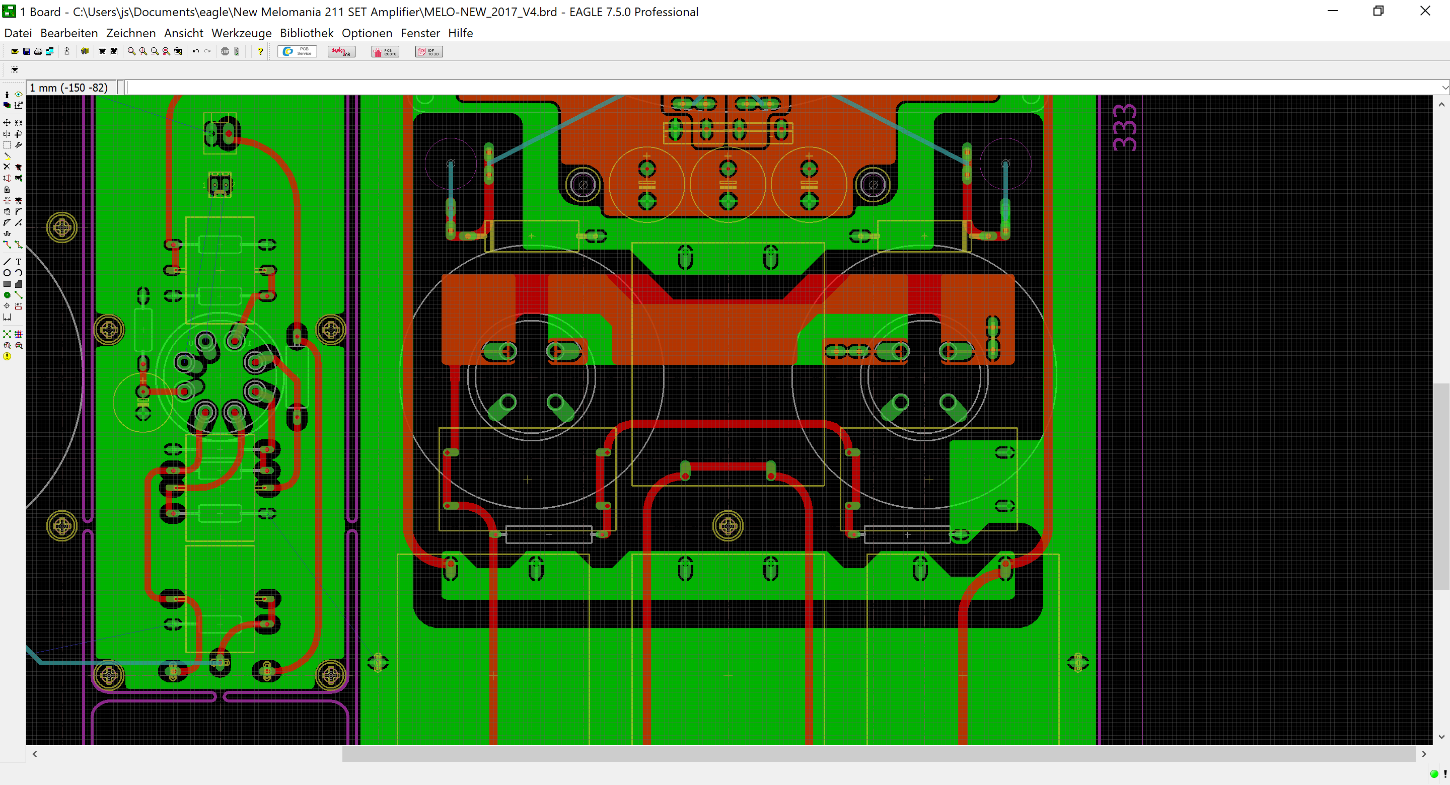

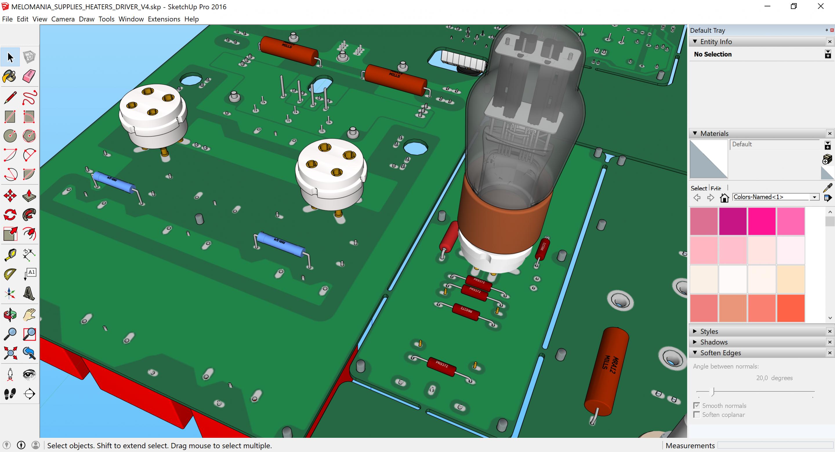

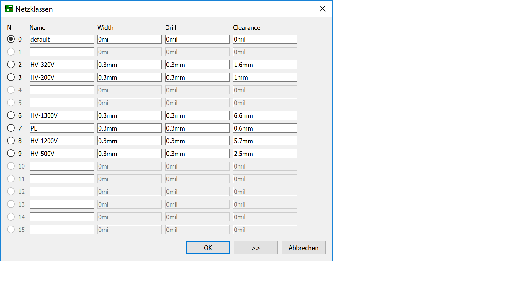

PCB Trace clearance for the Tube circuits
Use net classes ECAD capabilities.
Attached examples.
JP

Creepage calculator treat Vdc equal to Vrms..
If you do not get actual ARCing, or a tall-spike waveform, most of the effects of leakage will be related to the "average" voltage not the peak.
RMS is not Average but all this is so approximate that a 10% (Sine) difference is unimportant-- we take at least 2:1 safety margin, hopefully more.
