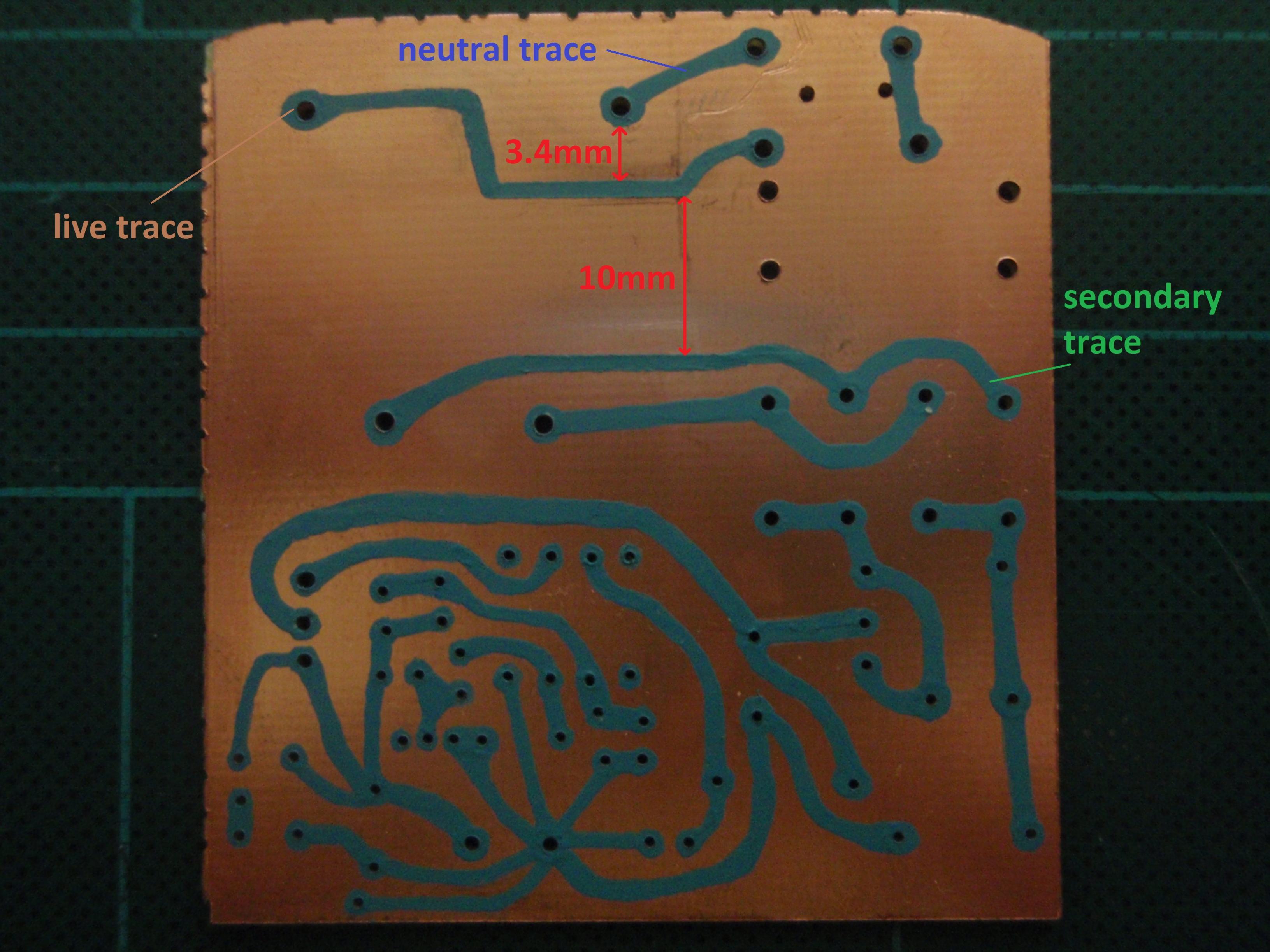

You need at least 2.5mm between live and neutral, so your revised layout giving 3.7mm is more than adequate.

After some work, I got my new pcb design. Now, clearance of live/neutral is at least 3.4mm and live/secondary 10mm. Much better than before:

In that case you need 5mm between live and earth as you are building an appliance with reinforced insulation (no portective earth requires reinforced insulation).

How about the solution of adding an FR4 barrier between the two traces then? This should ensure that clearance is about 6mm at least.
As I also suggested, maybe I could solder (using glue) some wire insulation so that it would completely cover the live and neutral wires. What do you think? 🙂

One thing that came to mind: what if I actually used an insulated wire to make the connection of the live wire that is close to the neutral? (picture at post #25 will show what I mean). I mean, leaving only the pads where the pins of transformer and fuse will go, and soldering directly to them the wire.

creepage distance is where the voltage can track over a surface so is longer than clearance, if you put a SLOT between two pads you can get away with the clearance distance, the slot has to be 1mm or wider to conform to IEC-60950.
If you use 8mm gap you will be covered for most if not all situations. One of the biggest problems is during the development and testing phase of design, when boards are usually on a bench being worked on, any measure you can take to avoid accidental touching of live parts is good practice.

Marce, thanks for the response. Sadly, I don't seem to have all that space to provide an 8mm gap.
I think that the solution of making the live wire an actual insulated wire would be quite adequate, based on everything you say for 0.4mm insulation. How about that? Quite simple, I think. If I don't make it clear enough, let me know so I provide a picture of what I mean.

So I present my idea of using insulated wire instead of a pcb trace:
And covering the solder connections using wire insulation or even heatshrink tube - I have one that goes from 3.0mm to 1.5mm and says 600V on it - sounds good enough.
This way, actual live/neutral separation should be 10mm, where they enter the pcb.
So, how does that sound to clarify for reinforced? 🙂
