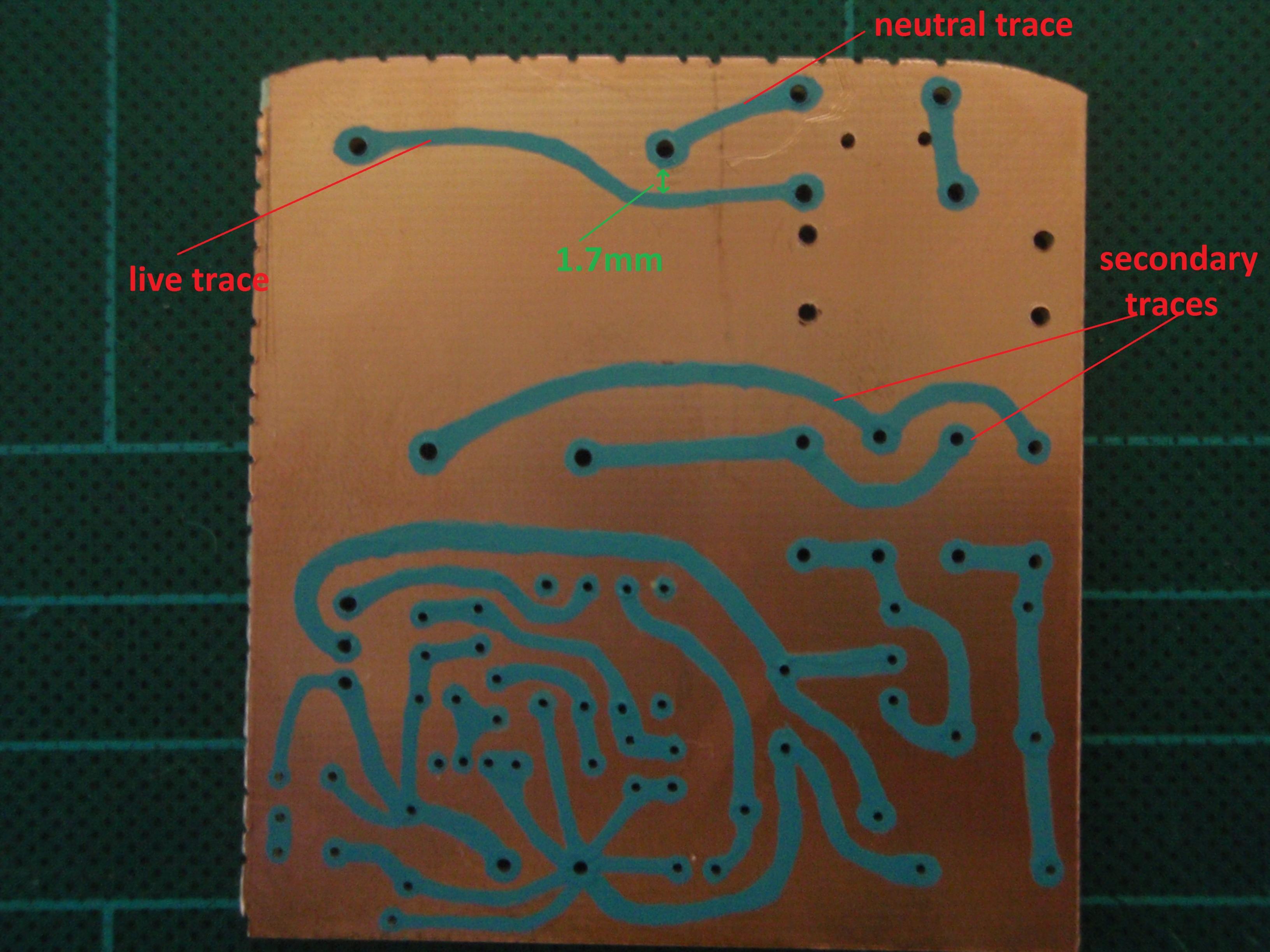

I designed a pcb that has live and neutral on it, and I would like to know about the proper spacing between them. Since I have read that even 1.0mm should do.
The closest distance between the copper trace of the live and the one of the neutral is 1.7mm. My pcb is single-sided, bare copper (no solder mask or tinning), FR4. Mains is 230VAC, nominally.
Is that enough? From what I read, I understand that it is, but I would like to have another opinion.
I was also thinking about "filling" the gap between these two traces with some plastic that I would adhere (using glue) to the FR4 piece of board that lies between them. That could be some cable isulation, a small piece of FR4, ordinary plastic etc. I just thought it would weaken the possibility of an arc since no longer would just air be separating them. Is this rational? 😕

Marce, thanks for your time. I doubt that I can get hold of something like that (especially since I don't really think I will seriously need it again), but I will see what I can do.
Could ordinary glue do the job? Just a drop of it maybe.
KatieandDad, I attach a picture of the pcb. It is ready to be etched, so you will notice that I have covered the traces I want to remain with blue paint. Separation of primary-secondary traces is at least 10mm, as can be estimated by the picture too:
So I think that the clearance can be guaranteed. 🙄
This is my situation anyway, I was thinking of filling that air gap with something plastic, glue, or epoxy as marce suggests. Depending on what I can find.
10mm is more than adequate. After you have built the PCB just paint the traces with (anything). Wife's nail laquer if she's out.
Thanks! About the live to neutral? Is 1.7mm ok?
Considering I will drop something on traces - maybe an adhesive rubber foot (these small transparent ones), paint it or as you say, use nail polish, I think it would be ok.
Hi I am confused as you spoke of 30 V DC and now I read Live and Neutral. If you are dealing with 230 V then 1.7 mm is not enough. You could drill a hole just between the two tracks... Air is better than epoxy. If you still can change the PCB I would do so. Make that 4 mm just to be safe.
