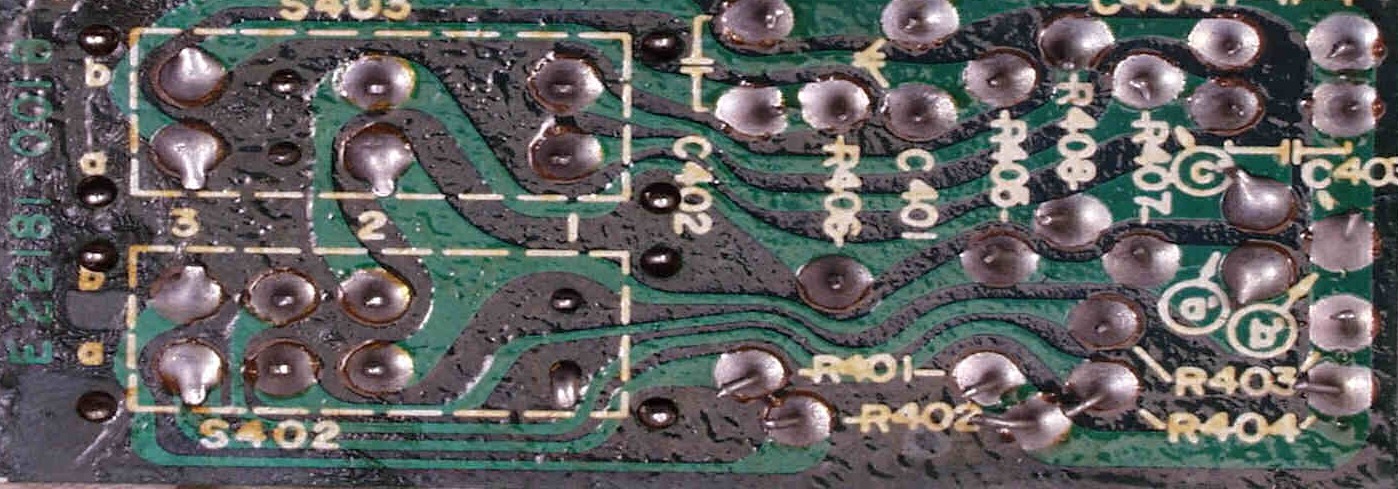

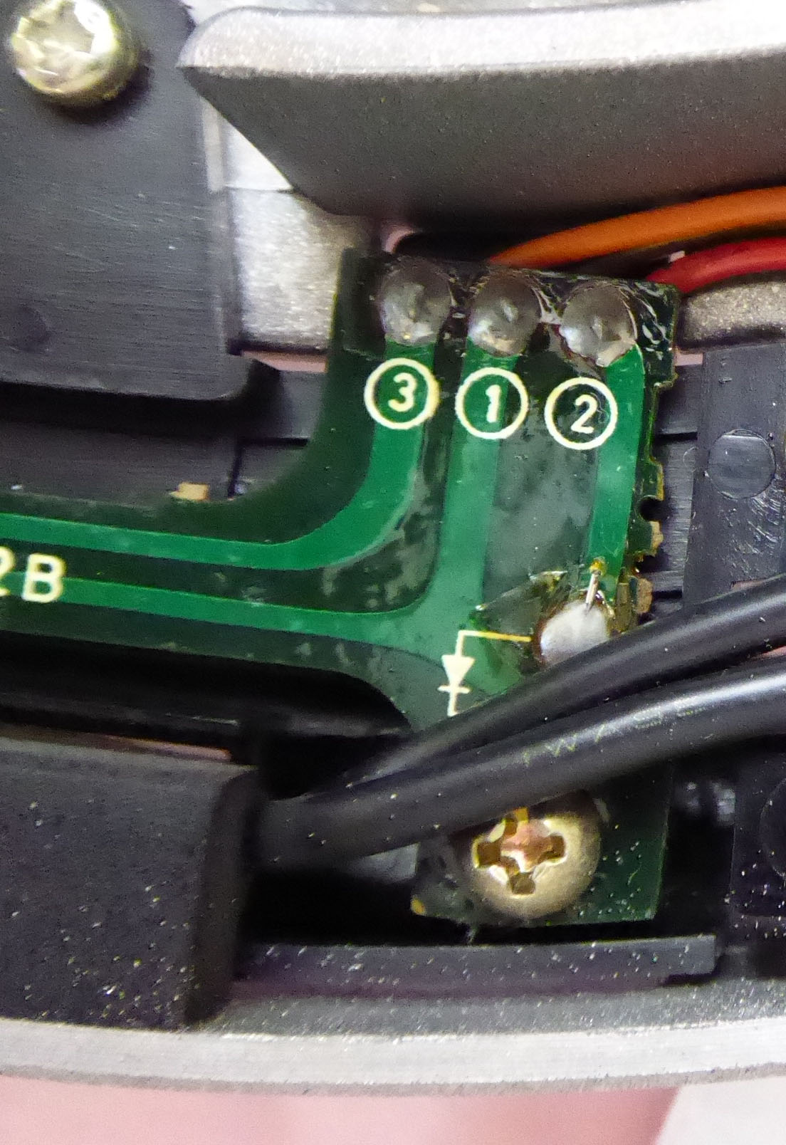

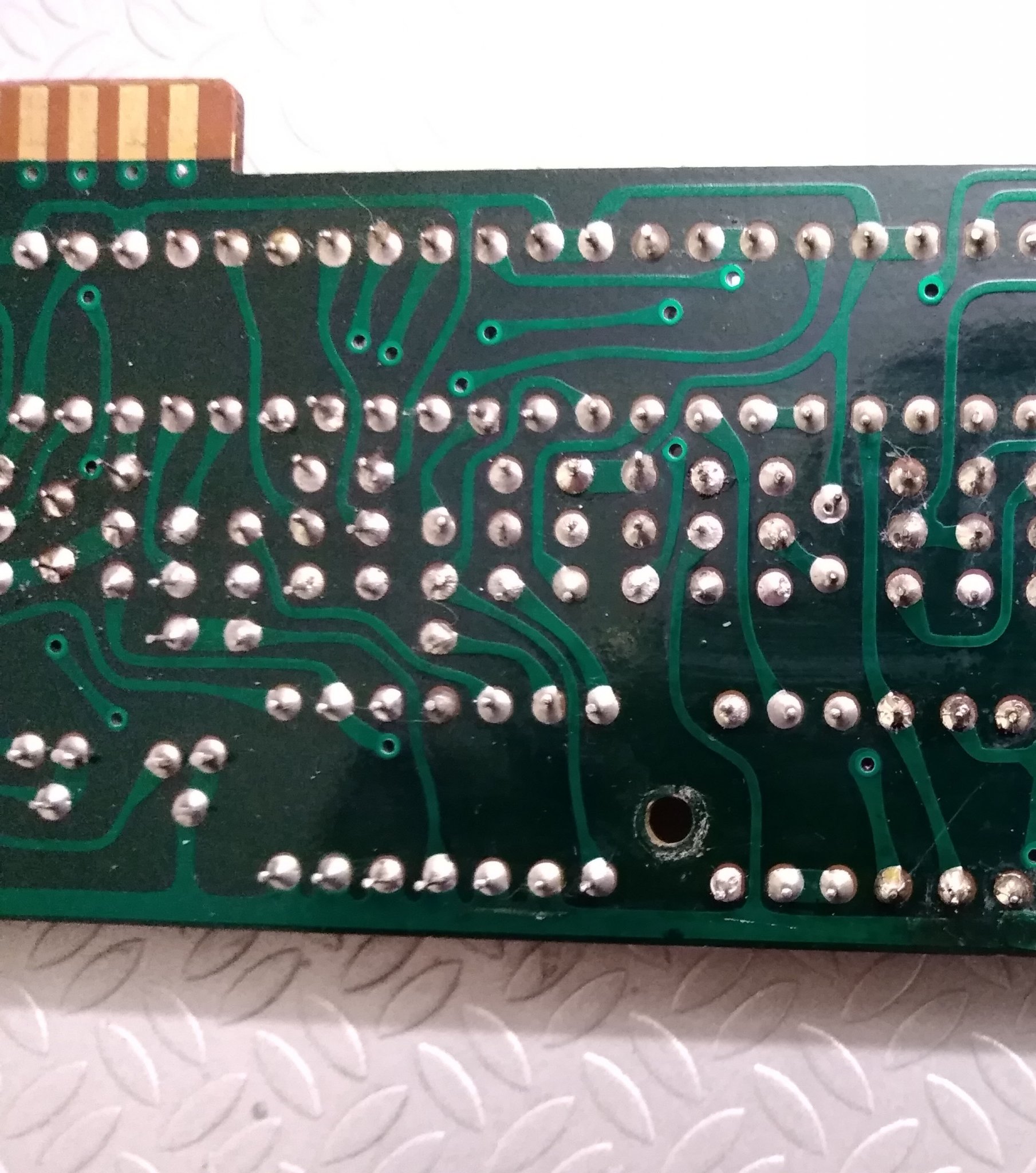

I read that several are going OT as if protecting pcb circuits was a rare procedure or coming from Mars; in the past, on the other hand, it was normal to coat the PCBs on the side of the welds with a coating which, in the event of replacement of faulty components, allowed the new components to be soldered onto the pads without removing the coating.
There are countless examples that I can show, in these photos you can see the semi-gloss coating applied by the manufacturer.
Photo 1 Technics
Photo 2 Victor Jvc
Photo 3 Denon
Photo 1 Technics
Photo 2 Victor Jvc
Photo 3 Denon

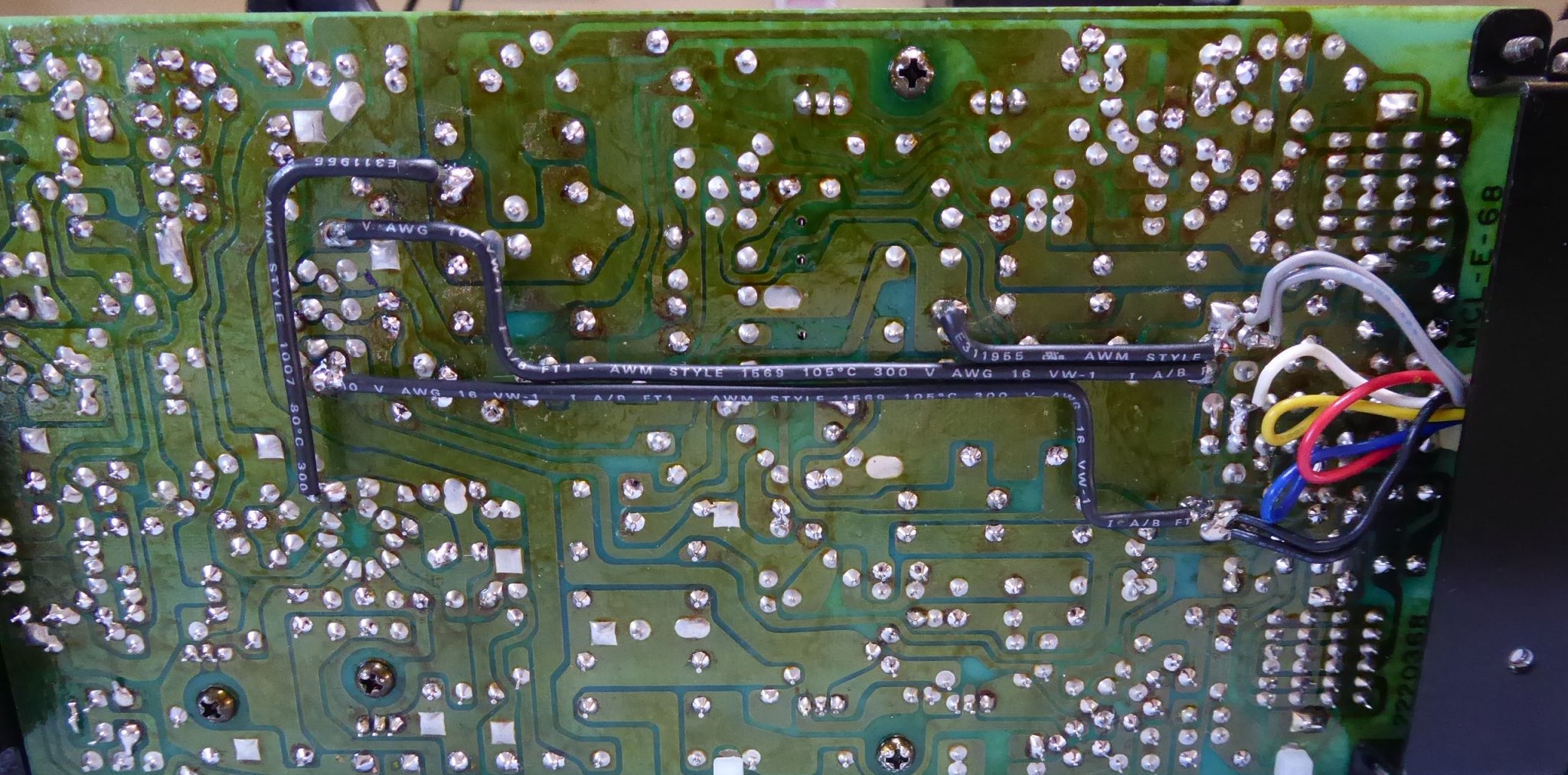

Pitrus,
You are showing solder masking. This is done with a silkscreen that prints a solder mask to the circuit card. That way when wave soldering you do not get shorts. That is different than a conformal coating that is applied after soldering to protect the entire circuit card from corrosion.
I suspect just a language issue.

I am not referring and I not would not confuse minds with the copper coating which is the "solder resist" of which I hope we are all aware of how it is called in technical terms but I am referring to the further transparent varnish applied as a final protective transparent by the manufacturer
I hope that the photos are more explanatory than many words, more than this I don't know what to do.

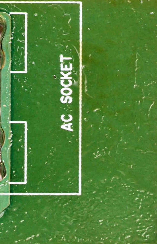

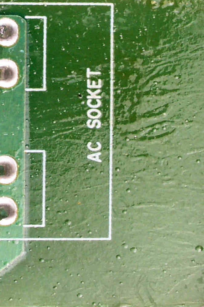

See the photos
Clear coating from the manufacturer before cleaning
Transparent coating removed after cleaning with appropriate solvents
Transparent coating removed after cleaning pcb with appropriate solvents
