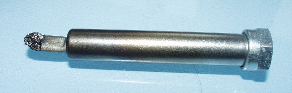

another solution for small PCB`s
Below You can see a tin brush for a Weller (Cooper Tools) soldering station.
It is mounted instead of the solder tip.
This works to some extend for smaller PCB`s but the tin does not get so evenly distributed and does not look as good as a professional tinned PCB.
