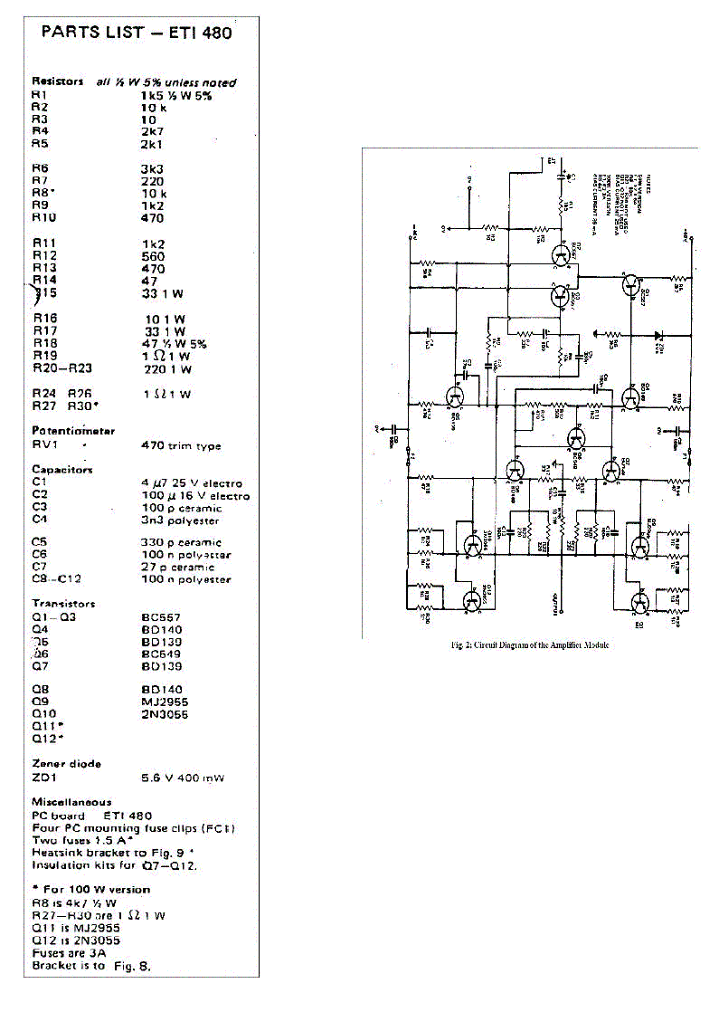

Hi, I'm Steve and I am from Romania.
I started building a module of the ETI480 from scratch, no such thing as a kit for the ETI480 here in Romania, and I encountered a little problem: I downloaded everything there was to know from Paul Cambie's site (re: ETI480, schematics etc.) and I found a mismatch on some resistor values between the pages of the same author
If you will be so kind to look at Fig. 14, ETI Parts List, in my attached file, you will see that R4 is 2K7 and R5 is 2K1, but in the circuit diagram, found on first page, we can all see that R4 is 5K6 and R5 is 2K7 😕 Am I seeing wrong, somebody please tell me...
I am also wanting to use MJ15003 and MJ15004 for the output stage and BD237 and BD238.
Has anywone used them and what are your remarks on the difference between them and the 2N3055/2N2955, BD139/BD140.
Please excuse my english if made any mistakes.
Thanks, Steve

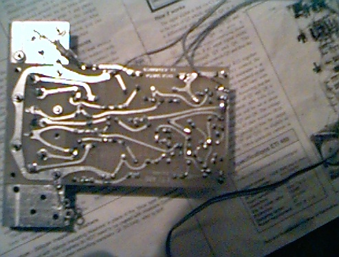

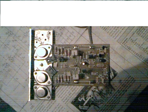

I have used these amps. I have 3 of them (tweeked)here and they are very good they and can be tweeked to 200-220w by changing the out put to 2x mj15003 and mj15004 the bd139 and bd140 to mje340 and mje350 ,r6 on the zener from 3.3k to 4.7k and change the r15 and r16 between the drive transistors from 33ohm 1w to 33ohm 5w and use 50v rails the resistors on the output transistors get hot to but I havnt changed them I have pcb pics (not layouts on comp) schematics and pics of amp if you need them just email me .I used 2 p2 comp heatsinks to keep it cool to workes very good .If my freinds cant kill it it cant be killed .it runs on full all day every day
r4 is 5.6k and r5 is 2.7k in the 100w version and on last post you can go to 6.2k on r6 to use 60v rails but not 1v more I think it was around 250-260w and a **** load of heat
