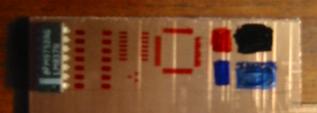

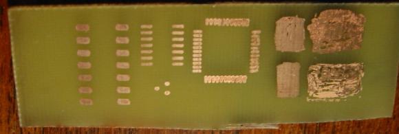

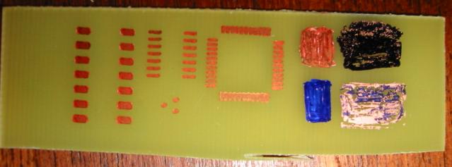

I used penplotters to created 1:1 art for positive photoresist boards. If I stacked two copies it was dense enough... same as using inkjet printers.
An intriguing possibility is to put a focused UV LED in the penholder and photoplot directly onto a sensitized board.
