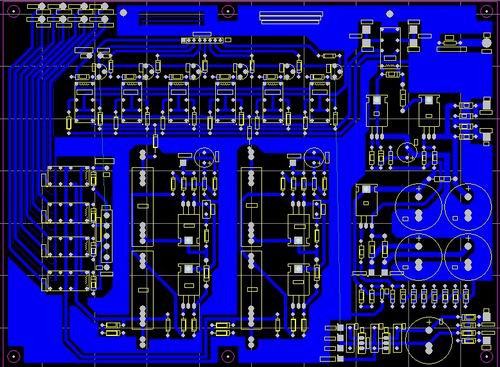

Here is an simple example, where you can see that first the components was placed carefully, and later on the traces was routed.

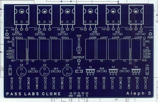

hi,
i tried to design some boards with the IVEX, and i found out that it is not easy at all.
infact it is very problematic and risky, at least to me.
then i saw the layouts from the PCB-DESIGN (http://web.vip.hr/pcb-design.vip) , unbeliveable... i never saw something like that before, not only that the layouts are well done, but they are also very simetric, infact they are simetric, even if the circuit diagram is far from that.
i talked to PCB-DESIGN and ask what software they used for designing the Aleph boards. the answer was PROTEL and TANGO, the all boards are SINGLE SIDED and that there is not used any help from autoruter !!!
now i see the mpopovics work, very good, and again it is done with the PROTEL, and also without autorute.
how that it is possible ?
am i missing something or ...
