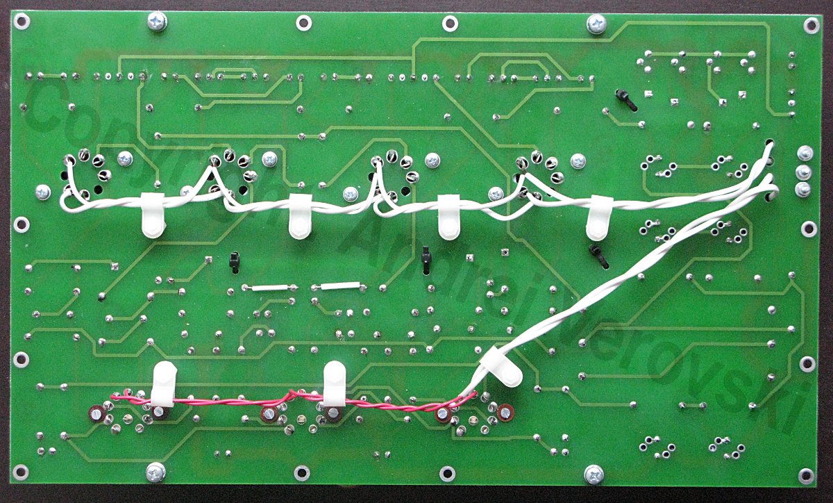

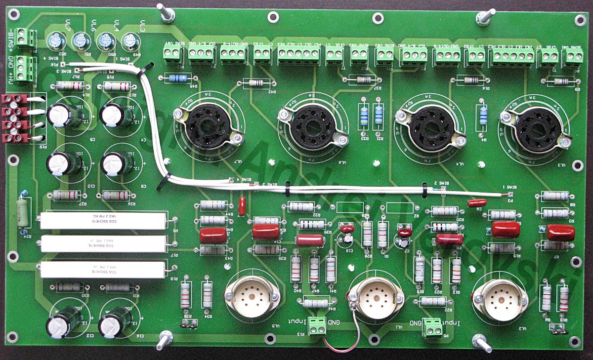

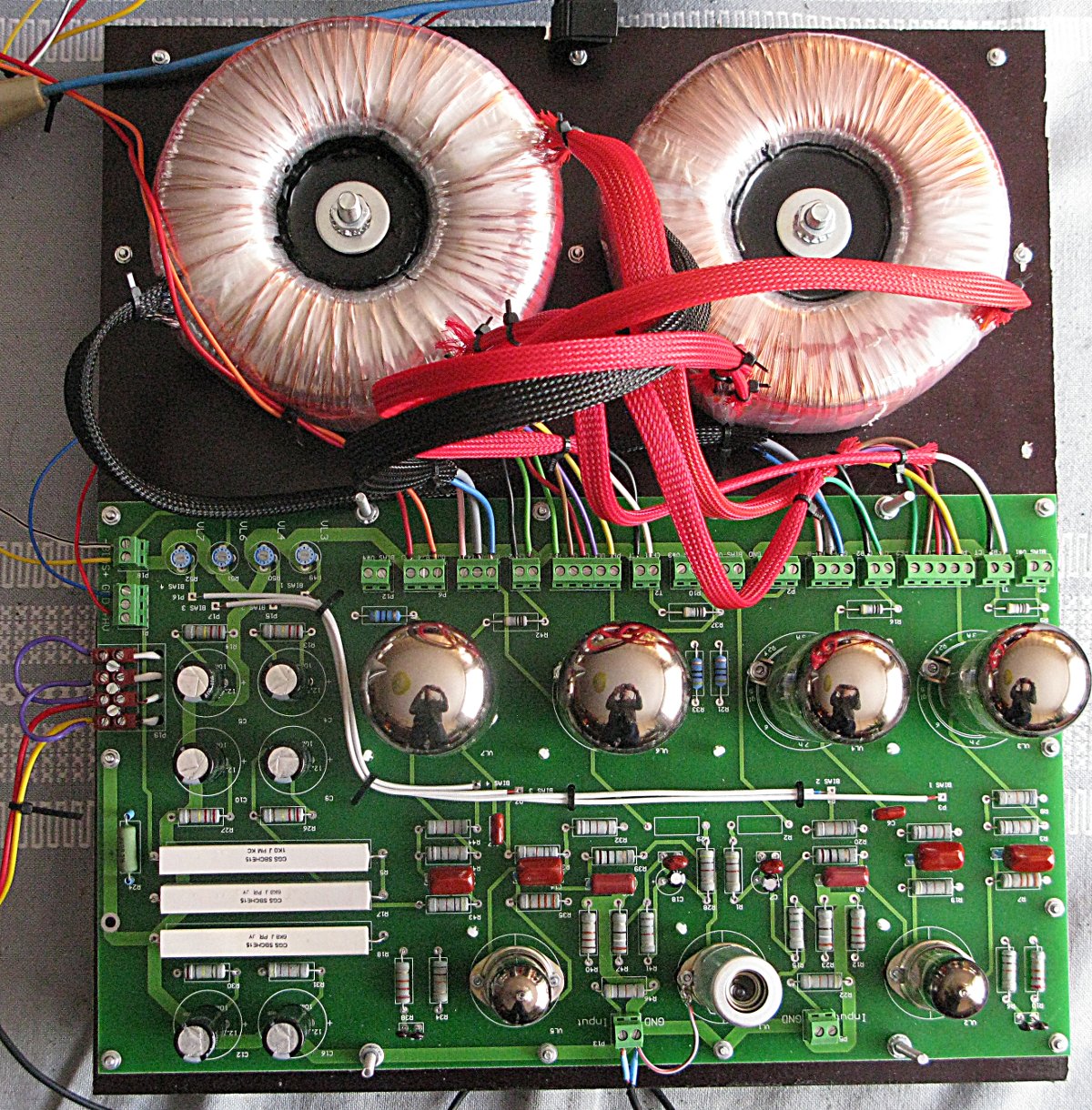

1) I would suggest making ground plane taking less space to avoid extra parasitic capacitance between PCB top and bottom layers.
2) You will need standoffs to keep long heater wiring in place.
3) BIAS wiring can be made with ordinary wires to avoid long tracks with unnecessary complex routing on PCB.
Photos of PCB and assembled prototype on test bench attached.

Make more mounting holes on the edge, like on my previous post picts, and there will be no flex problem. PCB needs to be 2mm thickness of course.
