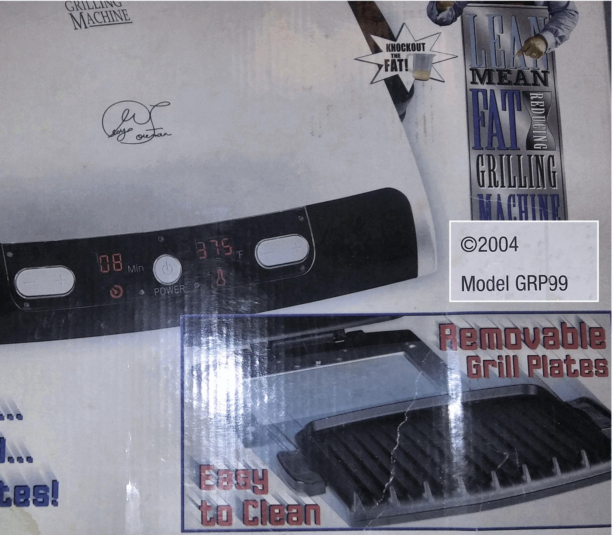

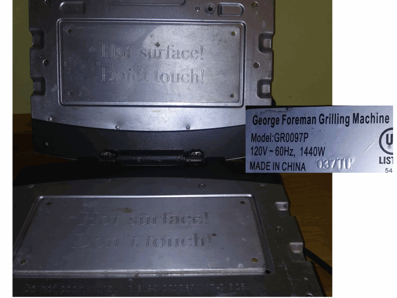

The George Grill has ridges to make sear-marks on meat. Soft meat will wrap the ridges and absorb significant energy.
Your "to" Aluminum plates are hard and flat. They only take heat on the tips of the ridges, not all along the ridges, with a lot of air in the grooves between the ridges.
Take the ridged plates off. However it looks like your model does not have removable plates. We just went through this trauma (for food not PCBs)--- "George" comes in many variations each lacking some key feature (no timer, no shutoff, no temperature, can't really clean...). The two models attached do strip down to flat heating plates.
