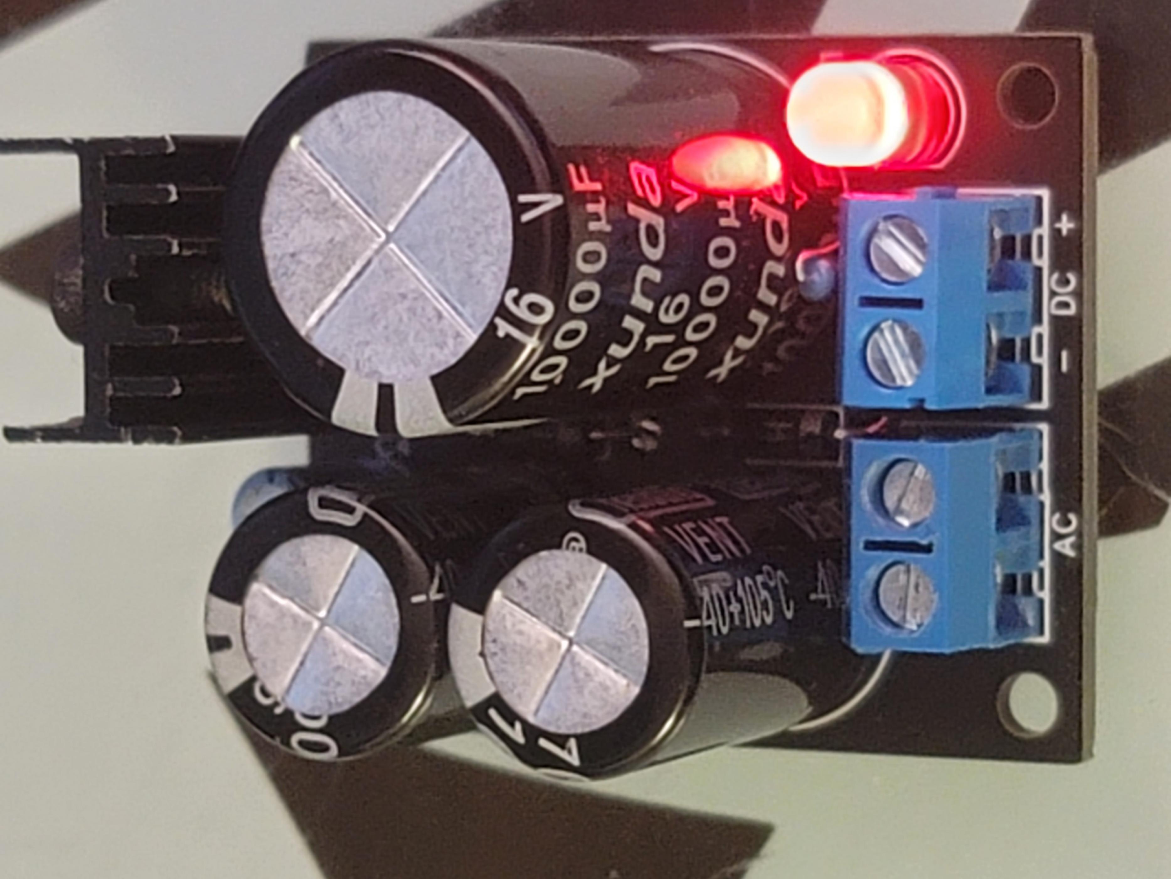

PCB for making 12V control voltage from 6.3V heater winding.
I made a board for a project and ordered a bunch of them.
It takes 6.3V from the heater windings and makes 12V for controlling a relay etc using a Delon doubler and a 12V regulator such as MC29300 or LM7812. I use it with a dual winding 6.3V transformer using one winding for DC control, and the other for the 6.3V the biasing board requires.
If anyone wants any I'll offer them for 2$ each plus mail.

Yes, it would work for that too! Since the current limit is about 1A with a 29300 (not much room for heatsink) I figure that's for a pair of 6SL7 or something?
I used SB1100 and an MC29300 myself since I had them... The larger the drop in the diodes, the less work the regulator does, right? It's only there since I read 18.9V with no load :)

Well, I did design this to run a relay module from a heater winding :) 18.9V (unloaded, pre-regulator) would blow it up.

Thank you for mentioning the MIC29300. Some quick computations suggest that Schottky Diode voltage doubling 5 VAC yields enough headroom for the 12 V. version of that low dropout (LDO) part to function reliably.
Does the MIC29300 have a negative counterpart, as is the case with 7812/7912?
I didn't find one, but the LM2990T might do the trick. LM2990T.
