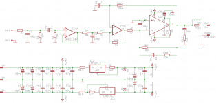

Here's a first attempt at a PCB for a lm3386 inspired by Cordell's "supergainclone". I kept the input buffer but dropped the dc-servo in favor of the simpler passive DC feedback network Cordell describes in his book. Schematic is attached, the original super gainclone can be found here.
As it is, the PCB is exactly 10x5cm. Decoupling is shown as 4.7uF X7R caps, I plan to stack 2 of these per rail. All small caps (filter, compensation) are 1206 np0. Zobel is 100V MKS4. Big electrolytics are 18mm so one could fit up to 3900uF/35V pana FC but a 1000uF/50V pana FR is probably more than fine.
Now I'll be happy to get any comment or criticism about this pcb but I've a question in particular... I'm not quite sure what to do with the ground end of the zener diodes d1-d2. Where should they connect ? Should I connect the piece of groundplane where they sit to the signal plane ?
Thanks :)

Pretty nice layout there. You're on the right track with the quiet ground (signal ground) and power ground joining an the output connector.
You could, however, improve performance a bit by flooding the power ground to use all available copper on the left side. Then flood the right side with signal ground. Join the two planes by the output ground terminal, using a top side (red) pour if you have to. The top side signal ground pour should connect to the bottom side (blue) signal ground pour with a field of vias for the lowest impedance (mainly via inductance).
You could probably scoot R10 to the left side of the input connector and shorten up the input traces if you'd want.
Pretty nice, though. I like that you've included the Zobel and Thiele networks as well as the recommended stability components. Excellent.
Tom

Thanks for the new comments, it really helps. There was a lot of confusing posts about the "optionnal" stability components; glad to read that you're going to post something about it.
As the overall layout was sound, I tidied things up a bit. It was a bit silly to have plenty of smd parts and not take fully advantage of it, so I changed most resistors to 1206. The electrolytics were also a bit excessive, they're now 5mm pitch, 13mm diam (suitable for pana fr 1000uF/35v), which allowed me to move them closer to the IC. As a consequence, the board has shrunk to 8x5cm. The negative consequence is a vertical zobel resistor.
The input network has now its own plane, with a wide connection to the signal plane at the final input filter cap.
The zeners are now fed with a pair of dn2540 ccs. The diodes return is now on the signal plane. I'll probably have to test in situ to have a definitive answer on this.
I've done some housekeeping, keeping the groundplanes away from the opamp inverting's inputs, etc.
Slowly getting there... :cool:

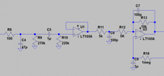

Still thinking about this one... Cordell's filter is pretty steep and absolutely requires to be driven from a low impedance. If we move part of the filter in between the input buffer and the inverting one, we gain a lot of flexibility to interface the amp with a simple 10K pot as volume control.
It'd go like this, in order:
isolated rca with 47pF caps going from ground to chassis
twisted wire
10K pot
twisted wire
input connector on the pcb
and then the following schematic:
attachment.php
C4 ground returns by its own track either simply to the input connector or to chassis ground; all the rest sits on the signal gnd plane. It's not perfect but with a jfet input opamp, it should work out ok in practice.

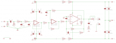

I've left the project aside for a while... and managed to somehow delete the eagle files. :cuss:
So, back to the drawing board. Here's a new version. It includes pretty much the same things as the one discussed earlier.
The new things:
- provision for up to 4*4.7µF x7r caps near the amplifier.
- more convenient locations for the connectors, use of faston connectors.
- down in size to 6x6.5cm (2.36"x2.56").
- input connector is molex kk (or the cheaper psk stuff from reichelt).
- the nc pins are removed, to clean up the layout.
And now the for the thousand bucks question: where to link the signal ground to the power ground ? The previous design had the link at the output ground connector, which made sense as it was close to the decoupling caps.
Now that the connector has taken a big trip downwards, should I still go join the groundplanes there ? Or should I rather create a bridge near the lm3886, under the feedback resistors crossing the divide ?
Thx for any :2c: thrown in. :)
