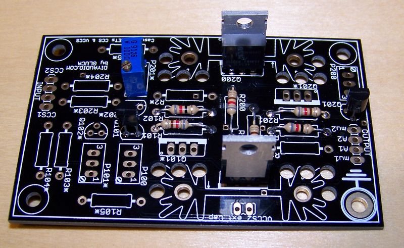

One of my pcb's partially populated.
It has been earmarked to replace two chokes. I can't place the chokes far enough from the power transformer to prevent hum. So I'm going to try this in my DAC. 6N6P at around 14,5mA per side. So I used the IXYS 100d top spot and dn2540n3 in bottom spot. Not sure if I'll need heatsinks.
Also a question I have. Should the external cap pads be jumpered with a wire if just using it as a CCS?
Hi Ale
Post a couple of pics please
Yes. Use a jumper for ccs. External cap and all the other required parts for voltage controlled ccs.

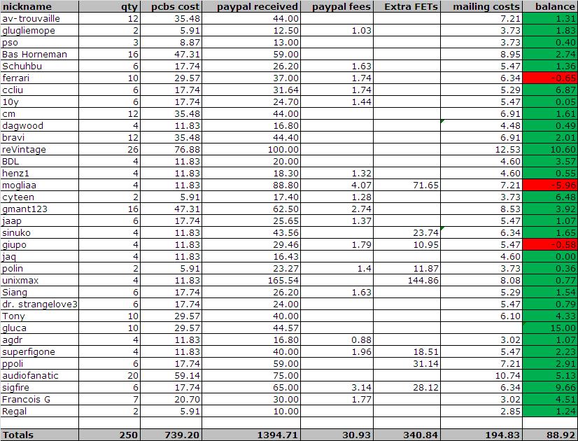

here it is the final balance, apparently i miscalculated your total mogliaa in my old PM. the remaining money will be donated to save the children as said (25$ out of the 88$ actually were donated a while ago)
I will send the remaining balance through Paypal
