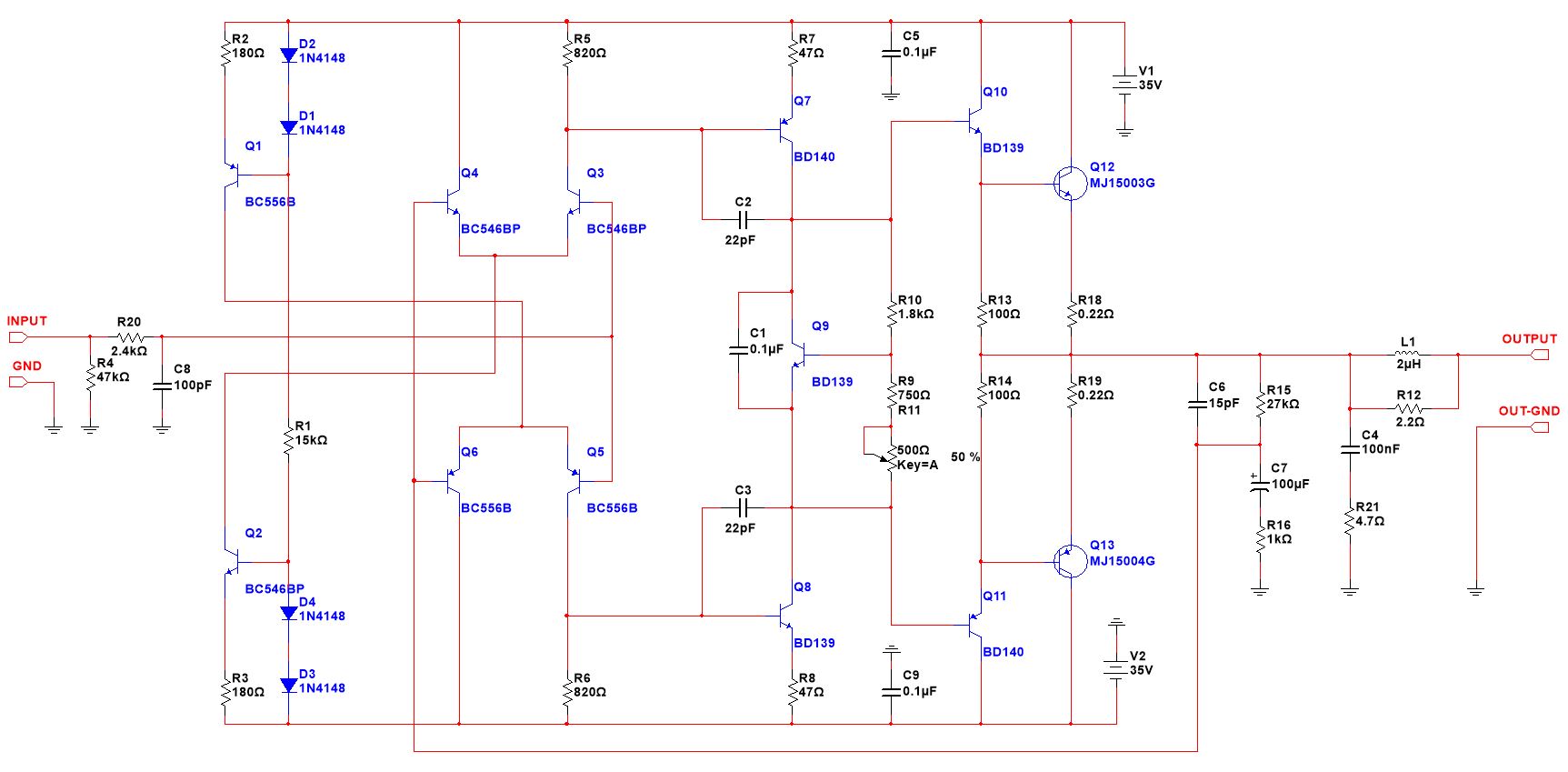

PCB for audio ammplifier with mj15003/mj15004
I need a PCB-layoot an button for the audio amplifier given to schematic.
thank you!

May I ask a question? 🙂
The schematic will work in principle, however it has got some flaws, related to DC offset, stability/compensation, bias trimming, as well as some strange values (non-standard input resistance, non-standard voltage gain = 10, etc.).
The question is - why do you want to build this particular design? 😕
Is it some "homework"? Did you design it yourself? Or it is introduced by somebody? Do you need some recommendations? Or you would rather say "Shut up, just make a PCB for me"? 🙂
Designing a PCB will take 15-20 minutes, but I will better leave it to Mihkus. Just don't want to crash the market 😀
Though I could help with some improvements, making it a practically usable circuit...
BR,
Valery

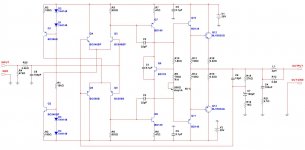

OK, here is the schematic - I tried to keep the changes at minimum.
Input impedance is roughly set to 47k, input filter is added. R13-C4, R14-C3 (original schematic) are removed - they slow down VAS too much, which is compensated enough with C1, C2 (lower values to preserve the bandwidth and keep THD at the higher end low enough). Vbe trimmer - is more secure to keep it between the base and emitter - if it loses the contact, the quiescent current will drop (and save your output transistors). Zobel network - more efficient with RL in place. Global NFB is corrected for 29db standard gain, compensation and DC decoupling.
Working design, but nothing special. I would actually recommend to build some well-designed and tested amp - something developed by ostripper, apexaudio, VSSA versions, etc - there is a bunch of them here.
However, if you like to experiment with the schematic of your choice - go ahead, also a good thing to do 🙂 Keep us posted 😉
