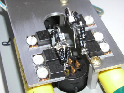

I would think twice before using PCB for Aleph P1.7. Comparing circuit that simple on PCB and done point to point is probably like comparing IC to a discreet circuit. It doesn't take much to do it p2p, and by saving money on PCB, you could buy better capacitors.😉 It's not complete yet, but another 4 resistors and that's it.
