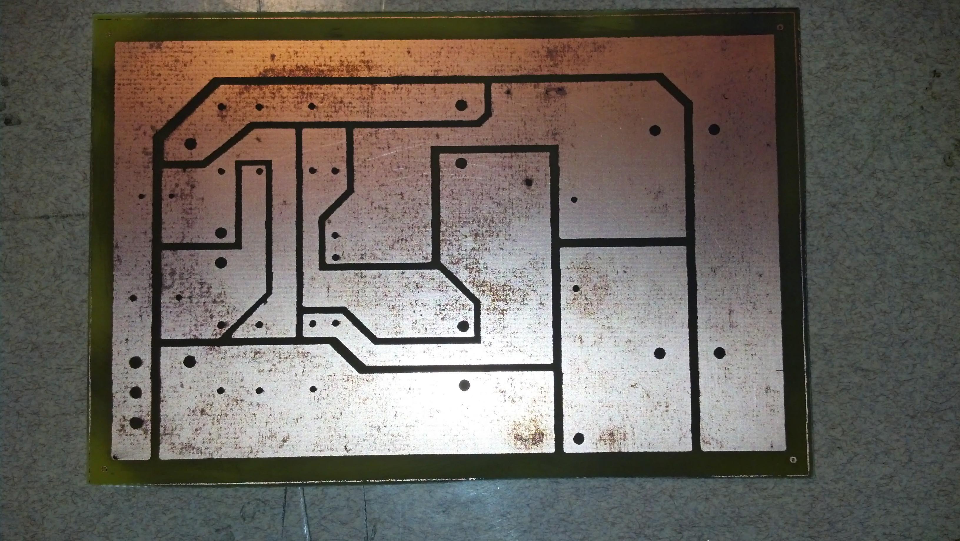

I etched my first board and have a question. I'm not sure what the discoloration is. I guess it's toner. I've scrubbed the heck out of it, (carefully), and can't seem to get rid of it. Do you think it's toner or something else? Thanks.

Looks like you used a toner transfer process. The discoloration is caused by the etchant seeping through the toner. It's eaten a bit of the copper. That's pretty common with toner transfer, actually.
What you can do is to coat the board with tin. MG Chemicals' Liquid Tin is what I use. It doesn't give you the copper back, but at least it prevents the copper from oxidizing further. It also gives you a surface that's easy to solder to.
Give the board a good scrub with a ScotchBrite (or equivalent) pad before tinning it.
~Tom
Fine sandpaper or a scrubbing pad might clean that up if it hasn't etched too deep.
In my experience, the liquid tin was expensive, and not much easier to solder than corroded copper. Better to spray the board with a conformal coating or varnish.

That said, looking at your photo, you have acres of copper in there... if you scrub the PCB with a scourer and solder the bits on it will work just fine.
If on the other hand you are concerned with the aesthetics of the solder side of the PCB, then you might be best off making another board.
