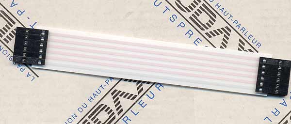

No crimp 0.100" 3M Female Connectors
having got tired of the painful and laborious hand crimping of 0.100" molex connectors, I stumbled on these do-dad's in the most recent Allied Electronics catalog -- just push the solid wire in the slot and voila:
