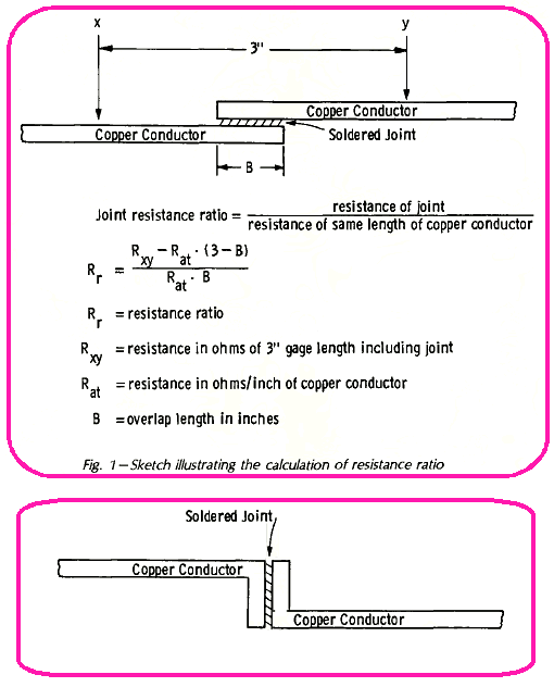

To bump up the old thread, I would like to ask your opinion on screw terminal blocks for PCB. Like this one.
I will need a good connection for 2A DC, or about 1.5A rectified DC (that means 6-7A peak pulses).
I was thinking about using this, or simple JST connectors, or faston blade types.
But I do have a question: I understand that the mechanical connection any one of these provides is good, resulting in a high contact area, low resistance joint.
What about the soldered joint to the pcb they need, though? Placing such a terminal block in a PCB (with say two 1.3mm holes and 3mm pads) and soldering it ensures a good enough joint? I feel there is little mechanical contact to the pcb pad before soldering, and the joint's resistance could be determined by the solder resistance (I might be mistaken, this is why I ask).
... ... ...the joint's resistance could be determined by the solder resistance...
Effect of Solder Thickness and Joint Overlap on the Electrical Resistance of Soldered Copper Joints
http://files.aws.org/wj/supplement/WJ_1981_10_s199.pdf
That speaks of a lap-joint but I have re-drawn it as a connector.
For "neat" joints with solder-area at least 3 times the wire area, if the wire in the circuit is 100 times the solder thickness, the *wire* resistance dominates.
In general for "small" work (do not need a loan to finance the building), it is expedient to over-size wire, connector, and solder area so none of this really gets in our way.
So this actually means that it doesn't even matter if the wire (or a terminal block's solder lug) does not make mechanical contact with the pad at all?
I realize that this is the case for single sided boards, where there is no chance of actually touching the pad together with the component's lug (unless you bend it, hardly the case with a terminal block).
EDIT: I did not understand what you mean by thickness vs solder area in your example. Solder area is the pad area + the area of the wire surrounded by solder, whereas solder thickness is the thickness of the "pyramid-shape"?
