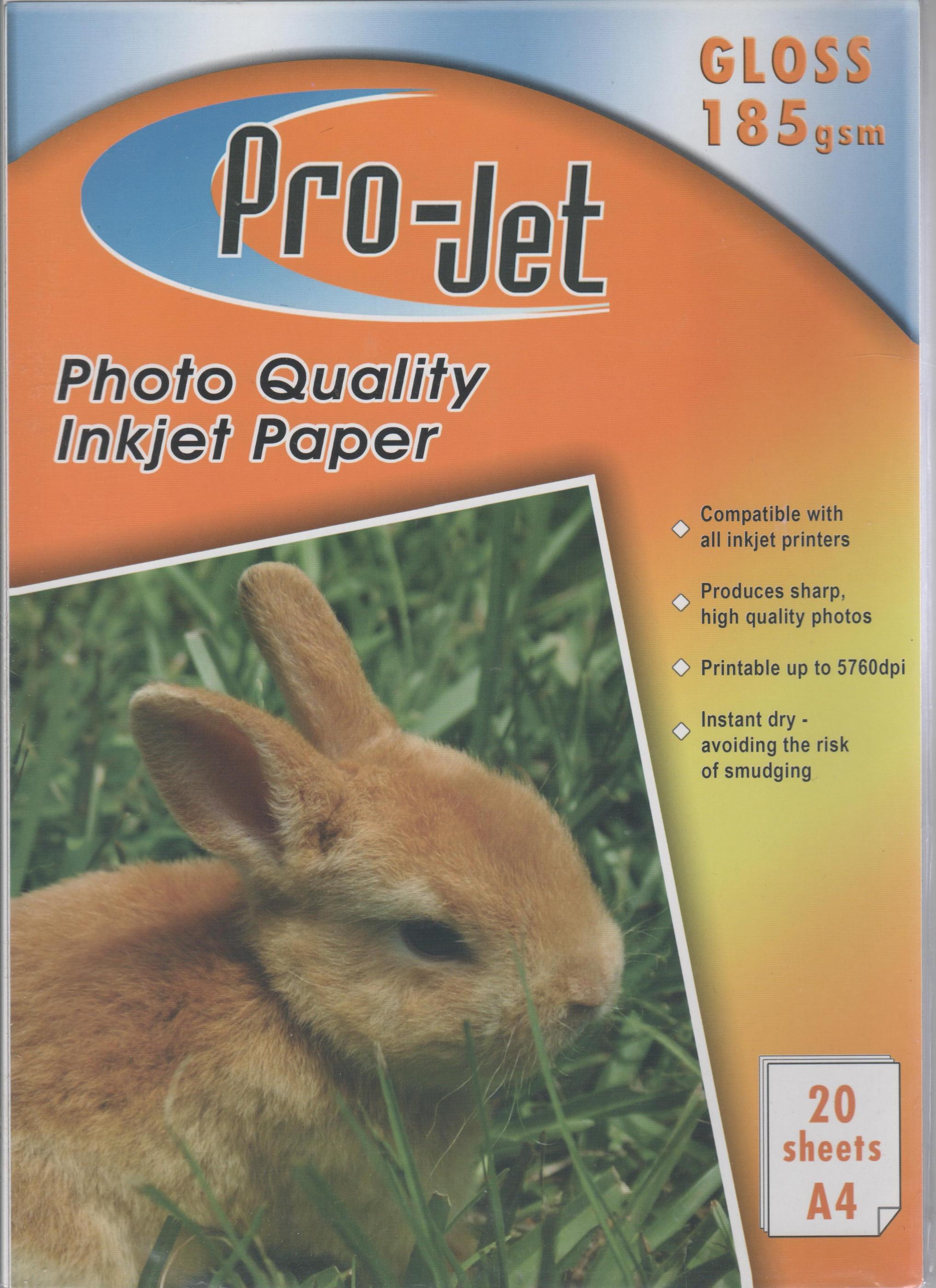

I've just bought some Pro-Jet Gloss 185Gram over E-Bay and it seems to work well.
Only problem is that it leaves a film on the PCB which has to be scrubbed off with a toothbrush before etching.
I know its INK-JET paper but it works well with the LASER for TONER TRANSFER.
Only problem is its weight - I have to coax it through my printer.
Hope this is still the same paper.....http://www.ebay.co.uk/itm/20-Sheets..._Accessories_ET&hash=item2568a3663f......This one is a bit thinner and may work better.
