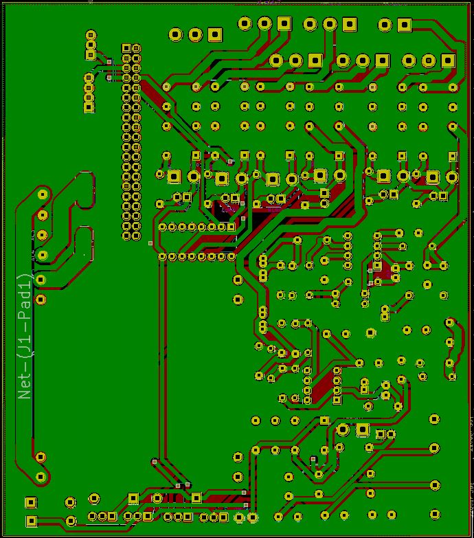

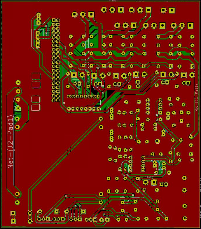

I want to make an input selector, using Raspberry Zero and phono pre-amp, both jammed on a single board. Since I am IT guy, not an electrical engineer, can you PLEASE review my PCB design and let me know is this going to make it really bad and what should I change to make it work nicely?

Here is the entire board, top side first:
...and bottom side
THANK YOU IN ADVANCE!!!!
Marin
You could fill the unused space (on both sides) with ground traces. You might also find that doing this could simplify the routing as well.
I guess I am on good track 🙂 There IS a ground "filled zone" on both sides, that I removed from pictures for better visibility. Is there any other potential problem?
Did you generate this from a (known good) schematic in the PCB layout software? It looks like some traces could be cleaned up (cosmetic), but otherwise should work if it passes all the QC checks in the layout software.
I see white lines between pads, that usually means that the software package could not route a trace there, no room. If the software has a design verification then use it to see what is not done, or needs to be corrected. I have been using DipTrace software and it has the verification checks and is an invaluable feature. It will also tell you if some traces are to close to others or to pads. Looks like you have some issues there but can't really tell exactly from the pics.
If the traces are missing try reducing trace width of traces in the area and rerun routing and see if the software can fix those areas. Often times I have had to route some areas by hand and move other traces to make room. once the layout is good you can generate the Gerbers with drill file. I see a few good PCB fab houses out there. I tend to use Seeed Studios as they do a lot with the Arduino/Raspberry Pi crowd. Good luck with it.
Thanks Pars and John, these white traces are ground traces and they are connected with a ground "filled zone" on both sides.
I am using KiCad and it has a "Design Rules Check", which performs DRC, as well as list all unconnected items. Once I add back filled ground zones all comes up clean.
Here is a PCB design with filled zones
Top side...
...and the bottom side

Hi Martin,
it's a bit hard to give good advice without the schematics, but ill try (based on some assumptions.)
- Based on the large block (Transformer?) this looks like a mains powered device.
Not advisable as a beginner.
But if you must, proper isolation / clearance between the primary and secondary side is essential. I would use a 5mm wide stripe between primary and secondary with no copper or components at all.
- Speaking of power supply, the arrangement of all related parts is suboptimal. The main filtering caps after the rectification should be much closer to the rectifier diodes and regulators.
- The way the PSU is laid out, (assuming +-12/15v rails plus +5V, all linear regulators) this will result in high heat losses, you probably want heat sinks on those.
- You really want a 4 layer board for this, a ground fill isn't going to cut it. One layer should be a continuous ground plane. The supply voltages should also be continuous planes if possible, although that's less critical.

To clarify if you use a layer as ground plane it should also have the 5mm (8mm is better) gap co-incident with the other layers - complete isolation between mains and non-mains.
And on the mains side no surface ground planes either, its far too close to the live traces. Google "creepage" and "clearance" and remember that worst-case transient spikes on the mains are measured in kV, not 100's of volts.
You'll want to watch the clearances on those mains traces too. KiCAD has a calculator built in that you can use. It's basically the Saturn PCB Toolkit.
5/8/whatever mm... Get as much distance as you can between the primary and secondary sides of the transformer as you can. And as others have pointed out, you do want to watch for creepage distance. You have some tight spots around that multi-pin connector right now.
I'd scrap the star ground and do a ground pour. You'll find you can clean up some traces if you do that.

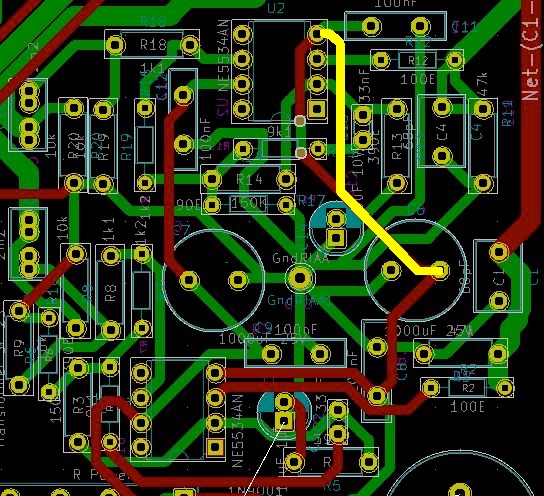

Doing this would save you a couple of vias:
The traces look very wide. Are you making this in your garage fab or will you be sending it out? If you're sending it out, I don't see any reason to go much wider than 12 mil (0.012" = 0.3 mm) on the traces. Maybe go 20 mil (0.020" = 0.5 mm) wide on the power supply traces "just because".
Tom
Tom
I didn't see any snubber diodes across the relay coils. If you are switching low-level signals make sure the relays have bifurcated contacts. E
Power supply traces should be at least 1mm I think - inductance is significant for tiny traces. If there's room for wider traces absolutely no reason not to use wider traces. With a 2 layer board those traces provide some of the heatsinking - no buried planes to spread heat...
