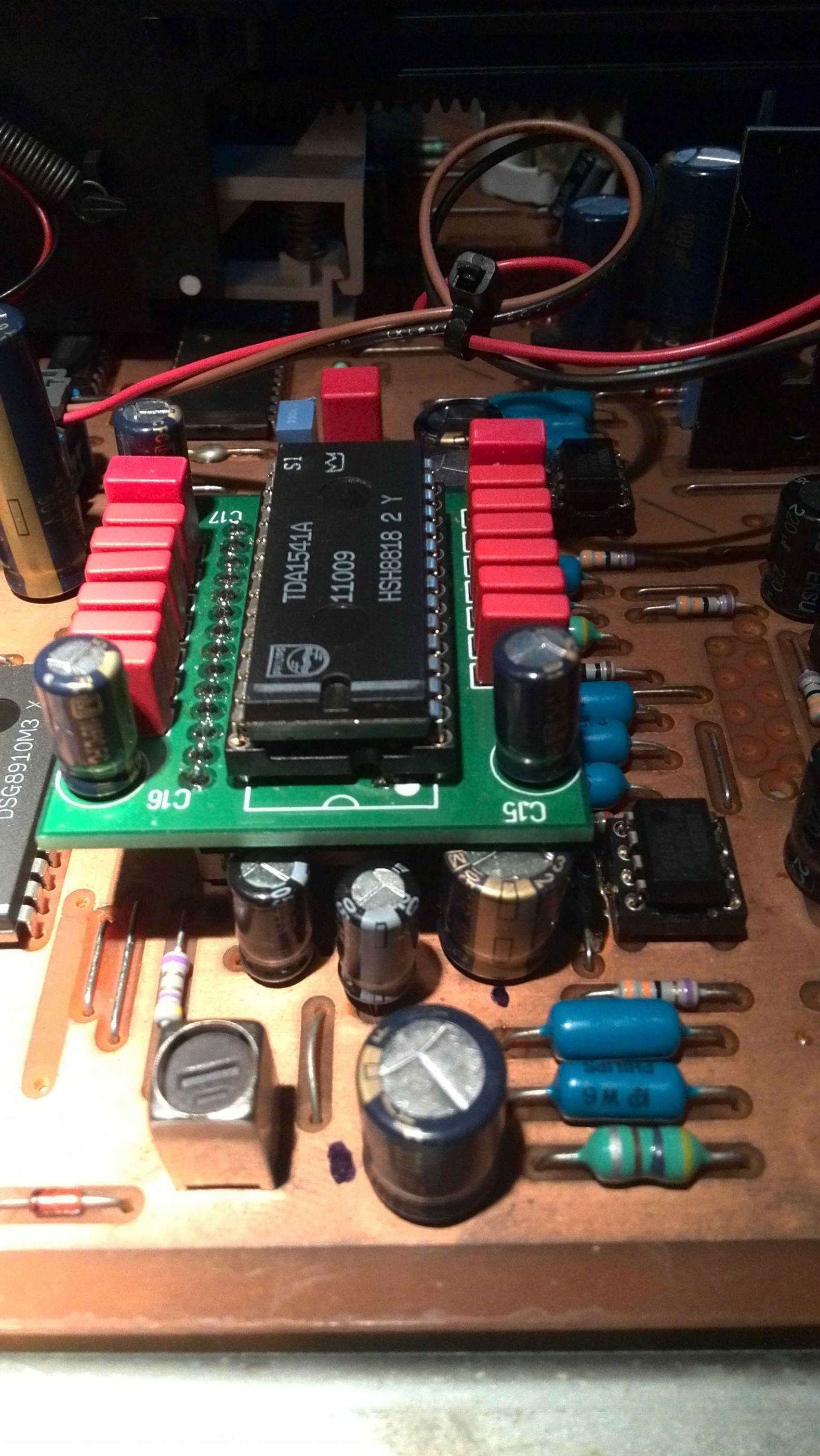

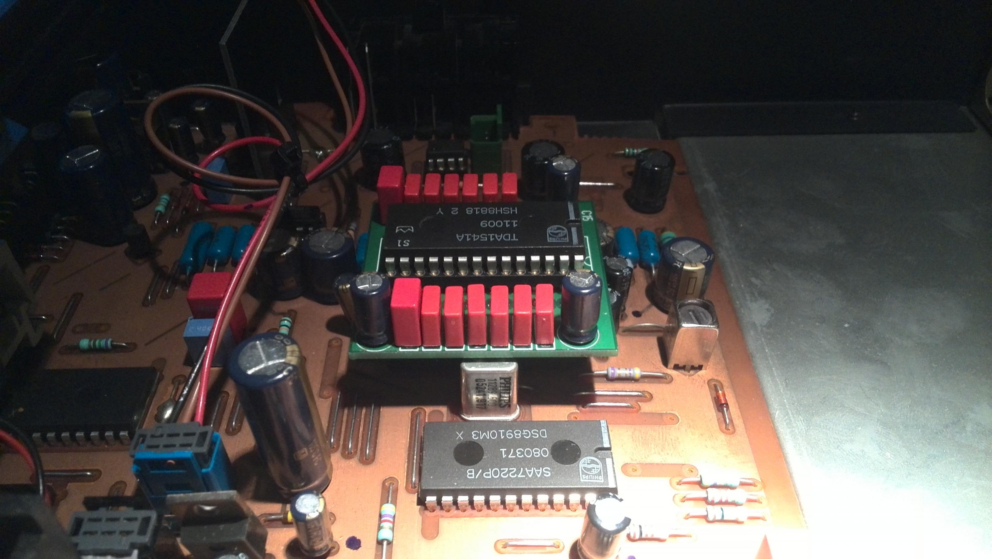

Hi all,
i want present a nice project from the last cold weekends.

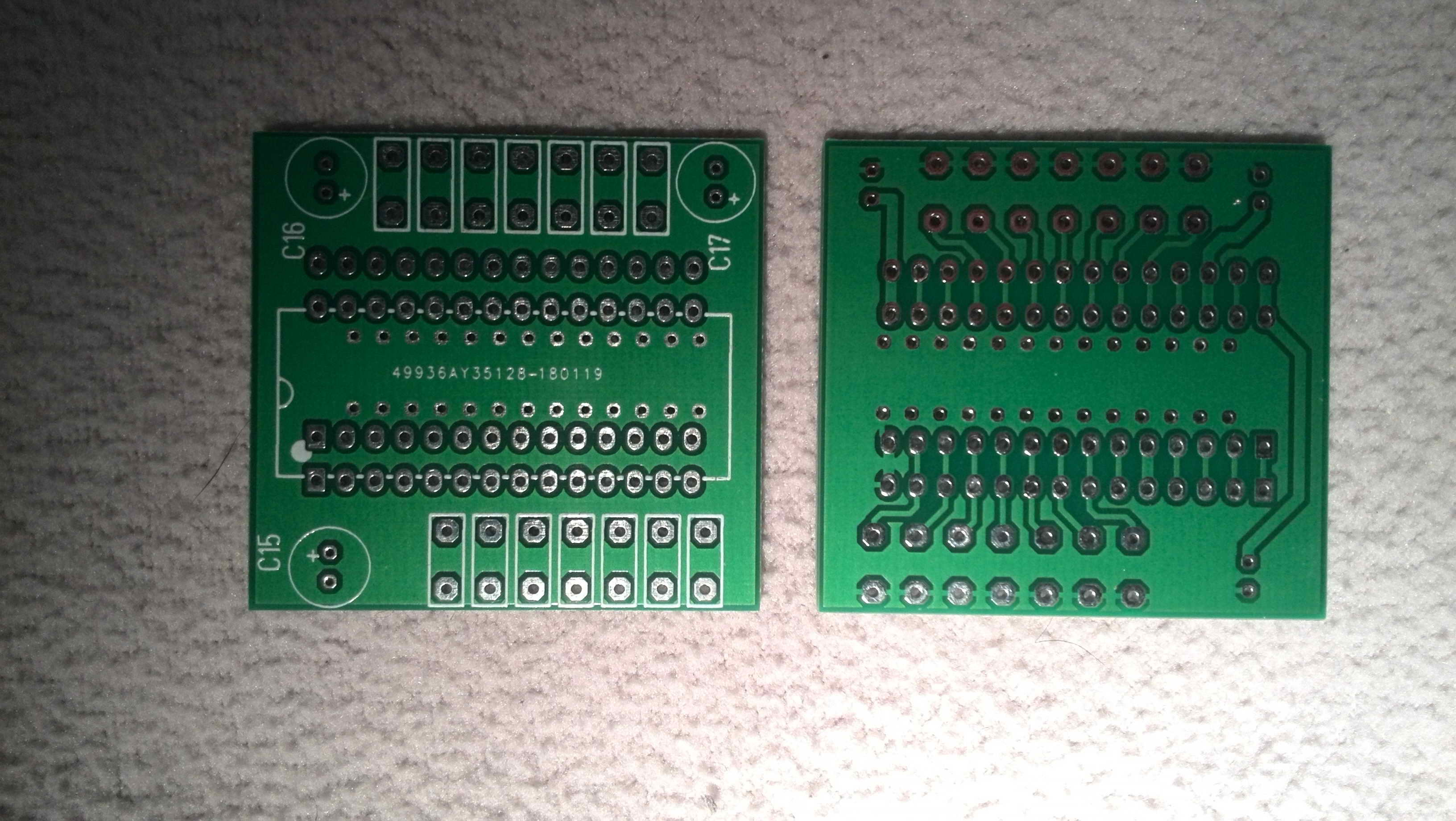

I modified my Hafler SE 150 CD-player with an adapter pcb, which contains 14 capacitors for the decoupling. Actually equipped with WIMA MKS2 220nF and also with capacitors for the 3 supply voltages. I let the 100nF SMD capacitors on the mainboard in their places, as Lampizator stated on his pages. Have a look at the attached pictures how it fits in my Hafler CD Player.
The board measures 45mm x42 mm.
BR
Günni
PS: There is a small silkscreen error. The polarity of C16 and C17 is printed wrong. Simply rotate the capacitors by 180° and all works fine
