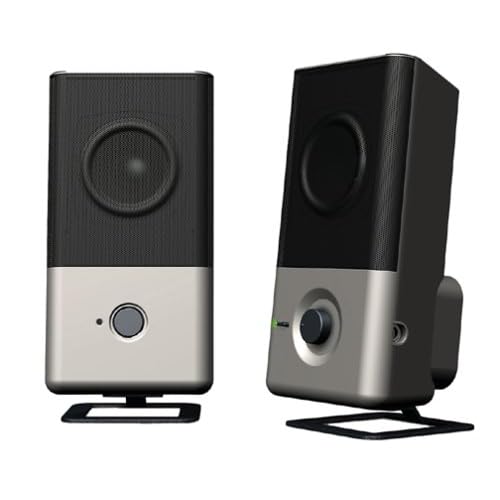

Can I ask, I find myself listening to my PC more than my HiFi at the mo.New amp is on the backburner for a while, so my attention is drawn to my cheapish PC speakers. I have a pair of Altec Lansing 220 speakers. I didn't buy the matching sub, becuase I didn't want another box and more cable. How much effort is it worth, to take these speakers and re-build a pair of cabs out of wood rather than the manufactured plastic cases they come in? Would it sound more natural in wood?
I was thinking about using the same volume and port dimensions as the original cab, and still mount the electronics in the cabs. Also one cab contains the power supply and the other the amp. Would I gain from screening the transformer? What could I use here?, and could hifi loudspeaker cable(OFC-for instance)make much difference?
I'm curious too, the port tube is mounted at the rear of the cab, so could this be improved upon, by either having it front firing, or down to the floor/up to the ceiling? Reason being, my PC speakers are wall mounted and I want to use the same brackets to mount the new cabs, and the port at the mo, sits appx 10mm in front of the wall face.

I'd simply well stuff them with BAF or similar away from area
around the port, extend the port length if there is enough
internal room and then leave well alone.
IMO the effort you describe will simply not be worth it.
Inspecting the drivers is a good idea, it may be they can be
upgraded if they are cheap and nasty to something better.
🙂/sreten.

...Yep thats them, so I'm needing complete repacement? Thought so. Better get tablesaw out then🙂
