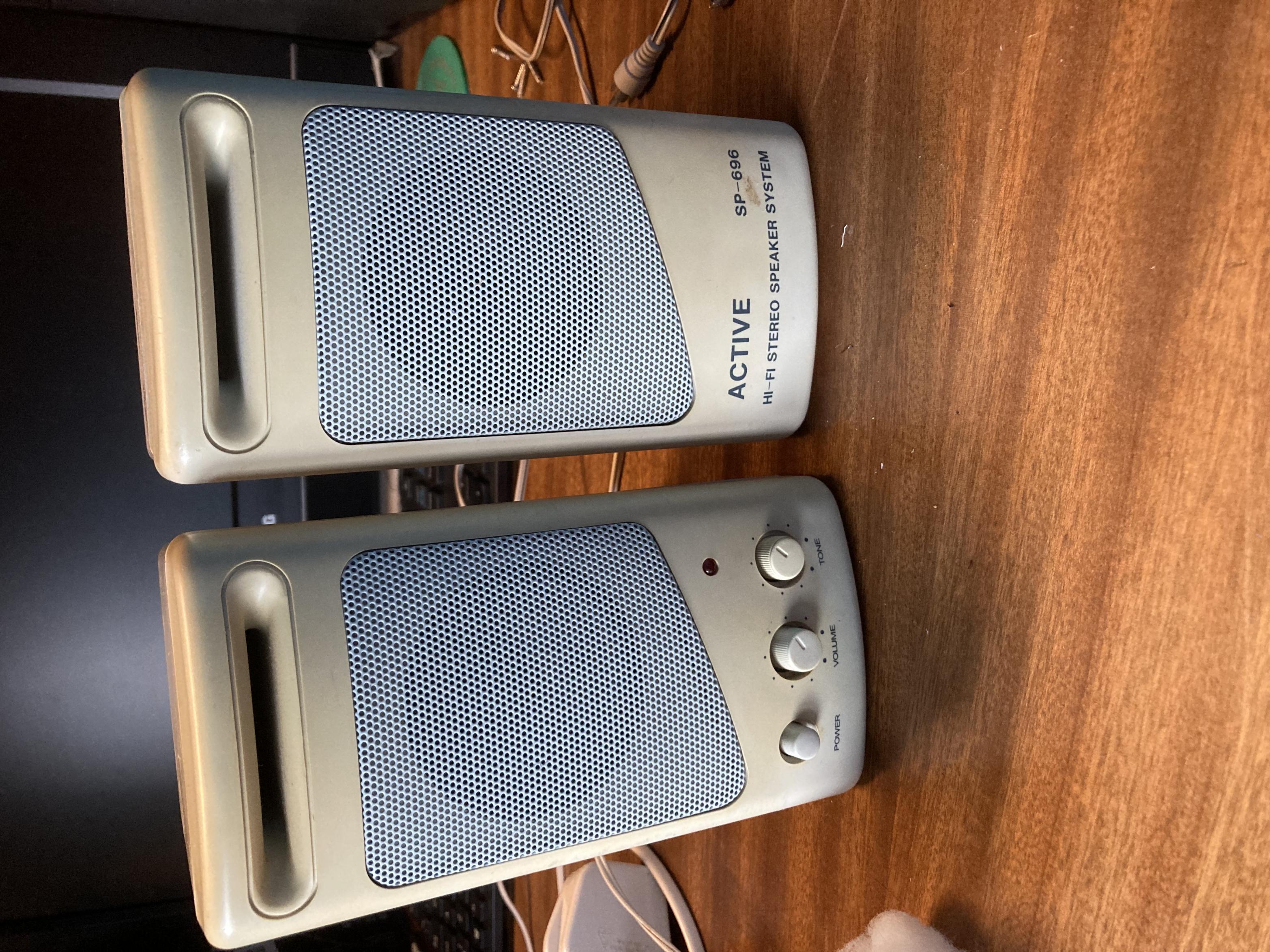

I recently came across an old pair of active pc speakers in a dark corner of a cupboard. They work fine apart from noisy control knobs which should be an easy fix. Unfortunately the speaker enclosures which used to grey are now yellowed. One option is to clean them up, but I really want to boost the sound quality if I can, by transferring everything over to some old passive hi-fi speakers which were decent quality in their day, and will look much nicer on the shelf above the pc.
Please feel free to point out the flaws in the following plan:

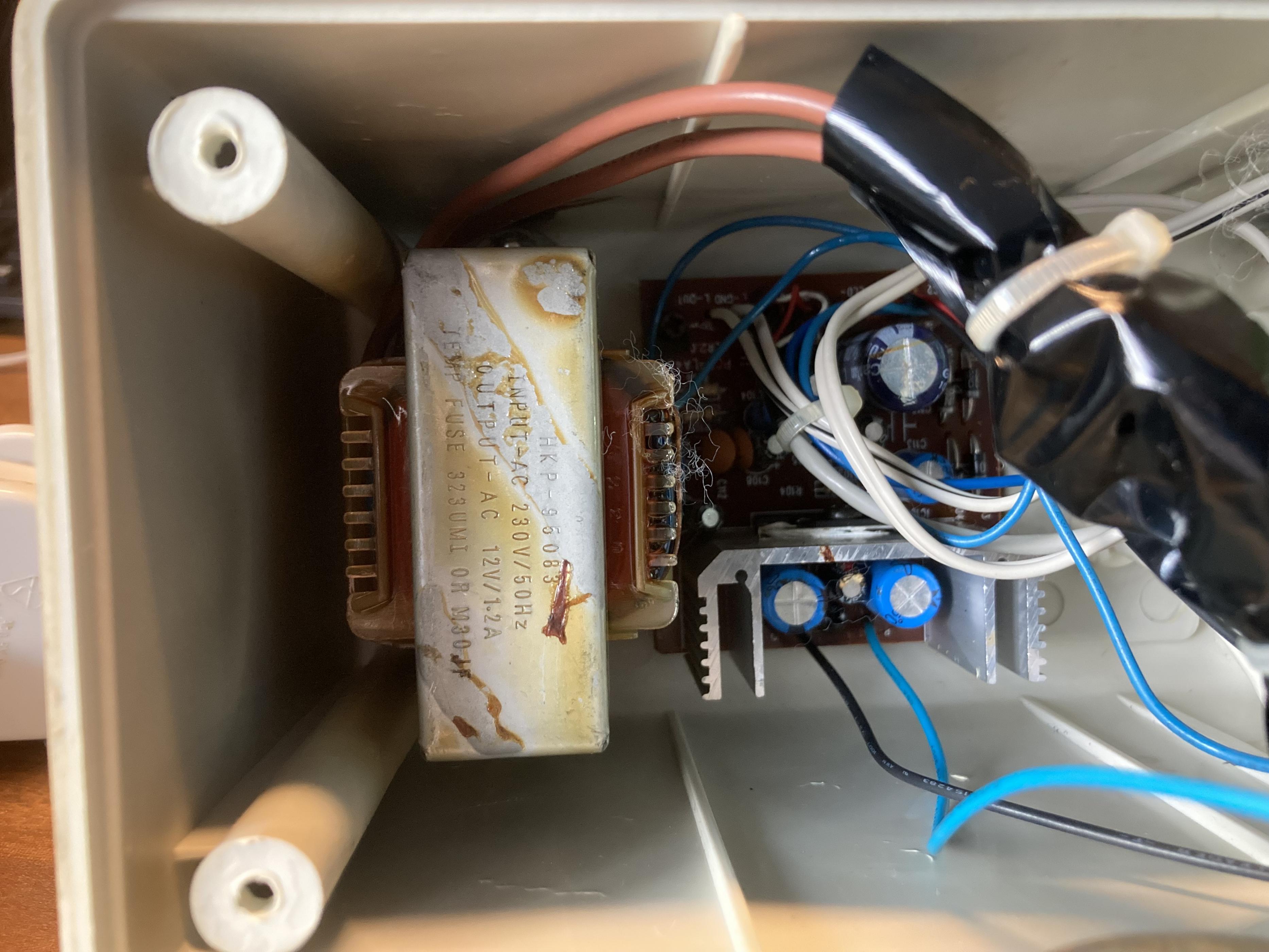

Moving the power supply and all circuitry across to the speaker cabinets is straightforward enough. I guess I need to check that the hifi speakers impedance is ok to connect up to the contacts in the circuitry. I’m making the assumption that the amp and the speakers themselves are compatible.
Anything else I should consider?

Put a bigger transformer, those tend to be flimsy, and a new power cap.
Also, switch on primary side, or direct. Some have switch on secondary, LED goes off, you think it is off but the transformer is still getting mains power.
Spray the pots, should be enough. And solder reflow on all switches and pots.
Or you could keep this in a small box, save the trouble of modifying a speaker.
Enjoy the music, should sound better than from tiny speakers.

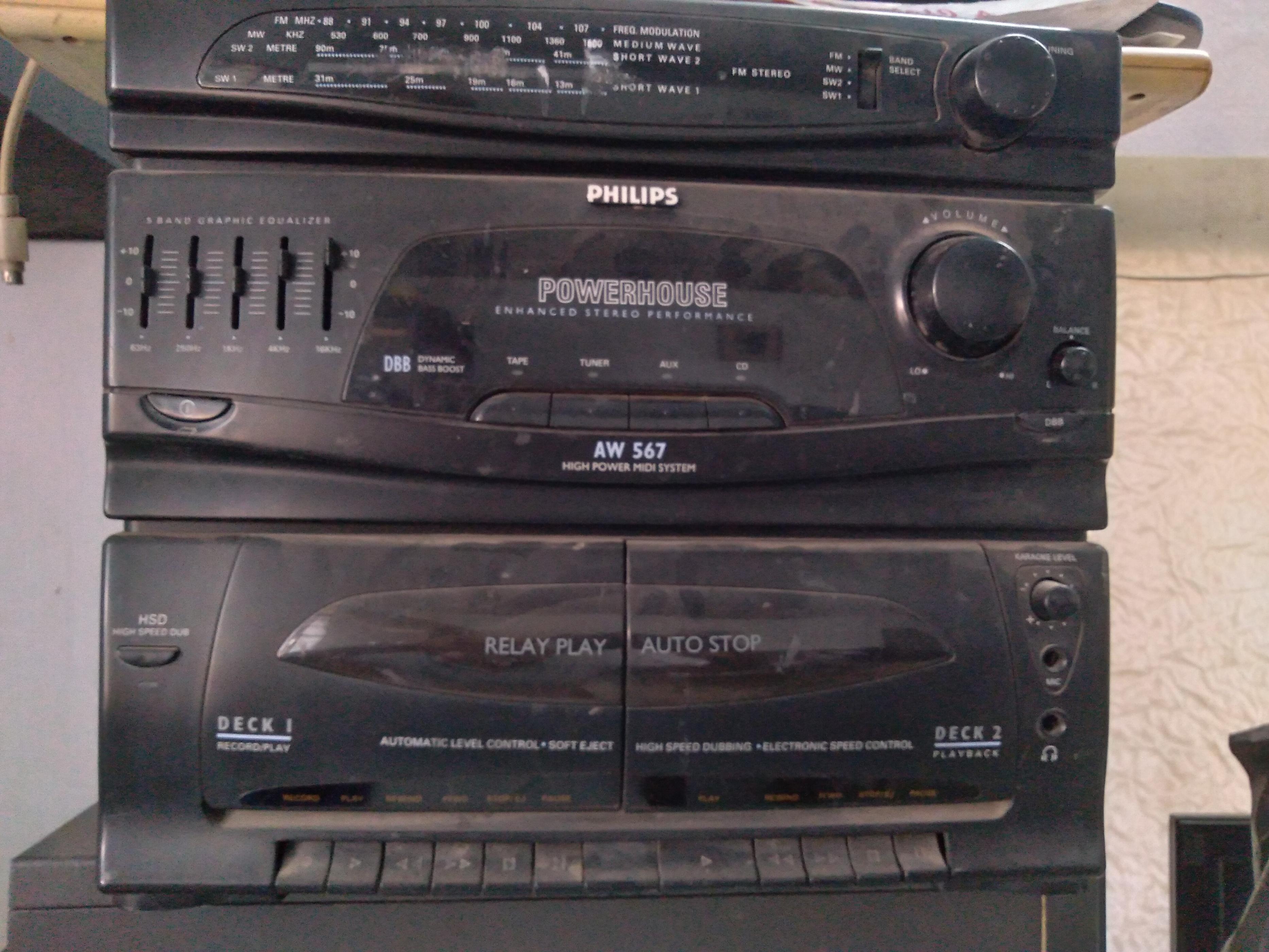

1 Quid 50 in flea market, works well.
Needed a bath, was all.
I use a 3.5 to 2 RCA, from PC.
20 Watts/ch / 8R, Matsushita chip amps inside, all other components top quality .
