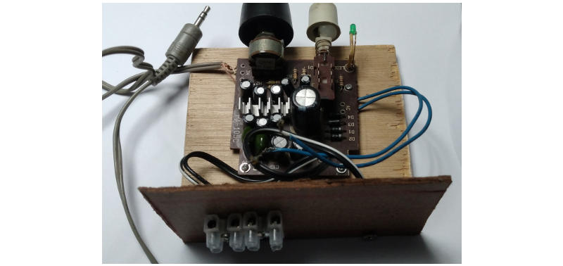

Saw your amp. Very brave to mount it on a CD. I like the way you put the power supply inside the case, but what do you think of fire hazards -
http://www.diyaudio.com/forums/chip-amps/270187-tda-1519aq.html
Update: it is possible to run the amp off a 9V DC suppy. Tested with a 9V battery and it works.
I will be installing the electronics in a larger amplifier case.
I tore apart a set of Sony computer speakers and stole the amp. The power supply was a 9 volt D.C. wall wart. I use a LM7809 regulator for a cheap way to operate the amp from my 12 volt house battery. Not the most efficient regulator but it was easy to find and use at the time..
The D.C. input to the regulator can be anywhere between 10 to 32 v.d.c. and will handle a 1 amp load with a heat sink. In most cases with small amps, the heat sink is not needed..

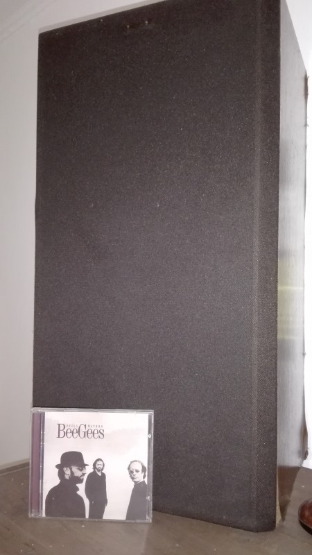

Build the box first. This phase is complete. It runs, it works, producing a clarity of sound I have never experienced before, with bass that is sufficiently solid so I do no miss its depth. With the desktop Open Baffle speakers, this is a huge success, as far as I am concerned. My car system sounds muddy, and the vintage system sounds impressive and capable but lacks the detail. Onward then...
Great with large speakers
Right now running this hooked up to large Sony ES 333 speakers. How does it sound?
It is a little short on dynamics, which is to be expected with 1.2 W per channel into large 8 Ohm speakers. The speakers are old, so the trebles are not very evident, with any amplifier. The bass is present, and adds that extra dimension to the music missing in my desktop open baffles and smaller speakers.
Where it does shine ( I am running it off a HTC Explorer phone through Bluetooth to a Bluetooth car adapter ) is in the mid range. Vocals are expressive, mire expressive than I have heard in a long time, there is no background noise and the mid range is ultra smooth. The chip is a TEA 2025B, and itself is about 10 years old, if you recall, salvaged from PC speakers that were not working.
