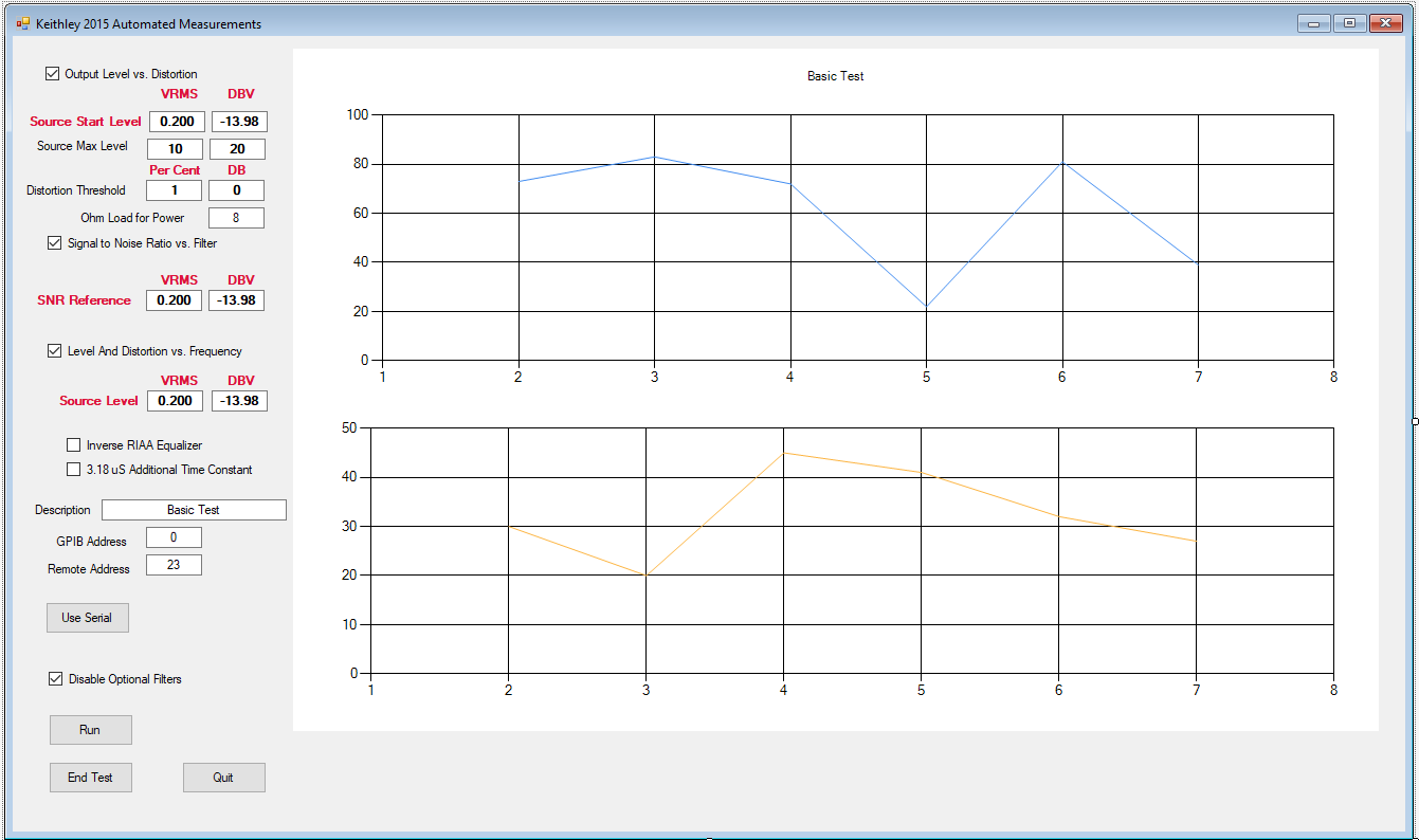

With the restructuring we managed to port the setup over to run the Keithley 2015 pretty quickly. I have a handful of other instruments on the project list and hope to get them done soon.

The Keithley 2015 code is here: Releases * 1audio/Keithley-Windows-10 * GitHub The Keiithley supports both GPIB and USB (you don't need the GPIB overhead, but GPIB is faster)

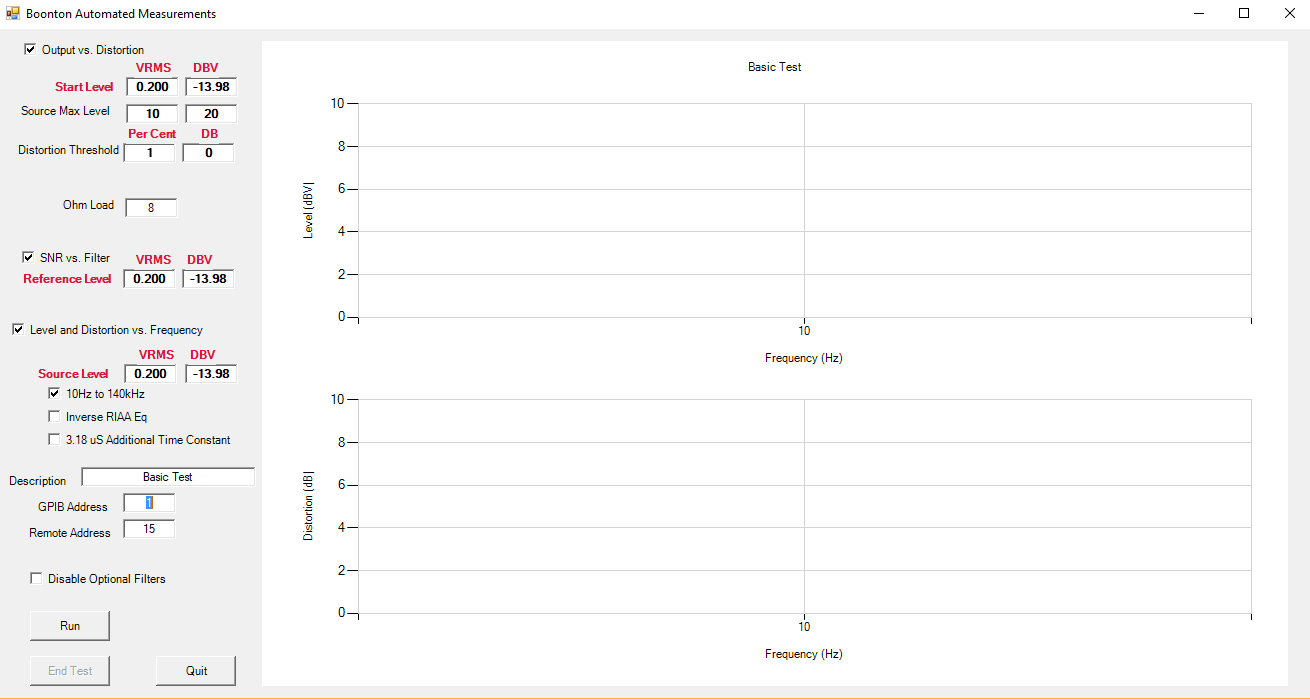

Boonton Screenshot
This is a screenshot of the Boonton in process. Its pretty self explanatory.
