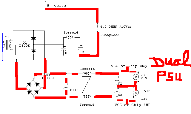

but thats only + -12V.
the amp will only purr at such low volts.
The resistance needs a heatsink?

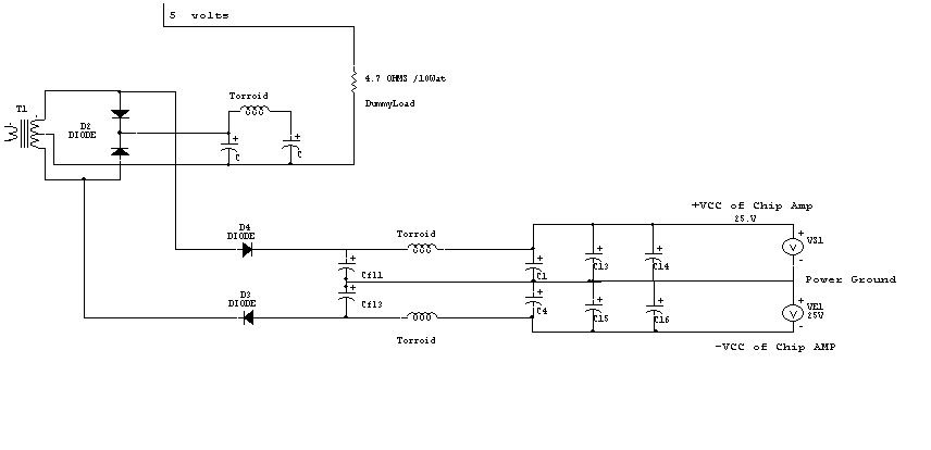

Can you please tell the component values and how come voltage gets to +- 25V?
What is this T1 etc etc,are they in the SMPS or these are the modifications to be done?
Torroids are to be rewound?
If u have tried this out, can u post the pics too?

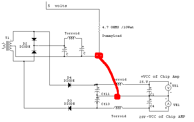

Sagar-
+/-12V is already available from the SMPS, however the -12V is only about an amp, or so. To get the full -12V current,
you will need to swap out the two small 1amp diodes on the -12V line for a couple of heavier-duty ultrafast or schottky diodes, rated at, say 8A, 200V. Or, you could go with a common-anode double diode, like those found in most car amps. This would enable you to use the full -12V and get you the +/- bipolar supply you need.
BTW, the last schematic shown will only generate +/-12V, not +/-24-25V, because it's center-tap reference is still halfway across the secondary.

Yes, anything involved in the voltage feedback and over-voltage sensinf will need to be re-done to work with 12-13.8V (or whatever voltage you end up choosing). The TL494 PWM controller chip ( I assume that is the chip in your supply) does not use the +5V to run, it runs off an auxiliary diode tapping the 12V winding, so getting rid of the 5V windings will not affect operation of the PWM chip.
Disassembling the main transformer is, by far, the trickiest part, but it will solve alot of your problrems. To start, you should either bake the xfmr at 350F-400F for about 30-45min. This should cause the lacquer finish to release the core halves. Let the xfmr cool, and begin the disassembly process by removing the windings one at a time, counting the number of turns for each.
You may notice the half of the primary is wound outside the secondaries, and the other half is wound inside the secondaries. This 'surrounding' of the secondaries by the primary ensures good coupling between the primary and secondaries.
Now that the main xfmr is ready to be reinserted on the main board, find the components that sense the +5V section and re-adjust their value(s) as previously mentioned. As for the -12V section, try the common-anode double-diode. If there's not enough space on the pc board for this, you will need to rig something up. I have used the space for the old +5V rectifier for the new +12V section, and the space for the old +12V rectifier for thew new -12V section. Some modding of the pc board traces may be necessary, especially to connect a filter cap between the BIG yellow/white toroid and the filter inductor for the old +12V section, since many pc supplies lacked a filter cap between these two coils.
You will also want to rewing the BIG toroid with a new bi-filar winding to provide good cross-regulation between the two outputs, much like before.
Using the number of windings on the +/-12V windings as a reference, increase the number of turns from original by about 2 turns. Of course, you will need new wire, but it is well worth it.
Since you will be eliminating the 5V section, this will give you more than enough area on the bobbin to fit a higher-current 12V winding.
When you're finished (remember to first wind half the primary, the secondaries, then the other half of the primary to ensure the aforementioned good coupling), use some transformer tape, and perhaps some of the same sticky gooey stuff that originally held the two core halves together.
Wow, I just realized that I've been woirking on this reply for about 45min, so I will stop here and catch my breath.
