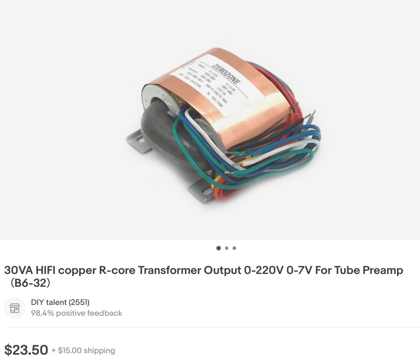

Thanks the seller recommended two of these, can anyone recommend what else I might need apart from a fuse. My electrical is 110v.
R-Core Transformer Output 0-220v 0-7v
You can use for your 220V a little isolation transformer from a shaver socket, sometimes you can get second hand very cheap on ebay. For the 6.3 to 9 also a small low power toroidal will do.
Of course there is the option of using a proper power transformer designed for valve amplifiers, with both windings, but that will cost a bit more. It depends on what is available near you. There are decent ones in Aliexpress.
Can you send the link thanks. It's not about cost it's more about compact and low noise.
