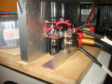

New amp for pc music player
Here's a pic of my new 2-ch amp being built up for the pc music player. It's a test-bed, so no comments on the case
It sounds really, really good. No problems at all. Next, it will have 2 transformers and 2 more channels. Then, I'll rip the crossovers out of the speakers. They're just 2 way diy Vifa monitors atm.
