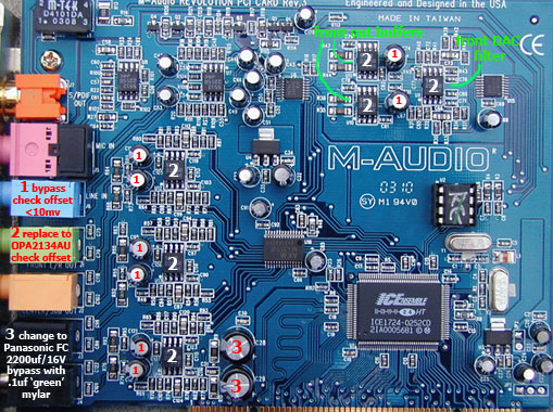

Sorry, I just hurried up and wrote everything in one post 🙂 I don't own a good CD player/DAC/preamp anymore but rely simply instead on my modded M-Audio Revolution.
Not having a preamplifier and going DC coupled to speaker certainly helps a lot, sq is lots better than using a medium class CDP/DAC+preamp. Front out is going to Randy Slone's OPTI-MOS power amp kits (200W mosfet) -> to Infinity Reference Standard II.
Nothing further to add from my side 🙂 See below for details, pic is of unmodded card 😀
RFScheer said:I'm hoping some people with more experience - like lucpes who posted while I was writing this- will discuss some of the ways their pc's have extended the quality and experience of music playing or at least what they're currently attempting.

These guys are making a good point that I am sorry to have ignored.
While we debate the death of ultimate disc players (so I exaggerate), there is nobody on this planet capable of reading this forum who should be using a non-high-end cd player anymore.
Commonplace Sony's and Pioneer's and Marantz's and Philips and so on and on should be sitting in the basement.
It's obvious that a mod'd $150 M-Audio card is good enough to replace all of these and allow you to do so much more based on the pc. What's not yet so obvious is just how good the analog out can be? Just how far into our diy territory does this analog source penetrate?
Now, back to the main argument. Can we successfully convince the undead that they should give up quietly and reincarnate as hackers?

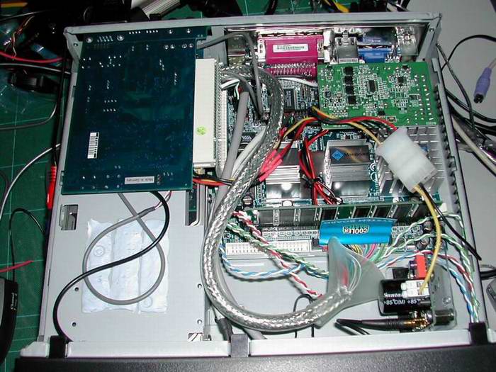

I have built an audio PC that has replaced my modded Theta Pearl (with trichord clock 3). This is the way to go in my opinion.
I am using :
1) Mini-itx motherboard M6000 fanless
2) 160GB seagate hdd
3) 512MB RAM
4) RME DIGI8/96 sound card modded with LC 3 clock
5) fanless brick power supply.
With the above setup, it is equivalent to my CDT. (better bass but lose out a little in the vocals).
I have added a clock conditioner to my system - Apogee Big Ben. This has helped to eliminate the last bit of problem with the vocal (ok I am a bit anal here. Can only hear this little bit of brightness on certain tracks but I want none of that of course).
This setup has more potential for improvement. :
1) I am planning to build a linear conventional power supply to take the place of the brick switch mode supply.
2) Somewhere further along the line, I plan to replace the internal DC-DC convertor to an all linear power supply (however, not confortable to take the leap in one step)
3) I am also working on a dedicated shunt regulated power supply for the clock module.
Please have a look at the internals of my audio PC.
Note : I am using this audio PC SPDIF out exclusively i.e. treat it as a CDT replacement.
I am using Foobar as player & EAC as ripper in full WAV format.

Joe,
Nice. Nearly silent PC due to fanless choice. Would you make the same choice of mobo again?
Have you tested with and without the LC3 soundcard clock mod?
Could you say more about the Apogee Big Ben? I don't know what that is and hopefully I'm not the only ignorant one on that issue.
How do you control playlists and all the other settings like volume?
I love your post because you're happy with the decision to get off the merry-go-round
even though you were using a really good transport.

The LC3 clock made a noticable improvement
The Apogee big ben is a clock conditioner among other things. It is supposed to improve the jitter peformance of the preceding equipment (don't shoot, I have no measurements to prove this😉 )
www.apogee.com
I have less then 200 albums on the PC. So, I just generate playlist on the fly (i.e. i generate the playlist each listening session - similar to loading a CD to my CDT but no need to get off the king's throne (listening chair))
I control the volume with my linestage. That means the the volume is not attenuated in the PC.
I don't control any other parameter from the PC. Room correction is done using other hardware in my system.
