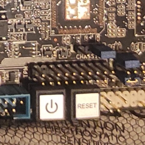

The on-board power LED does not illuminate? Both 24 and 8 pin ATX connected, correct? Check voltage readings on the ATX connector with DMM when the power supply is on.
Please look at picture.
There are two onboard led illuminated switch.
One for power on red led illuminated and another for reset green led illuminated .
Pushing the power on switch,both led illuminates and you can see the power supply fan start running and the CPU fan running too.
I have connect both 24 and 8 pin ATX.
I have check with DMM when power supply is on
Everything looks good.
12v,5v,3.3v,-12v e.t.c.
I have also tried another good one.
Like Phofman said, the capacitors on motherboards that old become an issue. Had this with a dual Opteron: capacitors with bulging tops. Depending on the brand and series of capacitors it can be obvious or not, some vent at the bottom and then damage tracks on the pcb.
Reactions: Conrad Hoffman
If you haven't tried it already, remove the CPU and inspect all the MB CPU pins for damage. If OK, reseat the CPU. Try again with only one memory stick. Try different memory sticks. You have tried two different power supplies. Are they good quality, reputable brands? If it still doesn't work, then it seems that something is likely defective with either the MB or CPU. Can you test the CPU in another, known working MB?
Thanks for respond.
I had look at CPU socket early.
I have seen some not good looking pins.
I have tried to restore some of them.
A group of those looking like oxidized.
I have used a cleaning spray and IPA,but I don't think that I see clear pins either.
Power supplies are good working in another PC.
One brand is Corsair 750w.
Unfortunately I haven't any other socket 1366 motherboard.
At this point, @thimios has tried all the usual fault debugging suggestions except for determining if it's the MB or CPU that failed. The easiest way is to spend $20 CDN on ebay (or the local mkt) and get the cheapest LGA1366 CPU that the motherboard supports (i7-920) and swap the CPU. If that fails then recycle responsibly.
[edit] I did have an Asus MB from that era that started to not post/boot if a certain IDE drive was connected or a USB flash drive was present during boot. So maybe disconnect the HD's and any other peripherals if they were still connected
