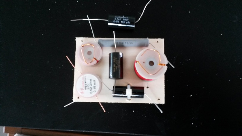

View attachment 557618 Does this look like a good crossover layout?
Hi Zonneschimmel,
I can't comment on the crossover topology but I'd recommend flipping the bottom left and top right coils onto their sides and orientating their poles better (see link re: passive crossover component placement)
Placement of coils in crossover networks
So the parts arrived. Does this look like a good crossover layout? The cap that isn't on the board will go below the resistor, second resistor is underneath the bottom cap.
Looks fine just orient the air core inductors so that their magnetic axis are orthogonal so you do not get crosstalk between them via magnetic coupling.
