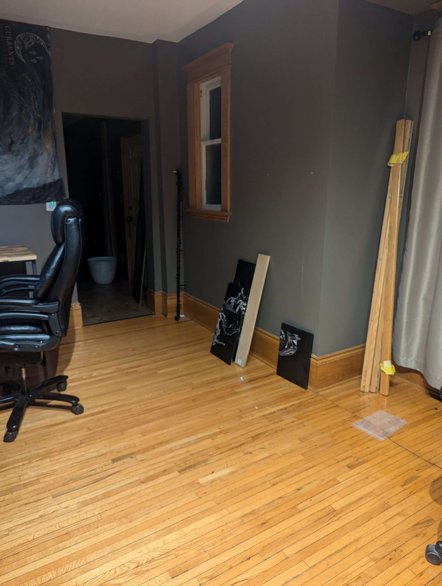

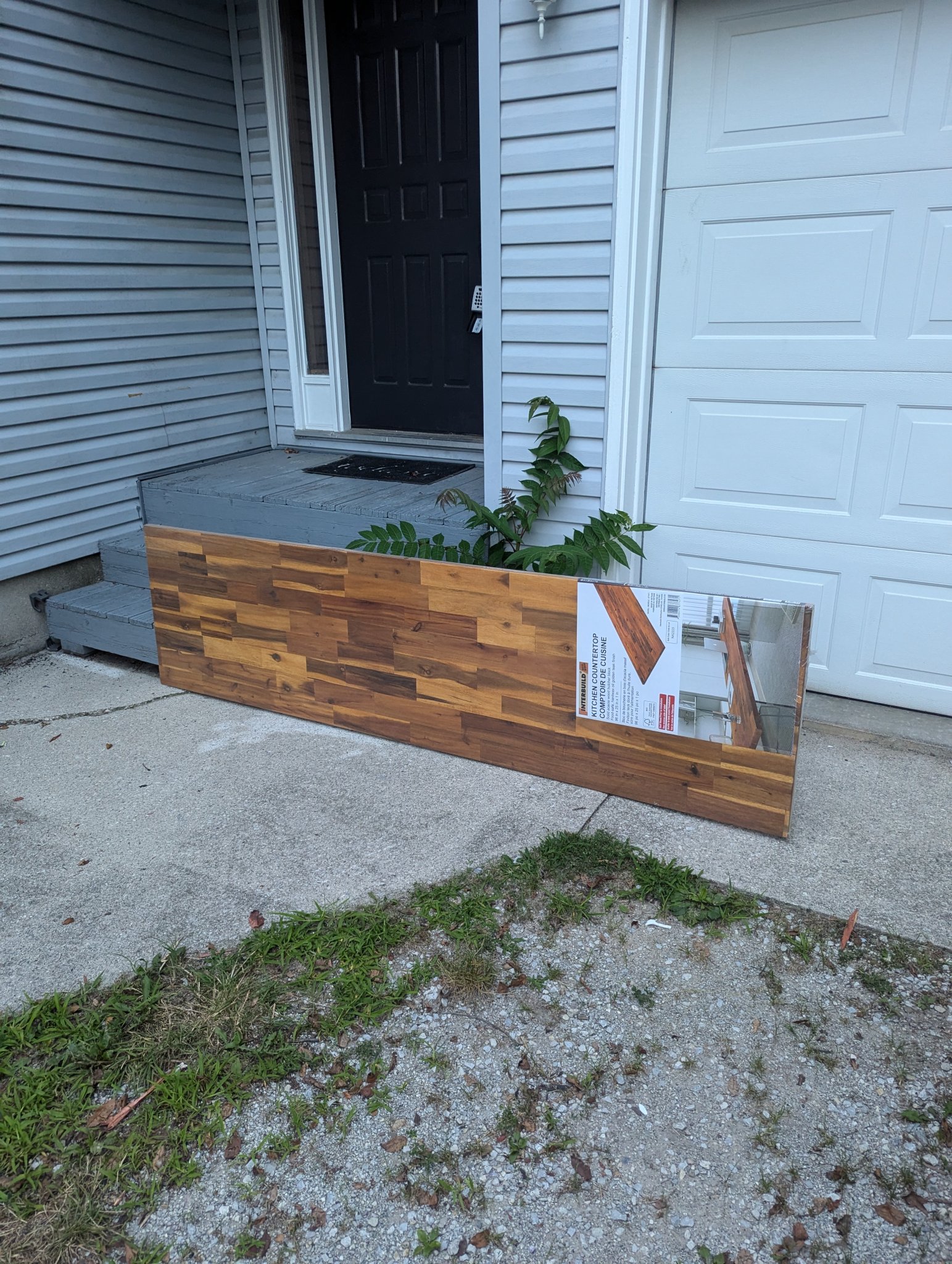

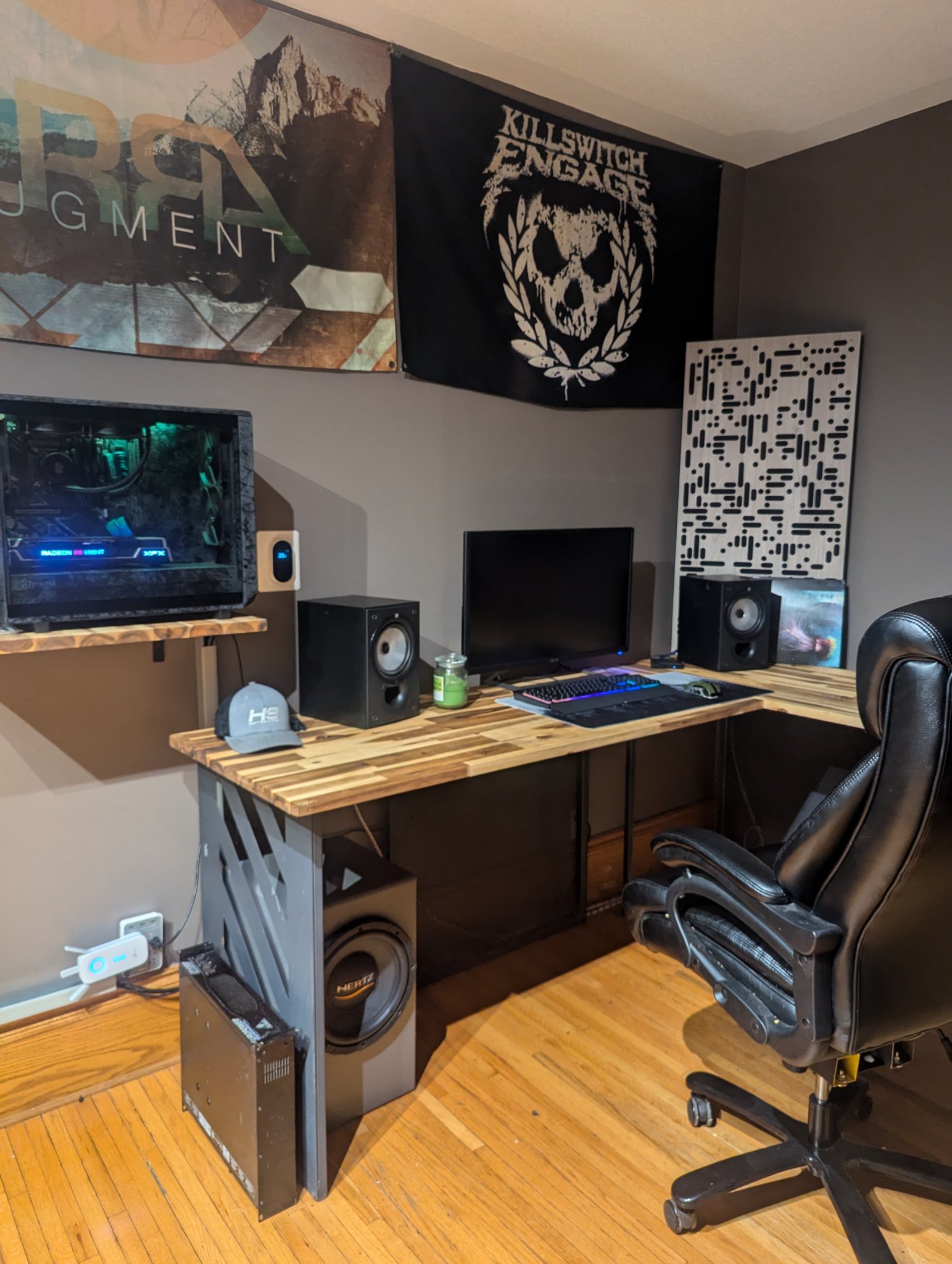

I have attached a few photos including how the desk is setup showing the space I have to work with. I'm going to be using the same Acadia hardwood countertop material for the enclosure so it'll match the desk. As you can see in the photos, I have a fair bit of flexibility for placement.
For the crossover I just have a simple external Rolls SX95 and the amp is an old Behringer EP1500 that will do 400x2 into 4 ohms, I think that should be more than enough power for the application.
I would keep the speakers away from the desk, wall mounting frees up desk space and avoids resonance, you can read up what that does to electronic equipment.
Using foam isolation pads would help to reduce vibration transmission from the speakers through to the desk, and it is an inexpensive approach to the problem. These pads usually allow tilting of the speakers backwards, which will help get the speaker radiation pattern to point more directly at the listening position.

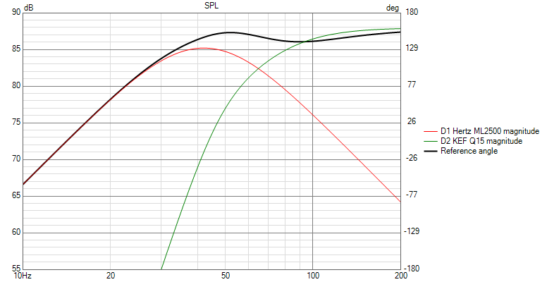

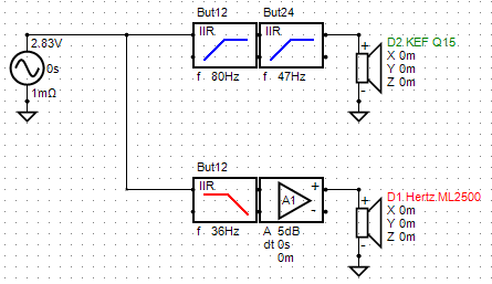

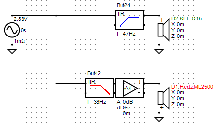

Backtracking through your data... The specifications of the KEF Q15 indicate that they are −3dB at 47Hz. With the two Hertz ML2500 10-inch woofers mounted in the same enclosure, each will be driven separately using the Behringer EP1500 2-channel amplifier. The available subwoofer filter is a 12dB/octave Butterworth low-pass filter.
A VituixCAD model of the above configuration is shown below. The Q15 is modelled as a 4th-order high-pass response in the simulation.
The summed response of the KEF Q15 and Hertz ML2500 with its filter set to the minimum frequency of 36Hz is shown below. The subwoofer needs to be connected with inverted polarity.
The above is not a particularly good result, as we need a peaked bass response before we get any effective bass extension.

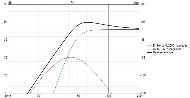

To improve matters, what's needed is some high-pass filtering on the Q15. Here a 12dB/octave high-pass filter set to 80Hz is applied.
Now we get a much better and more extended bass response. However, because the choice of filtering isn't as good as it might be, there is a 1dB dip in the bass response between 50Hz and 200Hz, which is due to some phase cancellation. The bass response is now −3dB at about 30Hz, which is a major improvement.
