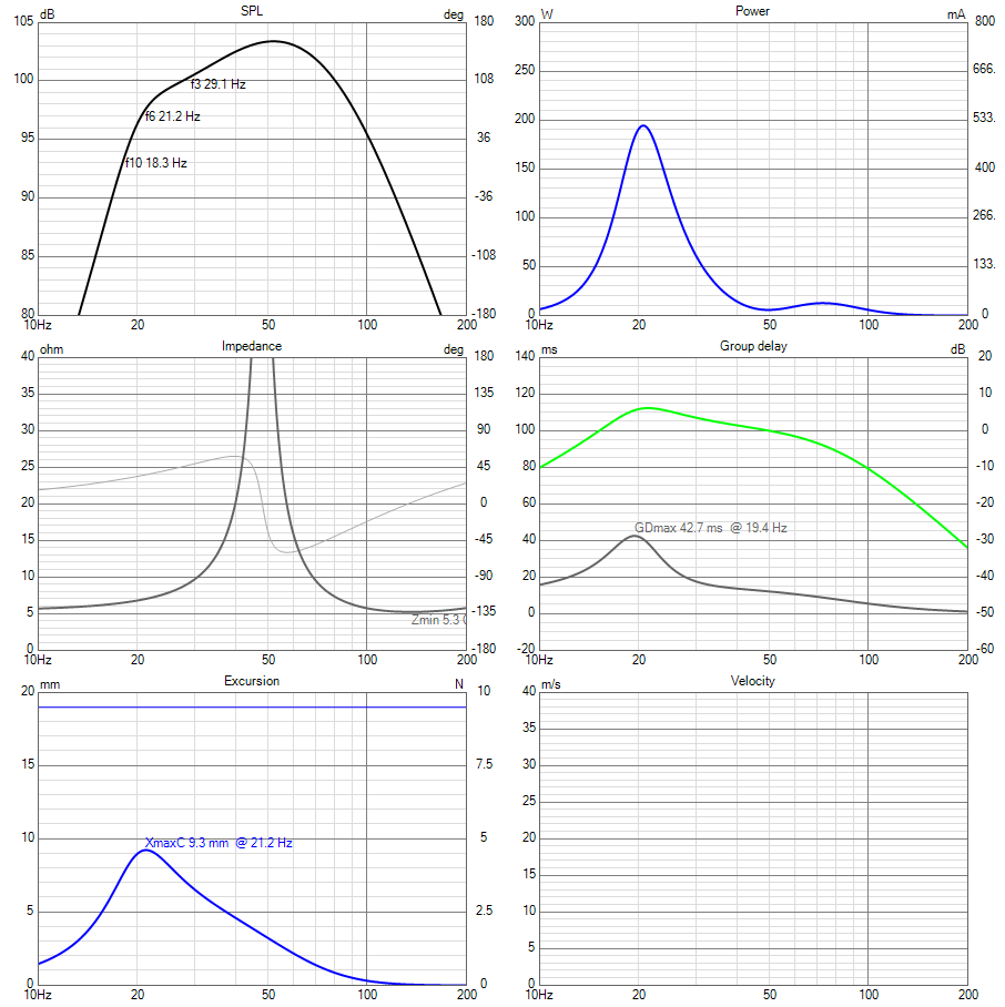

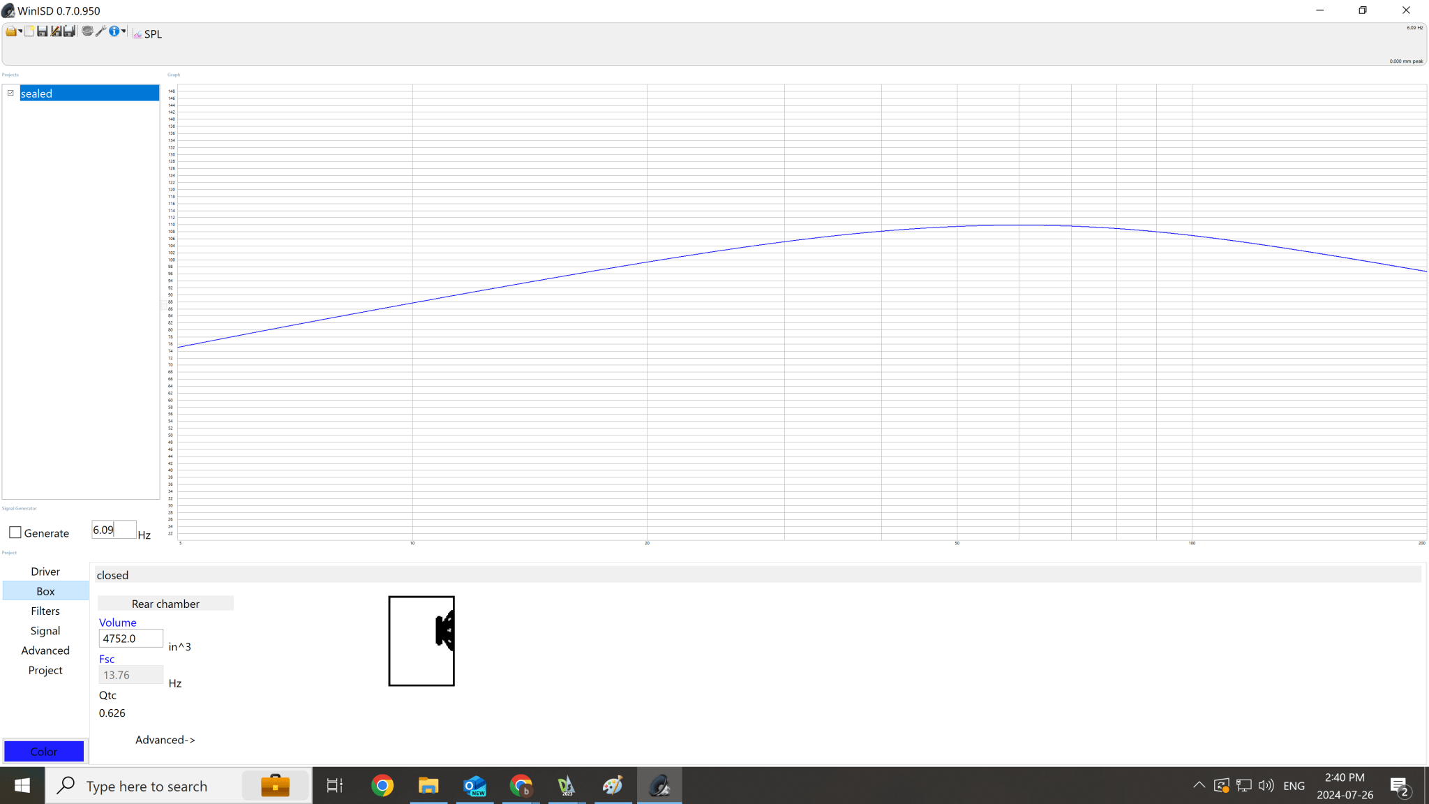

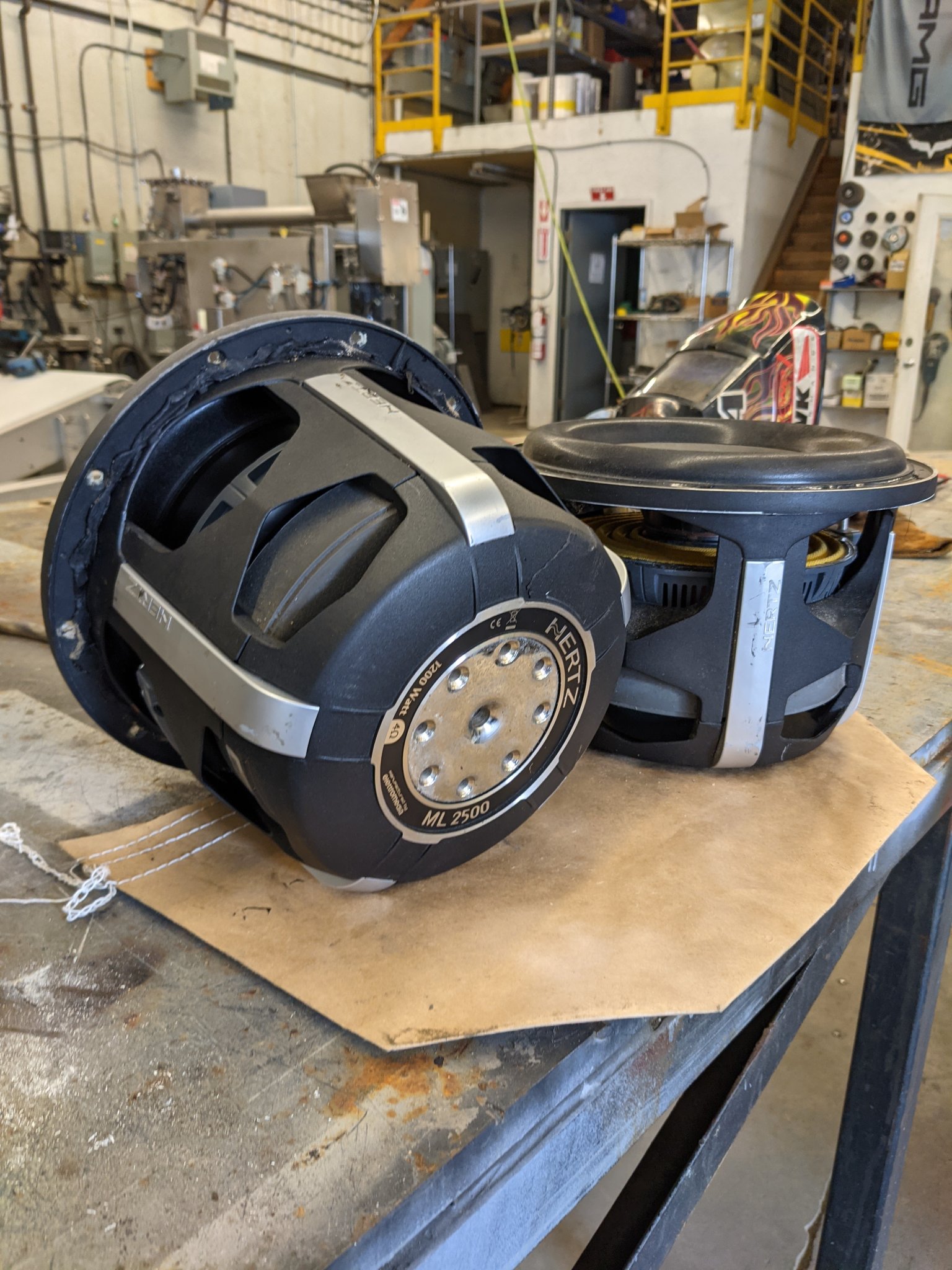

I recently moved from my little apartment to a nice big house and I have been working on setting up a nice computer desk with some decent audio for gaming and music. I currently use a pair of KEF Q15 speakers on a small Fosi Audio V3 class D amplifier, these speakers sound pretty nice but they have very little bass to speak of.
I have a pair of Hertz ML2500 10" subwoofers leftover from my car audio days and was considering sticking them in a nice Acadia Wood box to match my desk. Way back when these were really expensive drivers and were considered top of the line so it would be nice if I could repurpose them assuming they'll work well in the application.
I managed to find what I believe is the correct TS parameters on an old forum post and ran a quick model in WinISD with a 1.5 cubic foot sealed box that looked pretty good. These are good looking drivers and it would be nice if I could put them to good use.

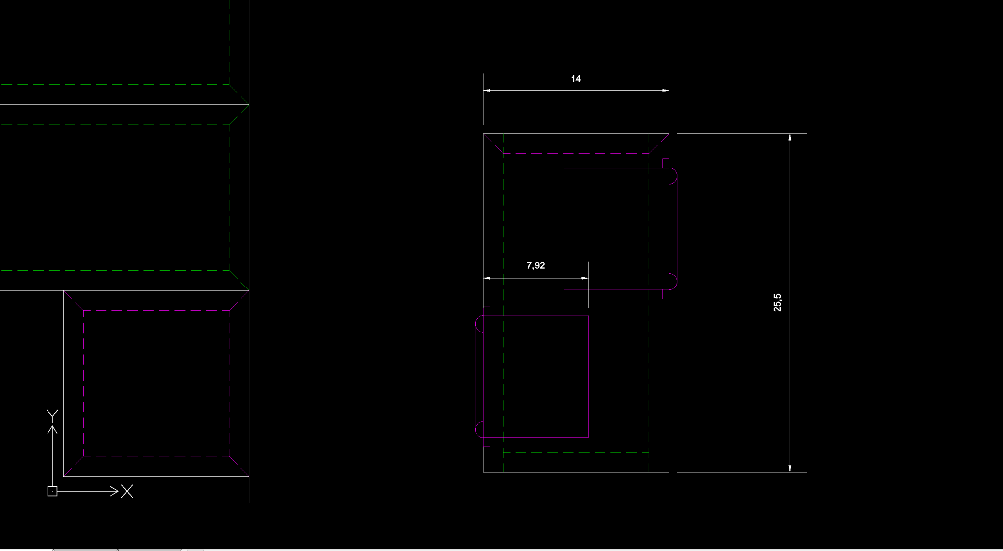

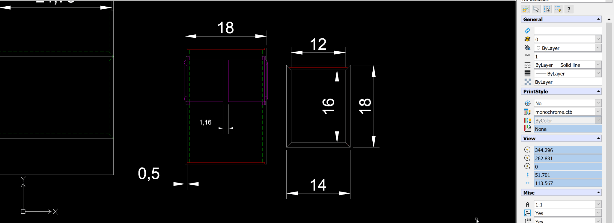

So looking at my model there's definitely no way I'll be able to mount these beefcake subwoofers magnet to magnet without really growing this enclosure. Is there any reason I can't do an offset push push design like I have modeled? Or will this negate the benefits?
Doing some more research I believe I answered my own question, it's definitely ideal to have both drivers inline with eachother. I also changed the material thickness from 1-1/2" thick panels to 1" simply due to material availability. The top and bottom panels have been changed to 3/8" laser cut steel so I can have them removable, I want to mount the drivers from the inside for a cleaner appearance. This has made the box grow a bit more than I'd like but I might just have to deal with it.
After the changes I get a box volume of 2.75 cubic feet not included driver displacement or bracing. Updated drawings and WinISD graphs are attached.

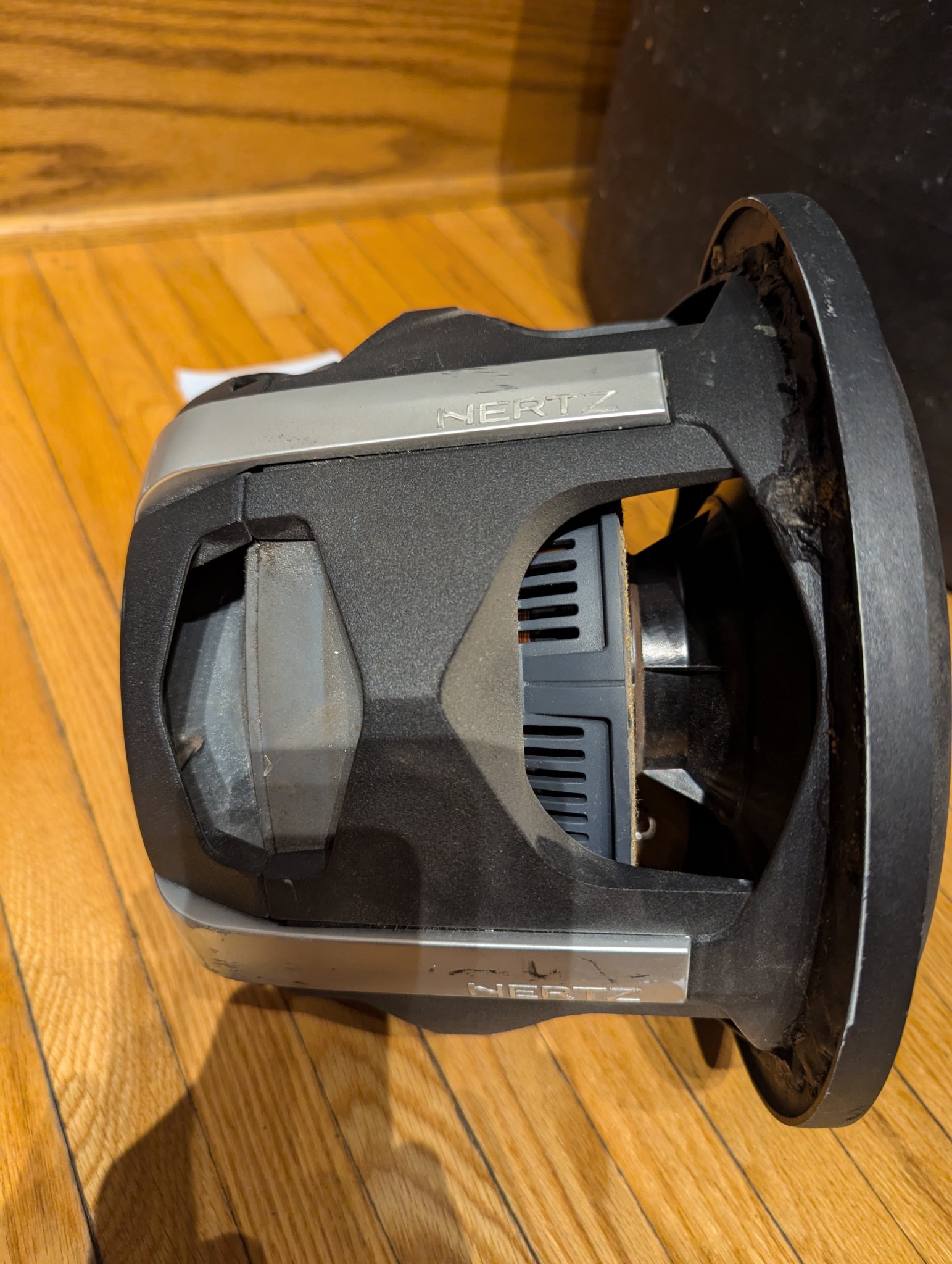

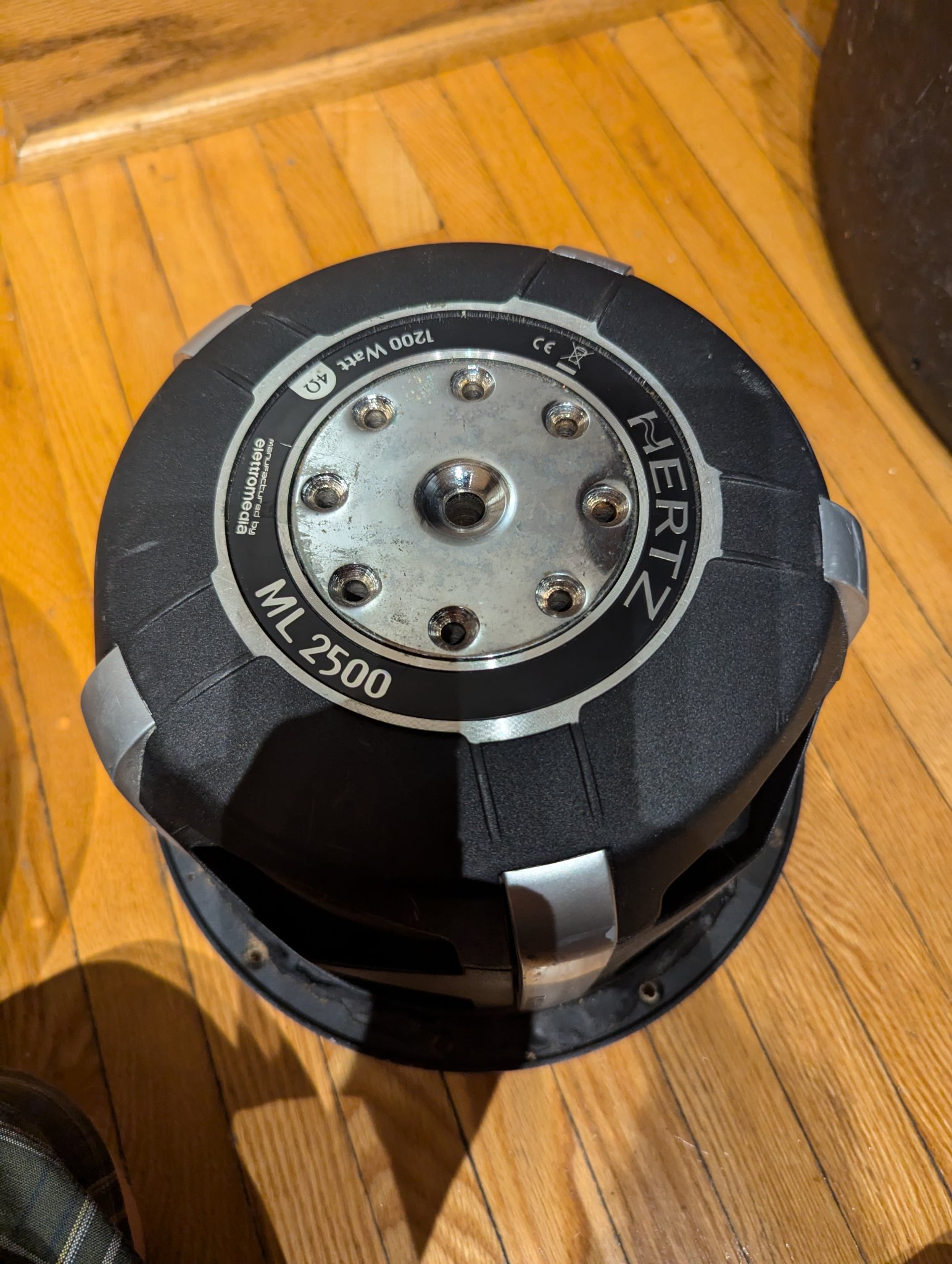

For simplicity's sake I'm just going to do a sealed enclosure this time around. I attached some photos of how the driver is vented, my current drawing shows a 1" space between the magnets.

Those ML2500 subwoofer drivers appear to be very nice units, with lots of Xmax and a good power handling ability. The closed-box enclosure that is 1.5 cubic feet (42.5 litres) in net volume also seems quite reasonable. With the two drivers inside that enclosure, it's very close to a maximally-flat alignment.
@brandon3212276 Will you be using a plate subwoofer amplifier of some sort? If so, which one did you have in mind?

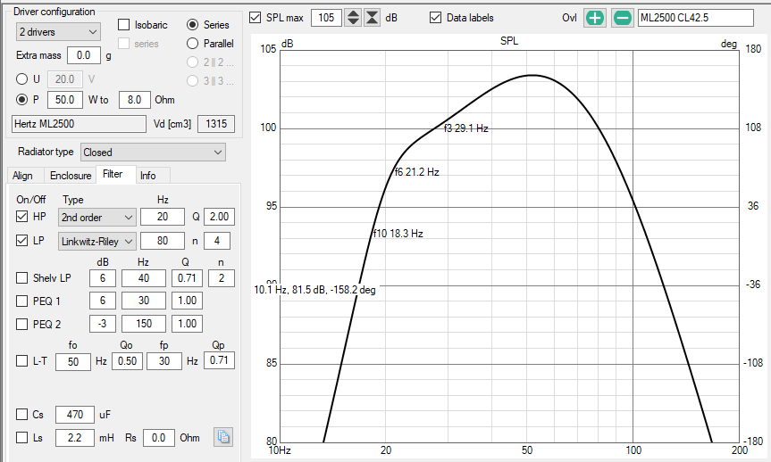

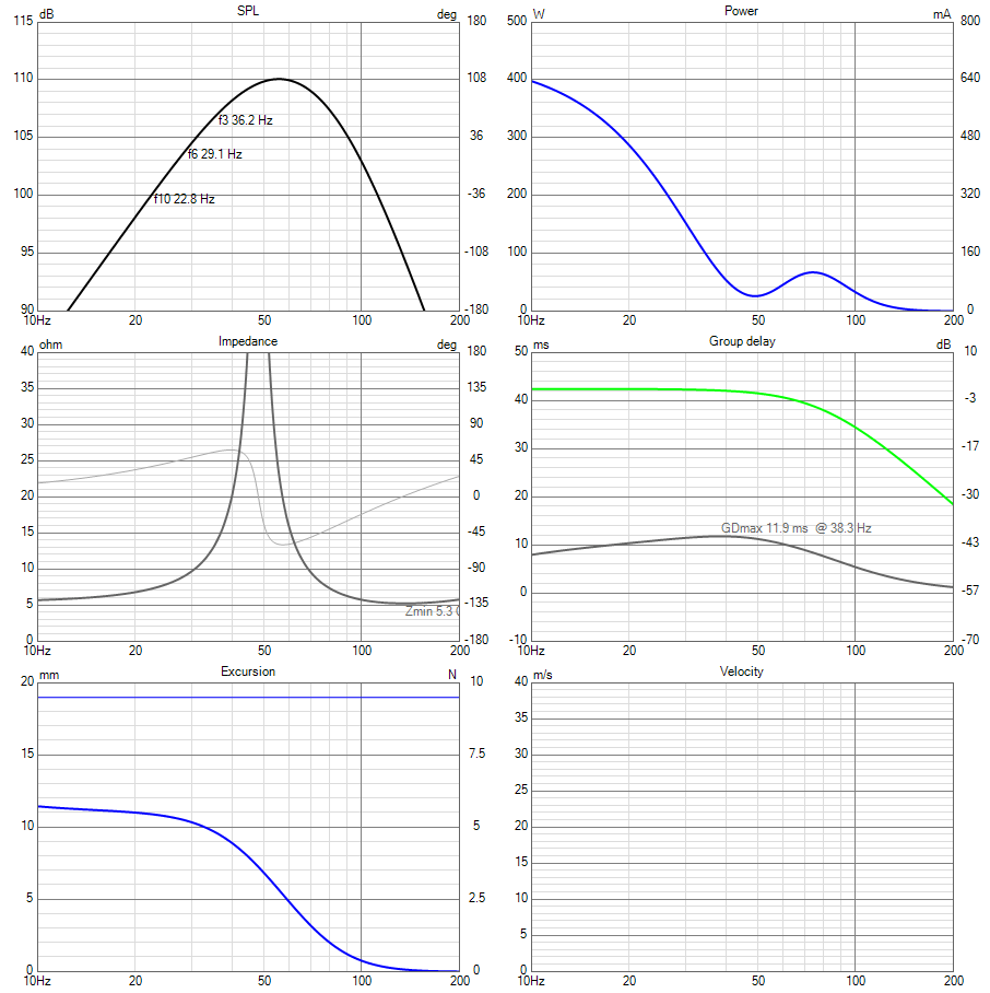

With a Linkwitz-Riley 4th-order low-pass filter in the signal chain, with its −6dB cut-off frequency set to 80Hz, the response of the twin-driver closed-box subwoofer will look something like what is shown below. Applying 300W re 8 ohms of input power, both drivers will reach 11mm of displacement at 20Hz, which is well below their Xmax of 19mm. The low-pass filtered response is −3dB at 36.2Hz.
If we add a 2nd-order high-pass peaking filter, set to 20Hz and Q = 2.0, we can get quite a bit more bass response out of the system. See the results shown below. This produces about 5dB more output at 20Hz than the un-EQed design shown above. Note that the slope between 25Hz and 45Hz is about 4dB per octave, which will blend in nicely with the room gain that occurs for a closed-box subwoofer. In this design, the response is −3dB at 29.1Hz, which is much lower than the 36.2Hz achieved in the previous design.
The filter settings are shown below.
The datasheet (PDF) says +/- 17mm Xmax (which is still huge).
