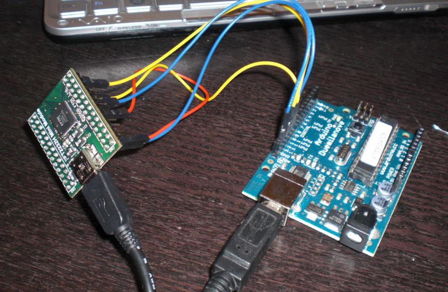

Ft2232h
I tested FT2232H (FTDI's 480Mbps device) 60MHz syncronous FIFO's speed.
55,603,200 Bytes file was sent in 4.094456sec = 13,589,123 Bytes/sec.
(at least. by 4096 Bytes packet)
192x24x16ch will require 16*3*192*1024 = 9,437,184 Bytes/sec.
So, by these components "maybe" you can output 192/24 I16S signal from PC.
(1. hardware, to buy) FT2232H module
(2. hardware, to buy and VHDL) FIFO to I2S distribution FPGA. example, Multi Channel I2S Output, to be modified to keep frame sync
(3. software) some program, read ASIO and write to this FIFO.
(4. package software) ASIO router like E-MU Patchmix
FPGA will have single central Clock, and should supply 192KHz sync Clock to EMU board and PatchMix.
(I'm working with other project so I cannot make it, about couple of months)
