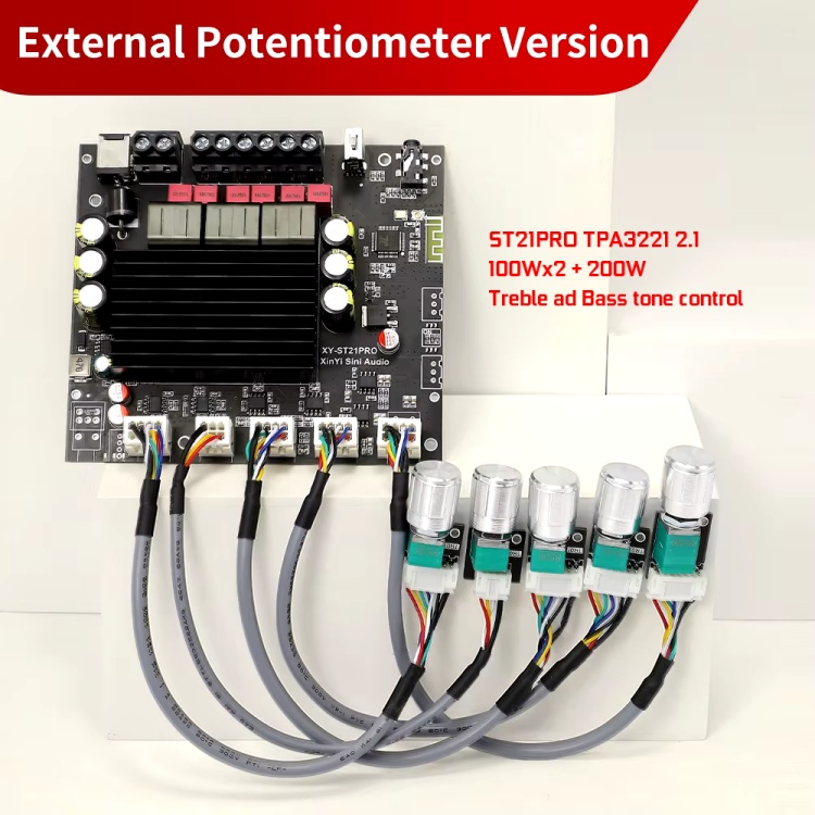

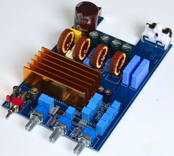

I saw this one with TPA3221 with 3 channels because I also need to drive the subwoofer. This variant with separate potentiometers would allow me to organize the front panel as I like without being tied to the position and distances of the potentiometers but of course it complicates the wiring inside the cabinet.
It would be interesting to see if this is well designed.

I quote myself 🙂
The amplifier I was considering has a strange behavior.
The audio level of the subwoofer is against all reason independent of the general volume, this means that you have to continuously adjust both the volume and the bass and when you lower the volume to the minimum you hear the sub playing in the background.
I don't understand how they managed to design such a senseless thing!
Purchased on Aliexpress, I returned it!

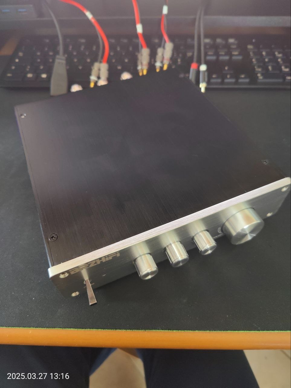

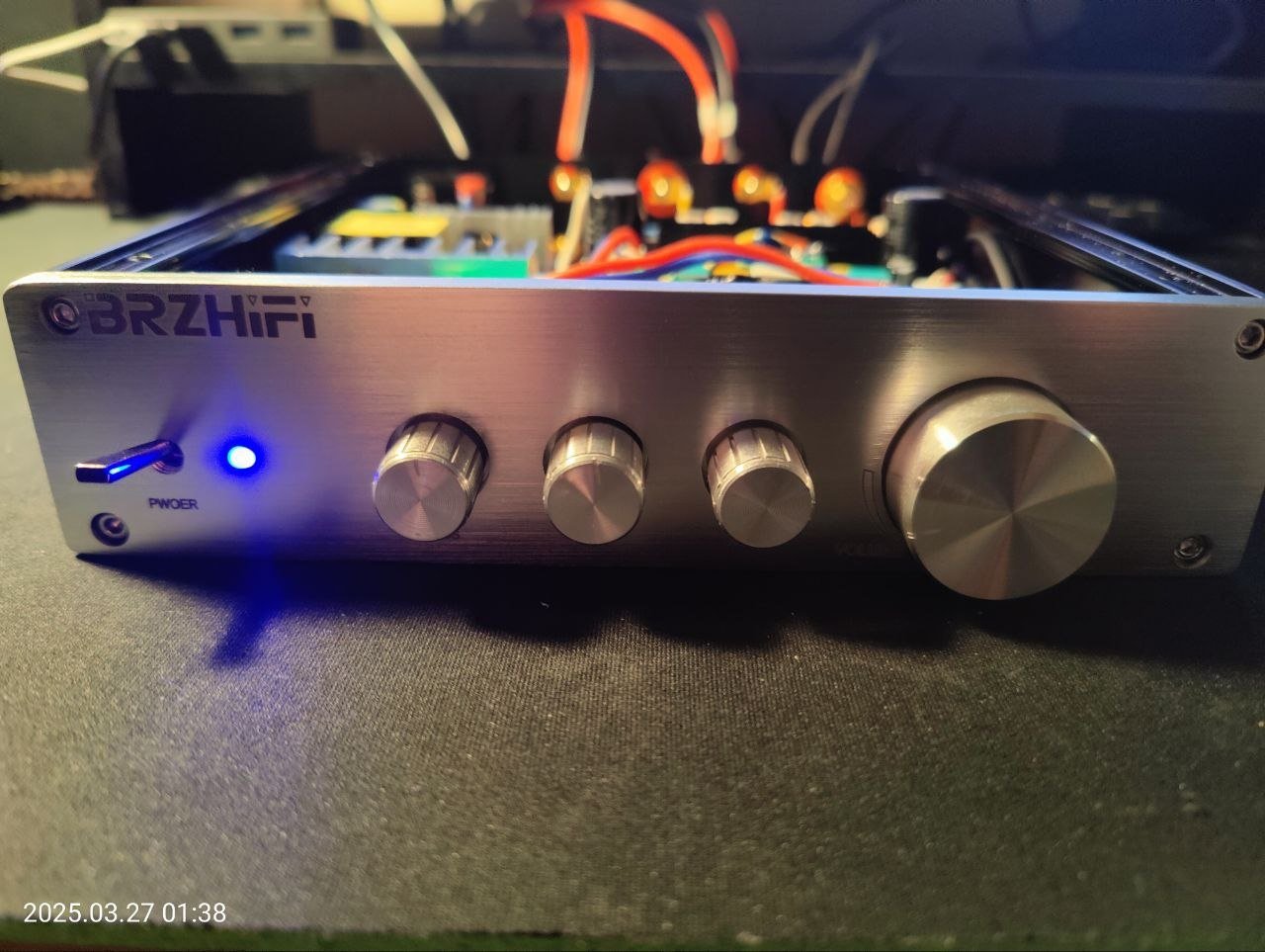

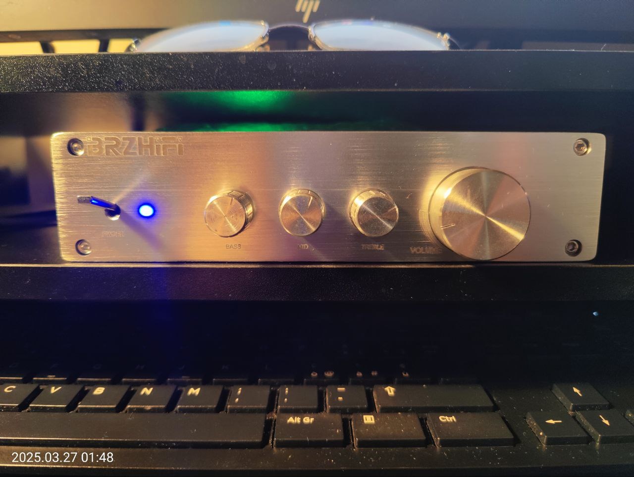

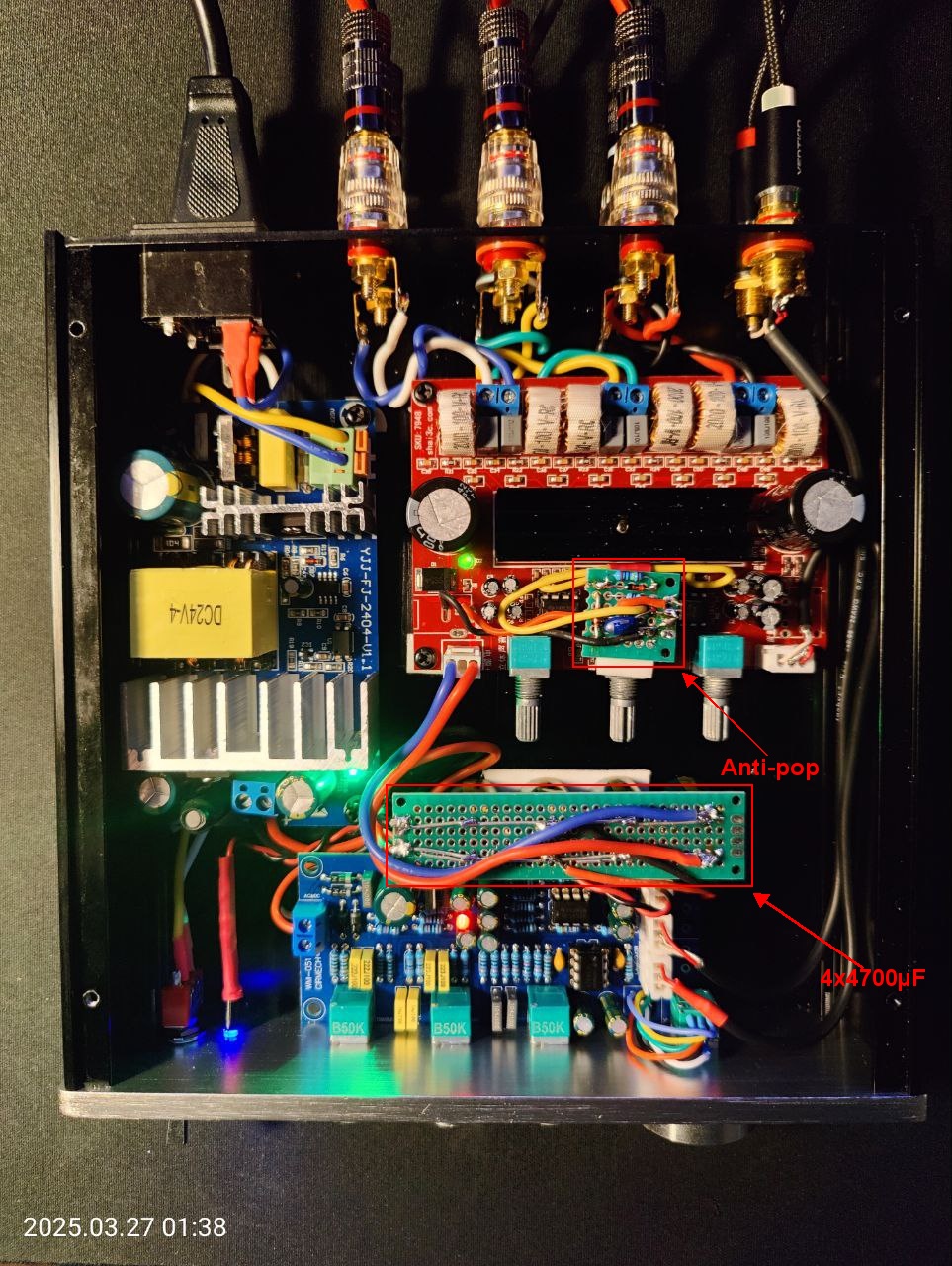

I finally completed the amplifier, I managed to fit everything into a new aluminum case, which I bought on Aliexpress for €27.00. Nice apart from a mistake on the power writing but never mind I don't notice it anymore, the BASS and TREBLE tone control writings are also inverted compared to the preamplifier, the PCB should be redone but I don't know if it's worth it.
As is evident, the HX-M139 amplifier controls remained inside the case and I adjusted the potentiometers to 75%.
I added 4x 4700µF 35V electrolytic capacitors to filter the output power supply from the switching as much as possible and also to give the FET anti-pop circuit more time to activate the muting during shutdown. Now I can barely hear a microscopic pop when switching on, completely negligible, and no pop when switching off, fantastic. Once again thanks to CyberPit! 😍
I think the 4A power supply is oversized given the efficiency of the TPA3116D2, a 2A one would be enough considering that I usually never raise the volume above 50% but I had it in a drawer and I used that.
The preamplifier with tone controls is one of the many classics with dual NE5532 available on Aliexpress, but this one has a single power supply so I saved the space of the 2x15V transformer needed for the dual power ones. I bought the kit version and, since the case has holes spaced 24+24+35mm apart, I had to mount the volume potentiometer moved to the right by 9mm and rotated 180 degrees connecting it with 6 wires. All the other preamplifiers with the right distances between the potentiometers are too big for this small case and require dual power supplies. I replaced two 18K resistors with two 43K to double the gain because obviously the single power supply halves the voltage of the op-amps and consequently also halves the amplitude of the output signal.

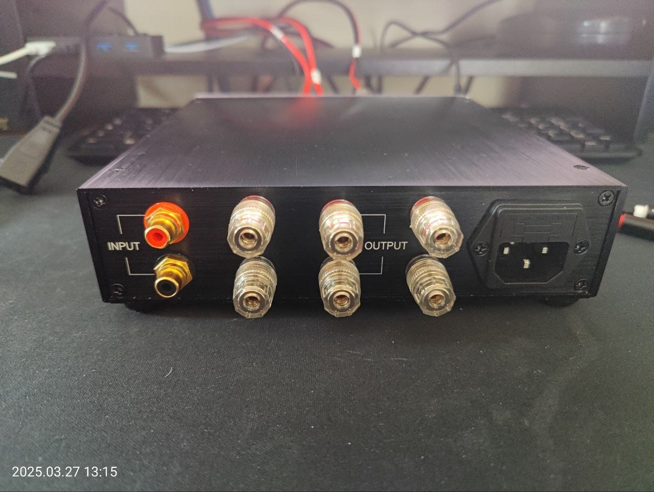

The case is designed to mount only a preamplifier so I had to drill 3 more holes on the rear panel to mount the speaker connectors.
It is certainly not a HiFi amplifier but it performs well considering the small size and the overall cost of about € 80.00.
