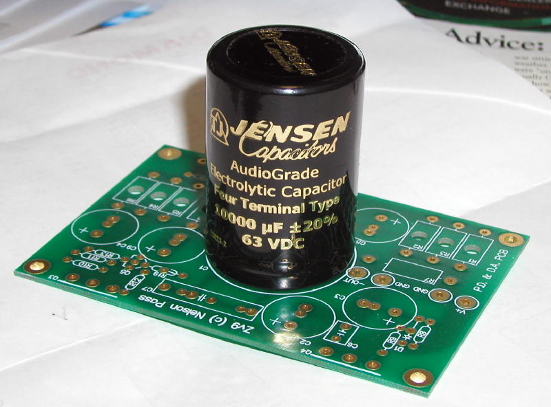

Peter Daniel said:Personally, I don't like to use any additional bypasses: a single quality cap is fine by itself.
Peter,
What would you recommend for C1? One could, conceivably, use a BG FK cap, but it looks too big (not to mention too expensive
Also, when you say additional bypasses do you mean more than one bypass cap or no bypass caps?
Thanks.
Paul
The board was designed specifically for 10,000/63V Jensen caps. Those are pretty good caps, and should work well here.
As to the bypasses, I usually never find them as improvement. They surely influence tonality, but other aspects of presentation may suffer, that's why I prefer a single cap, no additional caps in parallel. Of course the single cap needs to be pretty good.
http://www.diyaudio.com/forums/showthread.php?postid=285731#post285731
Peter Daniel said:The board was designed specifically for 10,000/63V Jensen caps. Those are pretty good caps, and should work well here.
Thanks, Peter. I'm glad to read the Jensen 4-Poles will work. Won't this require cutting the traces between the in and out connections on each side of the cap?
Could the same caps be used in the PS?
Lastly, if those are pretty good, what would be better? 😉
Paul
Cutting the traces is applicable only in PS not in coupling (as there are two active connections, not four).
Those caps will work well in PS as well; when I was experimenting with snubber and big supplies for GC, I preferred Jensens to both Elna Cerafina and Super Through Nichicons. However, they are quite expensive and I will end up with Nichicons in my PS.
What could be better? It depends on your taste, maybe BG N, but it's hard to say without trying.
If the amp is to be used in an active, multi-amp system, a much smaller cap value can be also used.

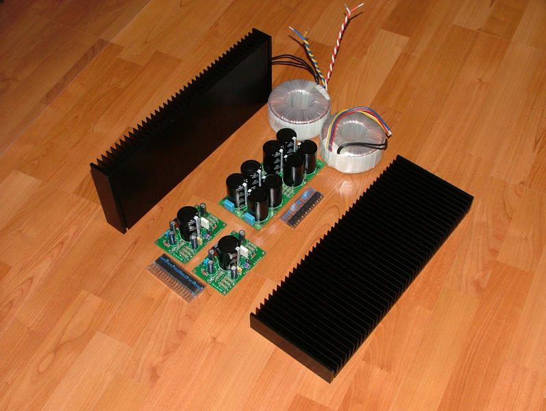

Today my heatsinks arrived together with the IRFP240 and some Dale resistors, al this was ordered from Schuro in Germany.
The heatsink measures 400x150x40, think that will be enough for one channel.

I am guessing yours will run about 55 C with those pictured, although mine are about the size of yours, but they are heat sink tunnels, which I plan on using a very quiet fan. Ultimately, fanless would be great though.
My heatsinks are drilled and tapped ready to just add the heatsink compound and bolt the board and mosfets, and jfet into place.
I hoped to have mine up and running last Saturday, but my local parts store was closed for our National 4th of July Holiday weekend!! 🙁
But I now have everything, just need to bolt things together and I am sure by the end of this week for sure it will be up and running--maybe tonight, but I do not want to rush things until everything is rechecked to make sure there are no fireworks like our "USA Indepenence day" in my chassis!!
