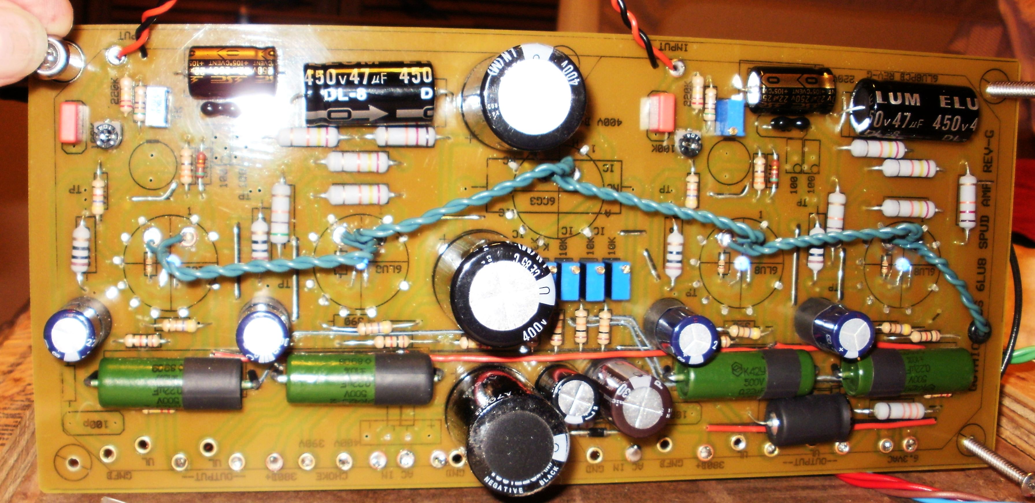

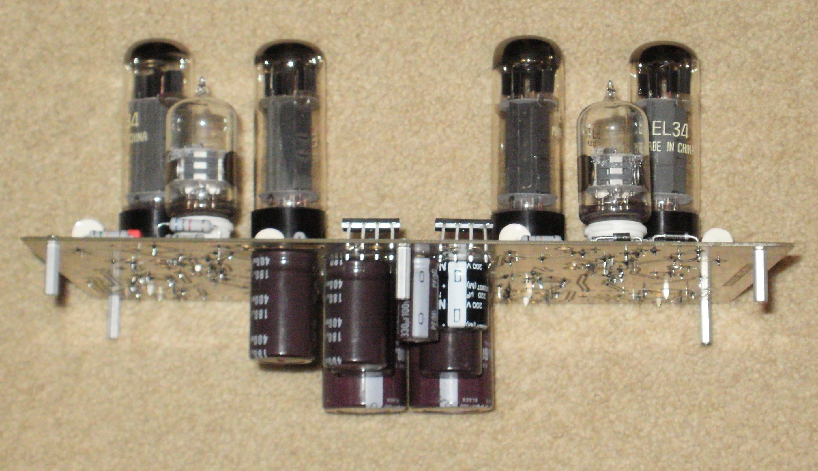

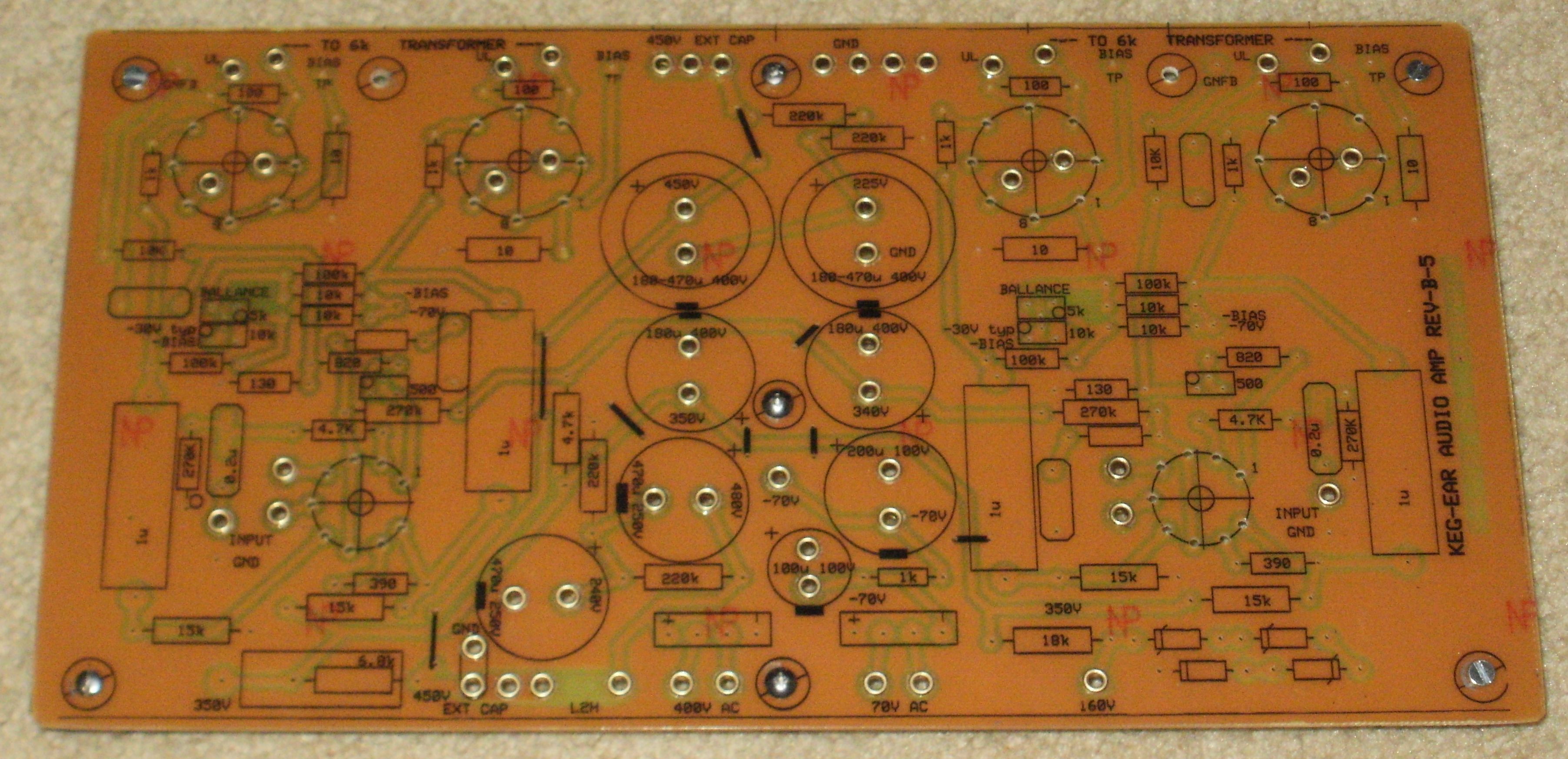

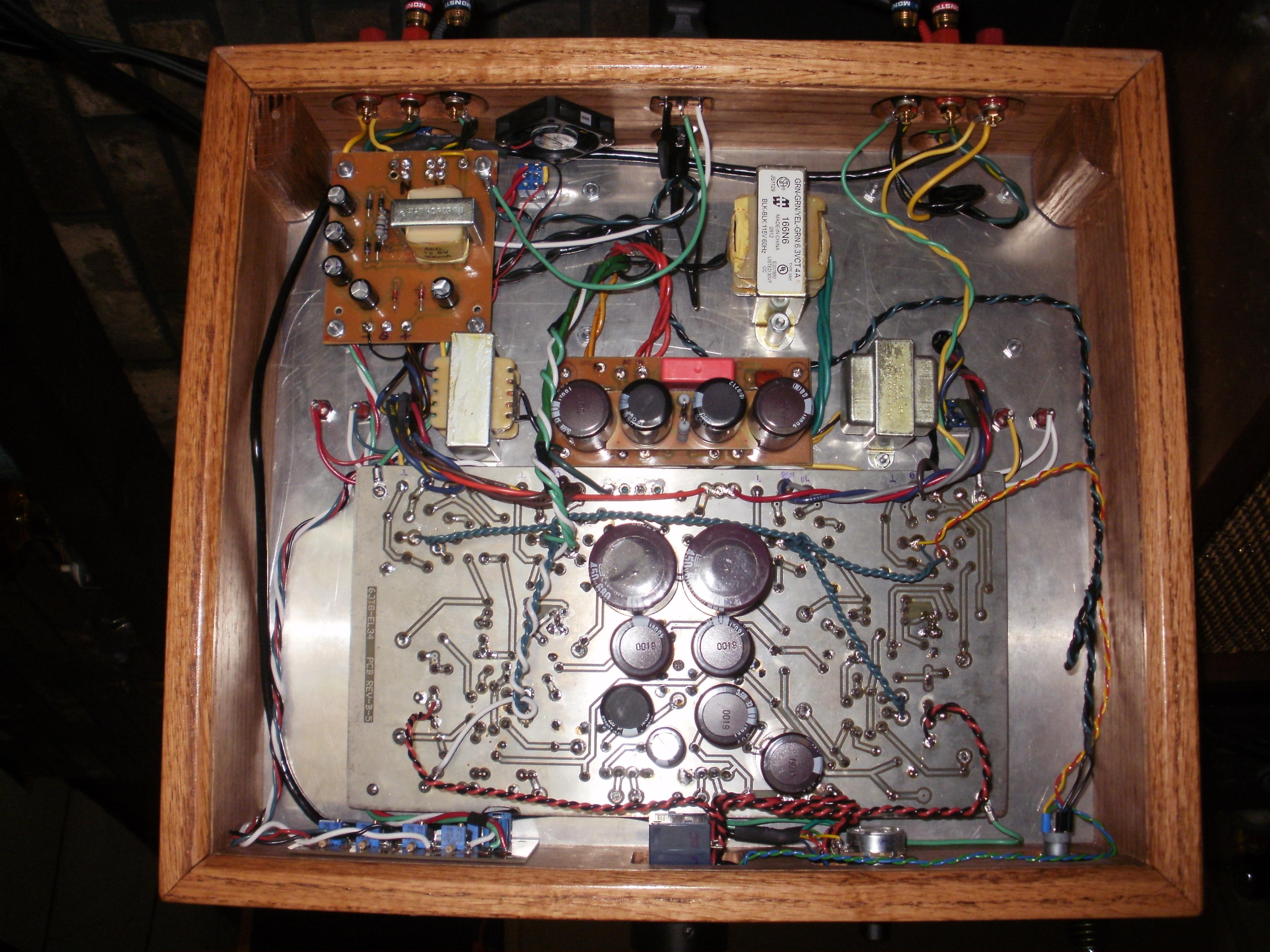

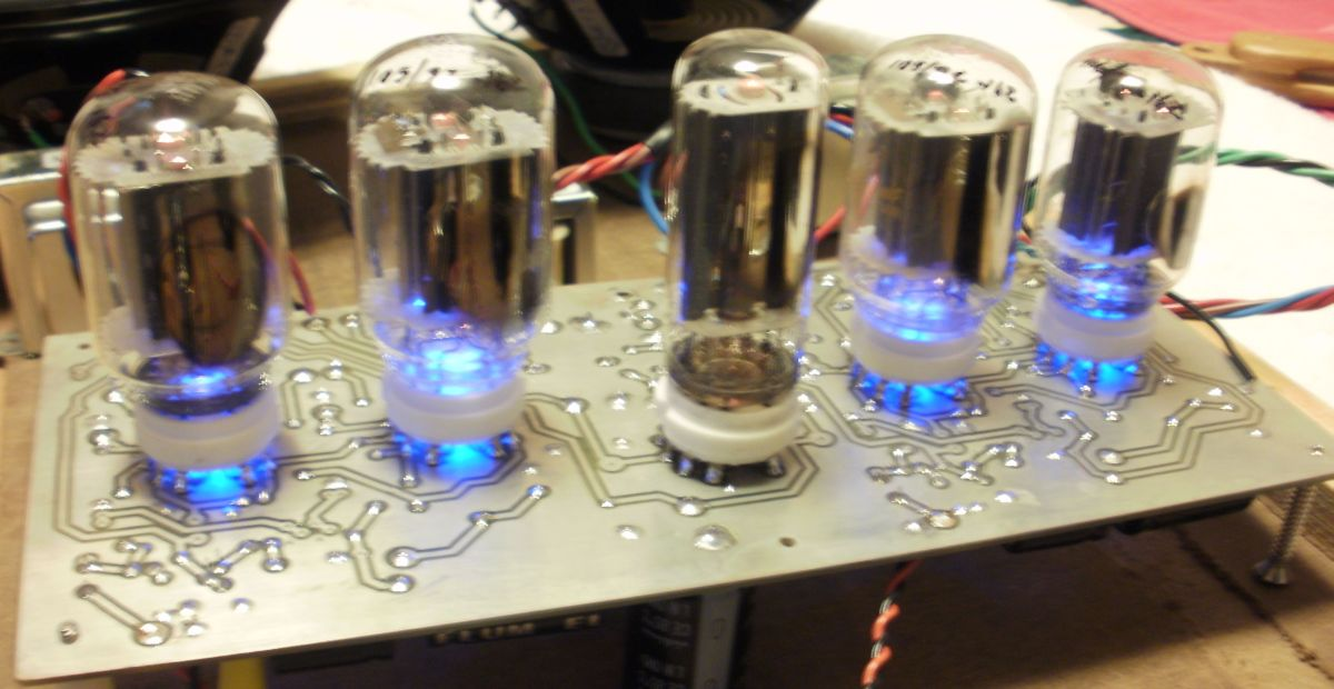

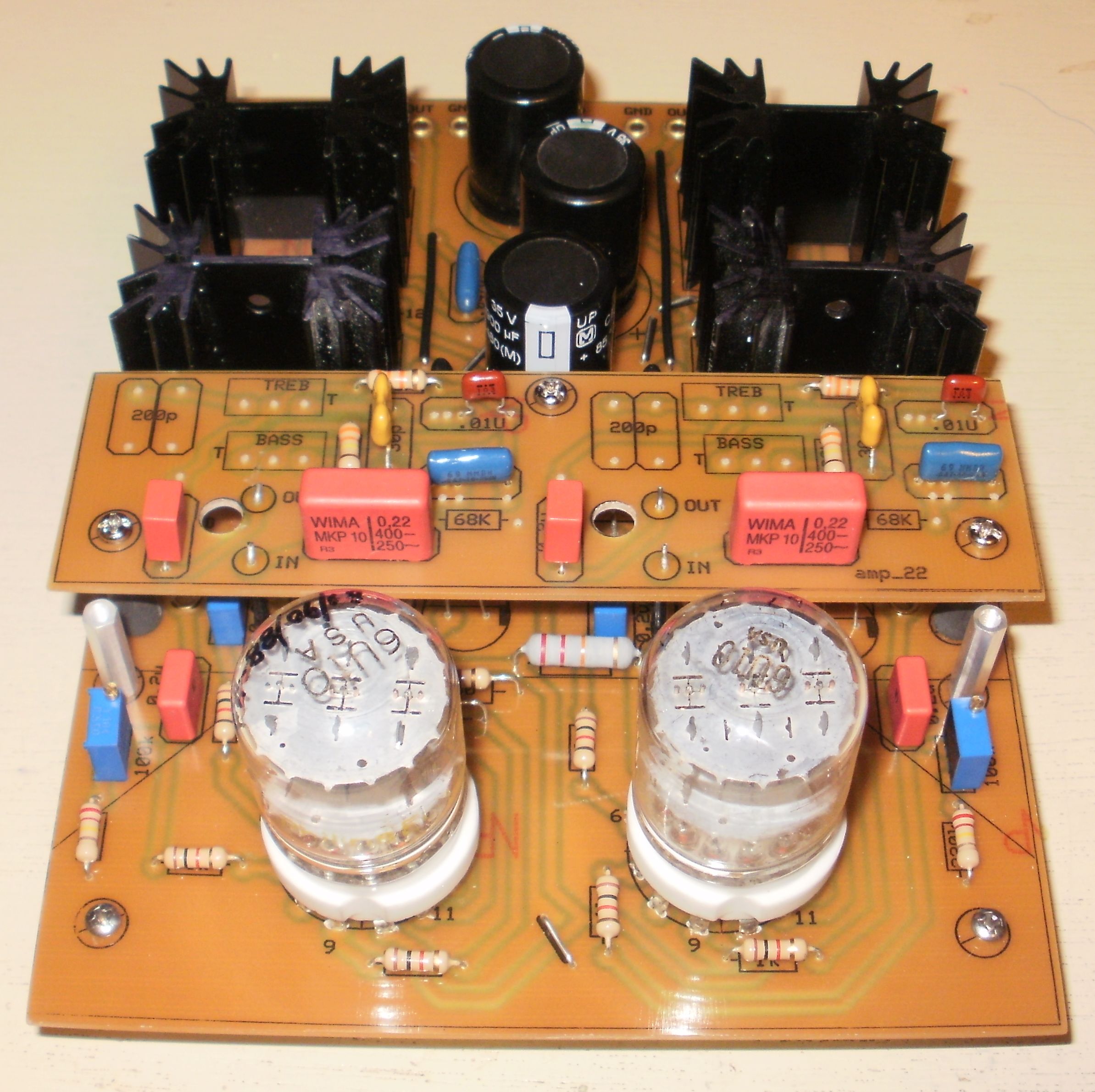

Leave the heaters to off PCB, use twisted wire sets. Space them at least 1/2" off of the PCB., leave tightly twisted up to the socket. I use solid wire to facilitate a tight twist.
Components can be mounted to the top, or the top can be made the bottom depending on where you want them at. I use single sided toner transfer so the ability to swap sides for components is limited by the use of brass eyelets. They are also used for wire connects for mechanical strength. Toner transfer limits my designs to 8.5" x 11" due to limited slick clay paper availability.
Keep the electrolytics on the cool side for their longevity if you decide to mount the power supply on the PCB. I like to use the power supply to separate the 2 channels. The little spud'ed amp uses separate B+ filter strings for the first and second stages, common large cap on the outputs to the transformer center-taps. I like to use diodes for the HV with a large filter cap, through a choke to another large filter cap, through a slow start damper tube to the rest of the circuit. The first few large caps before the damper diode need to be rated for the over-voltage prior to the tubes coming on line.
I use component leads for jumping, stitching the ground plane together over traces. I've found that this method keeps the ground potential more constant to prevent ground loop noise.
You can stack PCB's with standoffs, the standoffs transfer the ground plane. I used the gold plated pins from a DB15 connector to act as interconnects between the PCB's for easy removal. I used heatshrink to cover the female socket of the connector set for more contact force.
Elevate the heaters by 50 volts is also another trick to quieter amps. I use 50 volt zeners to stack to 160V for the screen voltage on some designs. 160 volts is also enough to fire nixie tubes.

I have allways had heaters on the pcb without any problem, but I use double sided PCB. The component side is ground plane.
My last design is two EL509 + driver tubes. Some 5 A all together. And no hum problems.
The track width I use is 2.5 to 3 mm.
Below photos of a 6V6 PP amplifier pcb.
Heater foils are those two wide ones at the lower part of the pcb.
I use double-sided PCBs as well and use 80~100 mil traces for the heaters. Works great.

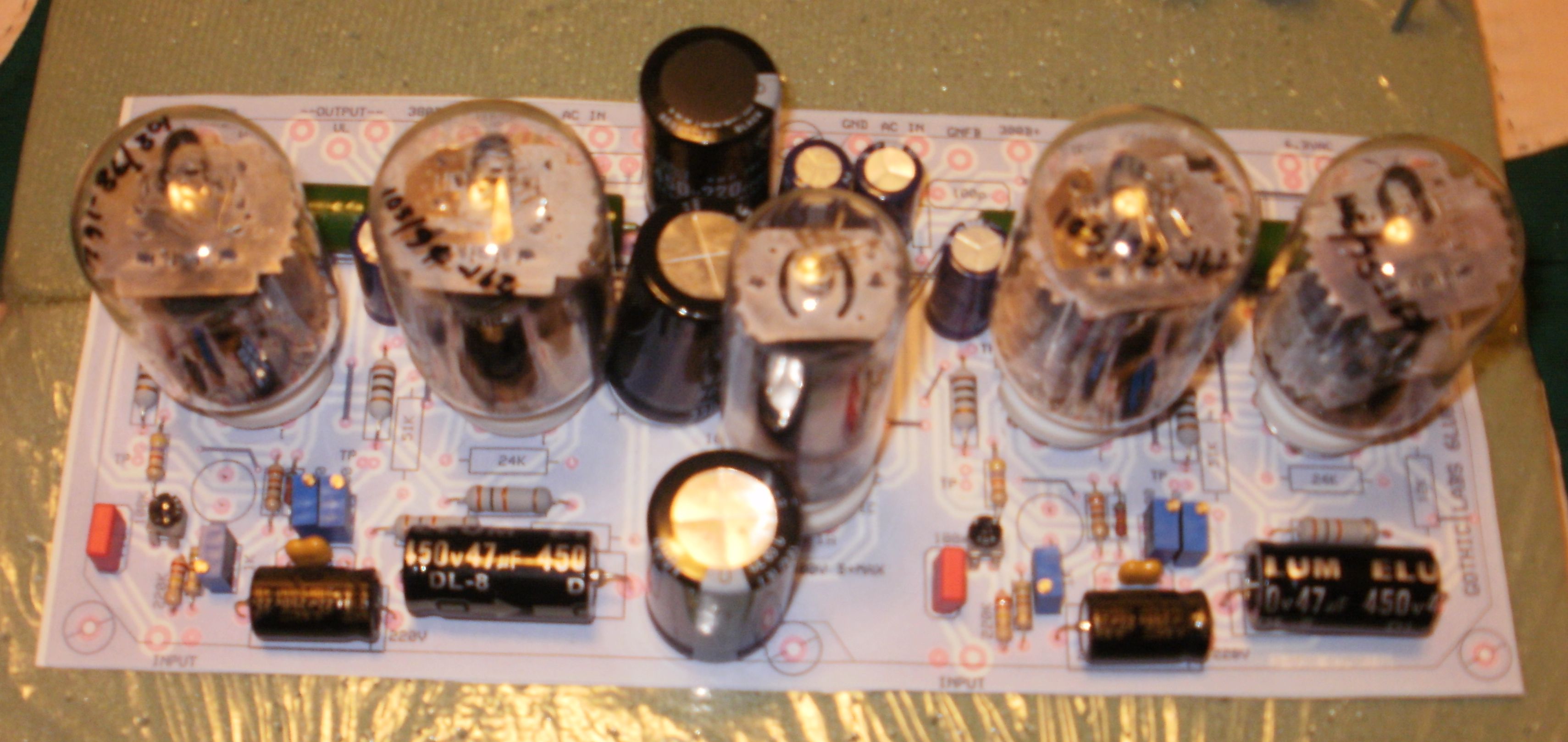

I print out the design and stuff the components into it using florist foam to back it up. I try to design the PCB to be flexible enough that various manufactures product can fit.

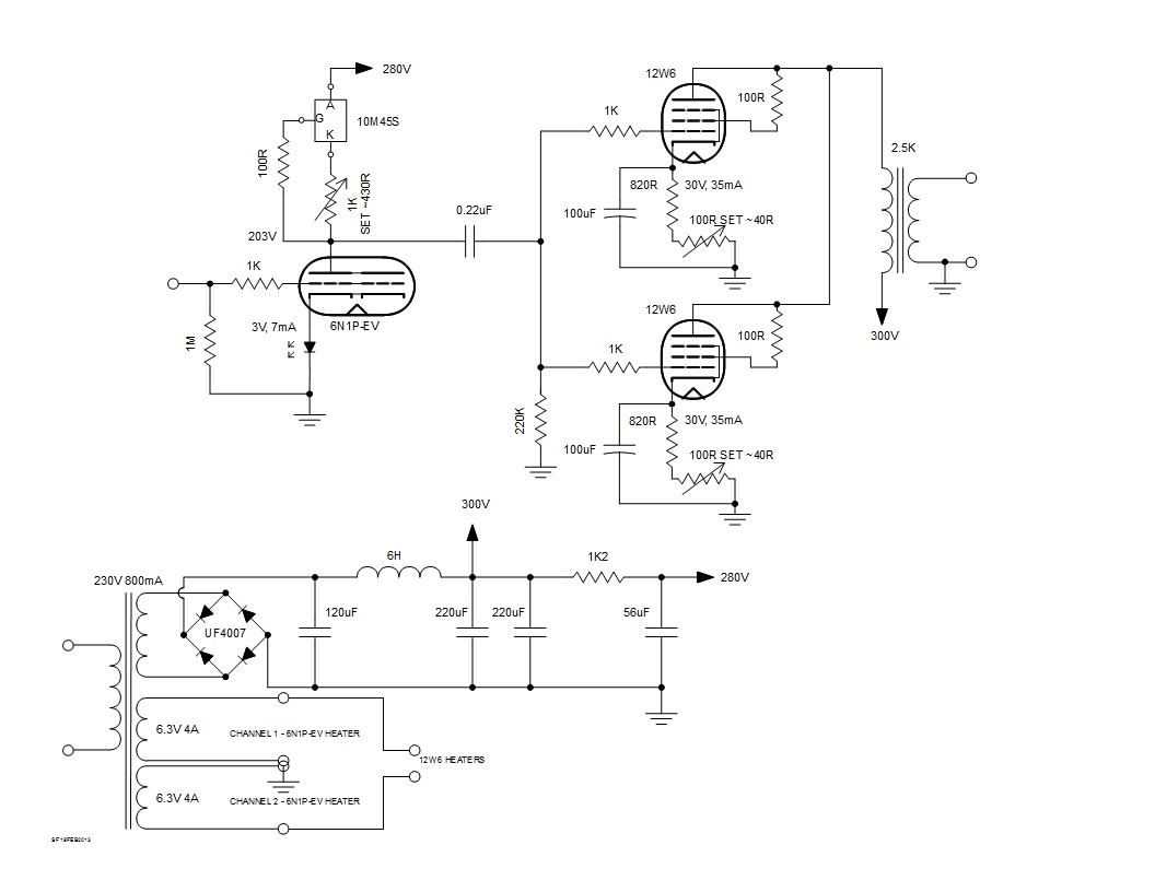

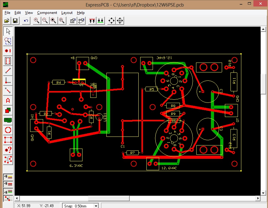

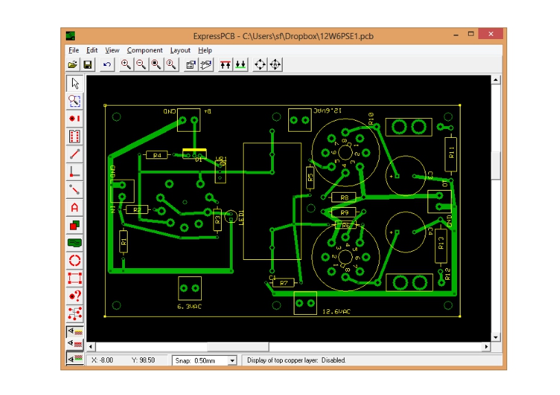

I realize this is a very simplistic design, but this is what I came up with for one channel, less power supply.
Scott

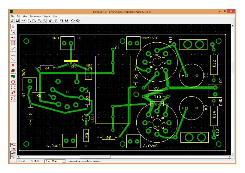

I've got the board about as compact as I can get it, 90x155mm, considering the room taken up by the large coupling capacitor.

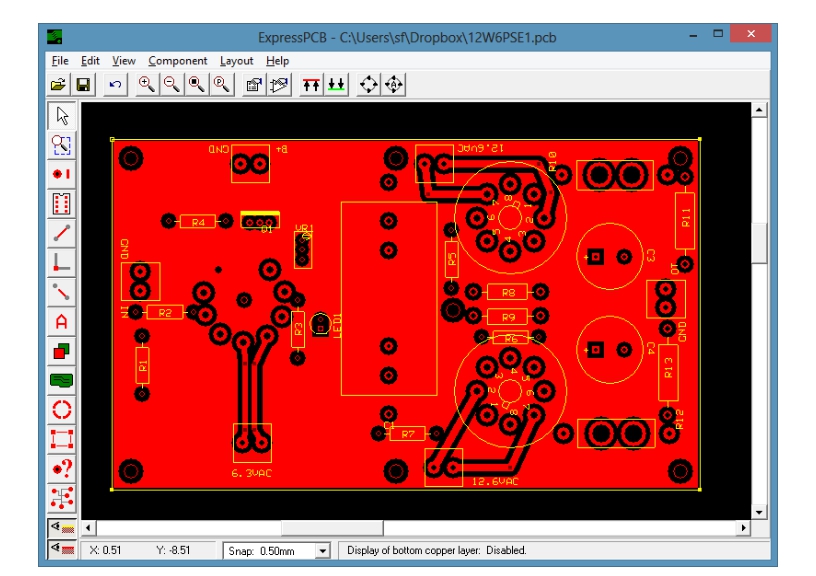

I'm using a loop breaker between signal ground and chassis ground. Is it better to connect the top layer ground plane to signal ground or chassis ground?
Do I connect the ground plane at one point only or multiple points?
Thanks,
Scott
There is no need to have just a single gnd point on such a small pcb.
I would use the top side copper as a common signal ground and remove all gnd tracks from bottom side.
Then all components that need to be connected to gnd will directly be connected to the top layer gnd via "thru pads".
Then the pcb ground can be connected to chassis ground directly or via the power supply ground.
Make sure that there are sufficient openings at the top copper for the mounting screws to avoid unwanted direct connection to chassis.
Thanks artosalo,
This is a little different than point-to-point concerns I guess. I've understood that in point-to-point wiring it is a good idea to have separate ground returns for the preamp and power amp section back to the star point.

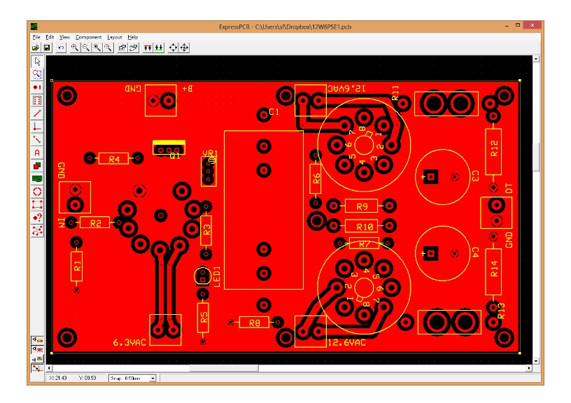

I was able to reduce the size to 87.5 x 150mm.

When building point-to-point the grounding should be as you said.
When using the pcb like yours, the pcb can be designed by using the top copper as common ground and then connect this ground from one point to power supply or directly to chassis.
