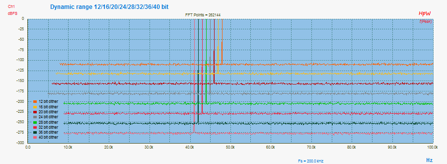

ppl say that 8bit is not good enough to see audio signals, what about 12bit DSO?
Some graph about various bit deep...

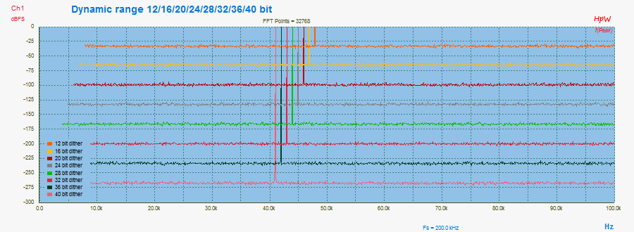

Here is an updated graph, while the previous had an additional Y-axis 3-D offset applied, what results in some confuse 😀
