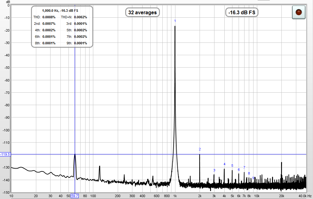

Before spending money on software, check out Visual Analyser (I think someone already mentioned this software). It's pretty good, mostly. I used it to do some THD measurements in a kind of spectrum analyzer/scope mode and I found it to be quite useful that way. I was also able to create a custom multi-tone stimulus signal so that I could measure loudspeaker IM distortion.
Example measurement:

Thanks for the tip! but this soft is compatible with some special hardware?
