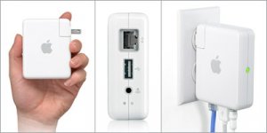

This is the device I use in one location: AirPort Express Base Station with AirTunes
At £88.99 ($129) I think it's a bargain. Will work on Mac or PC with iTunes. Works wirelss or wired.
