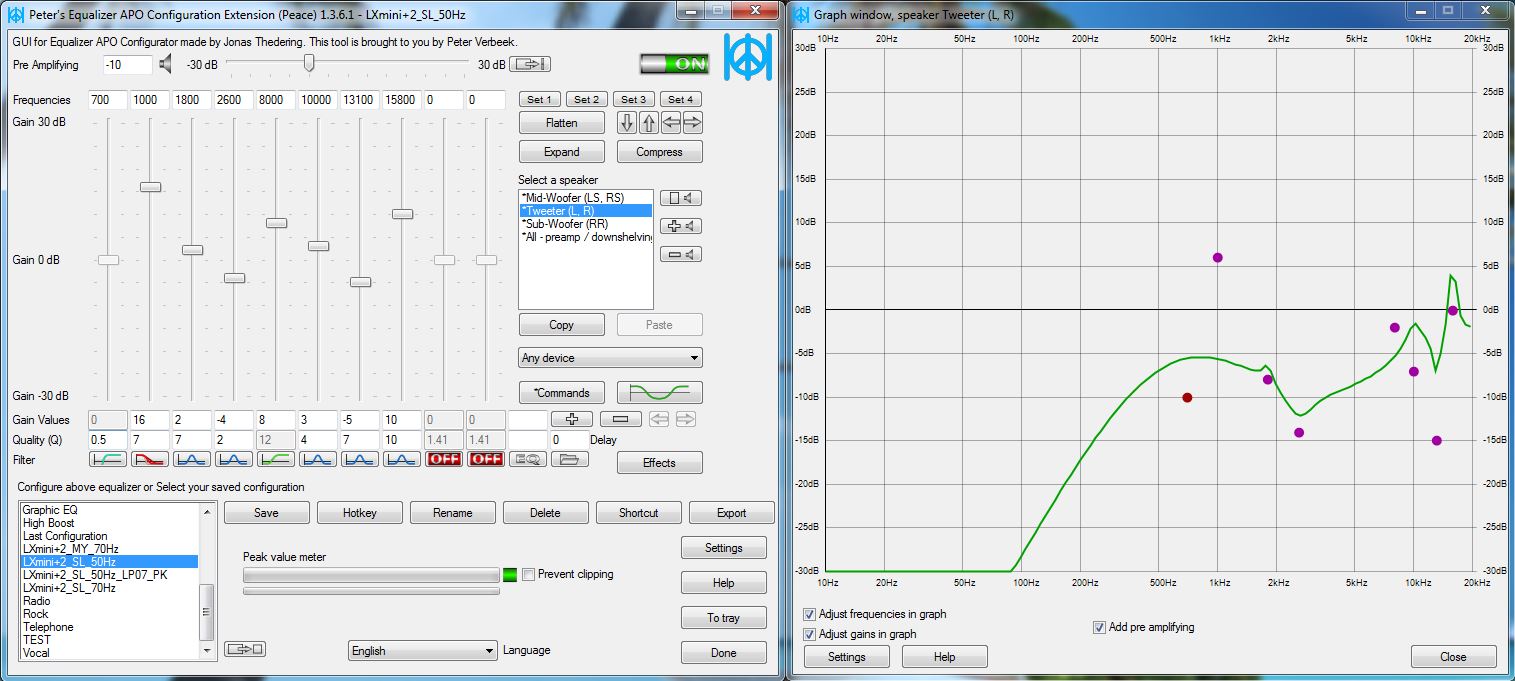

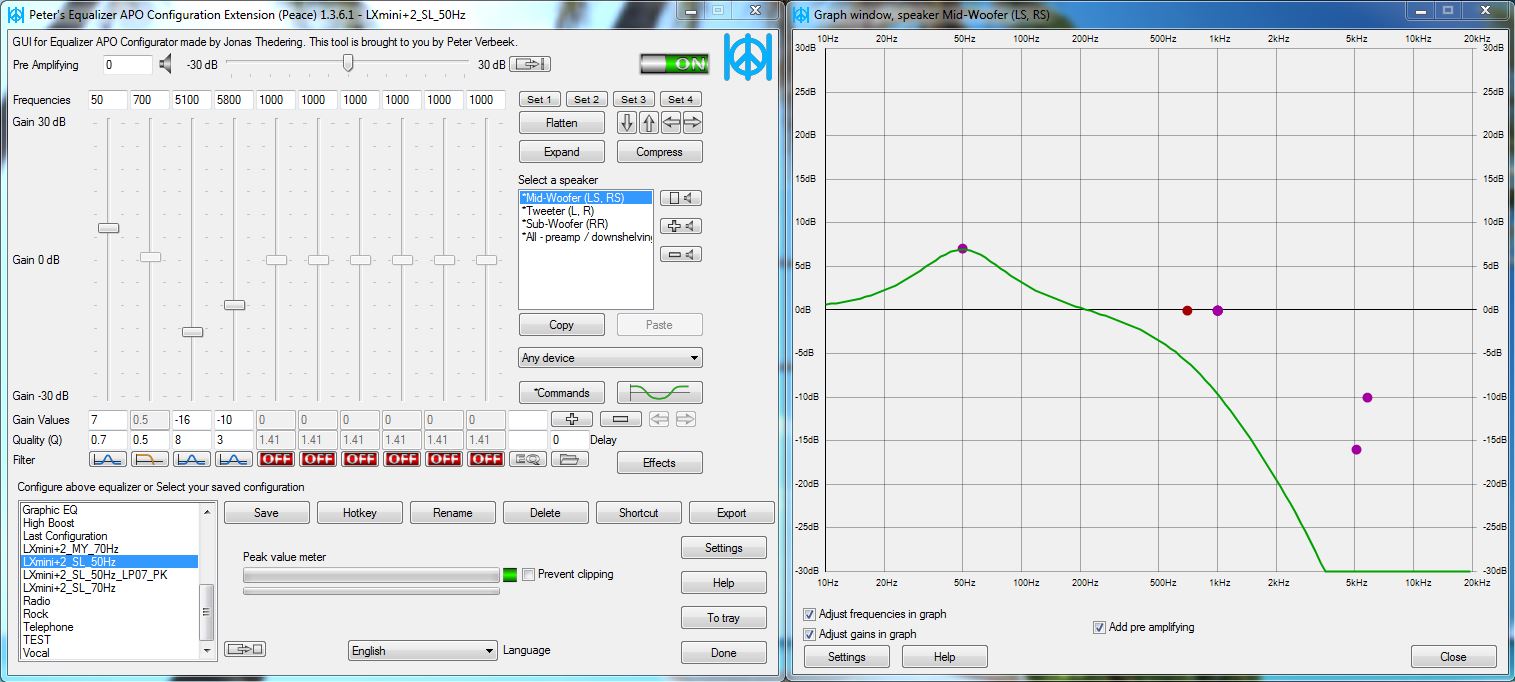

Here an example of my system how easy EqApo (w Peace) can be configured...🙂
