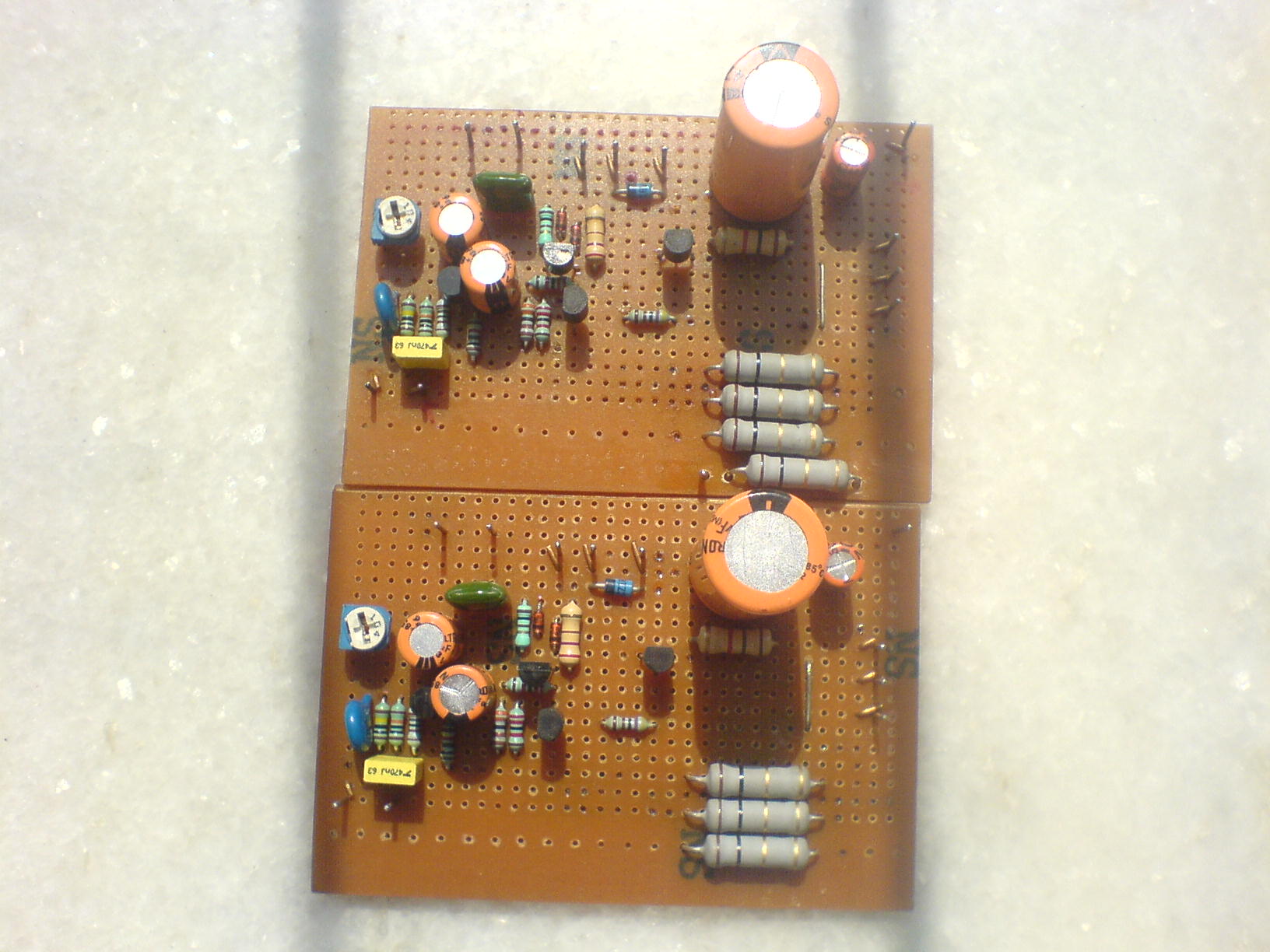

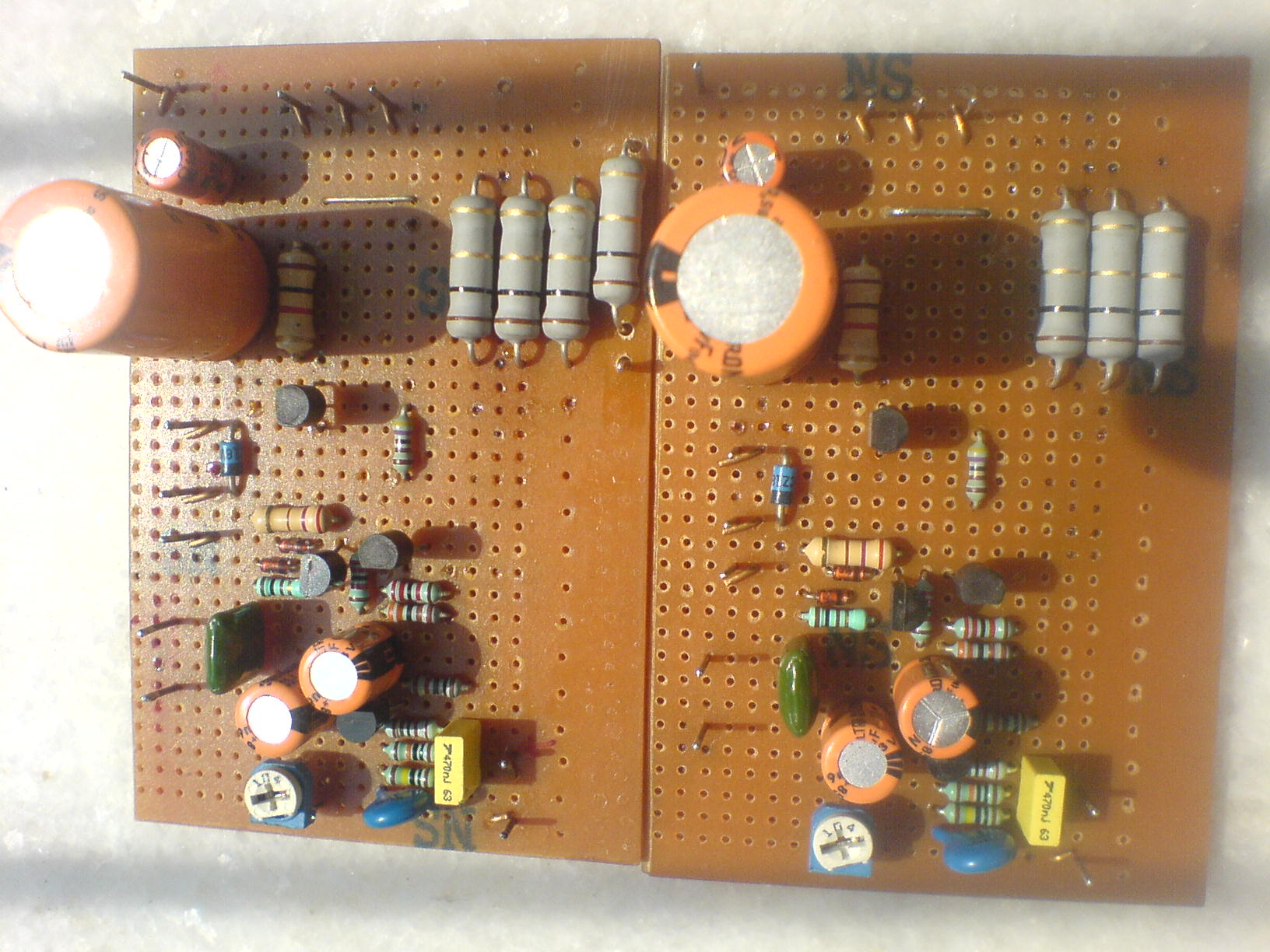

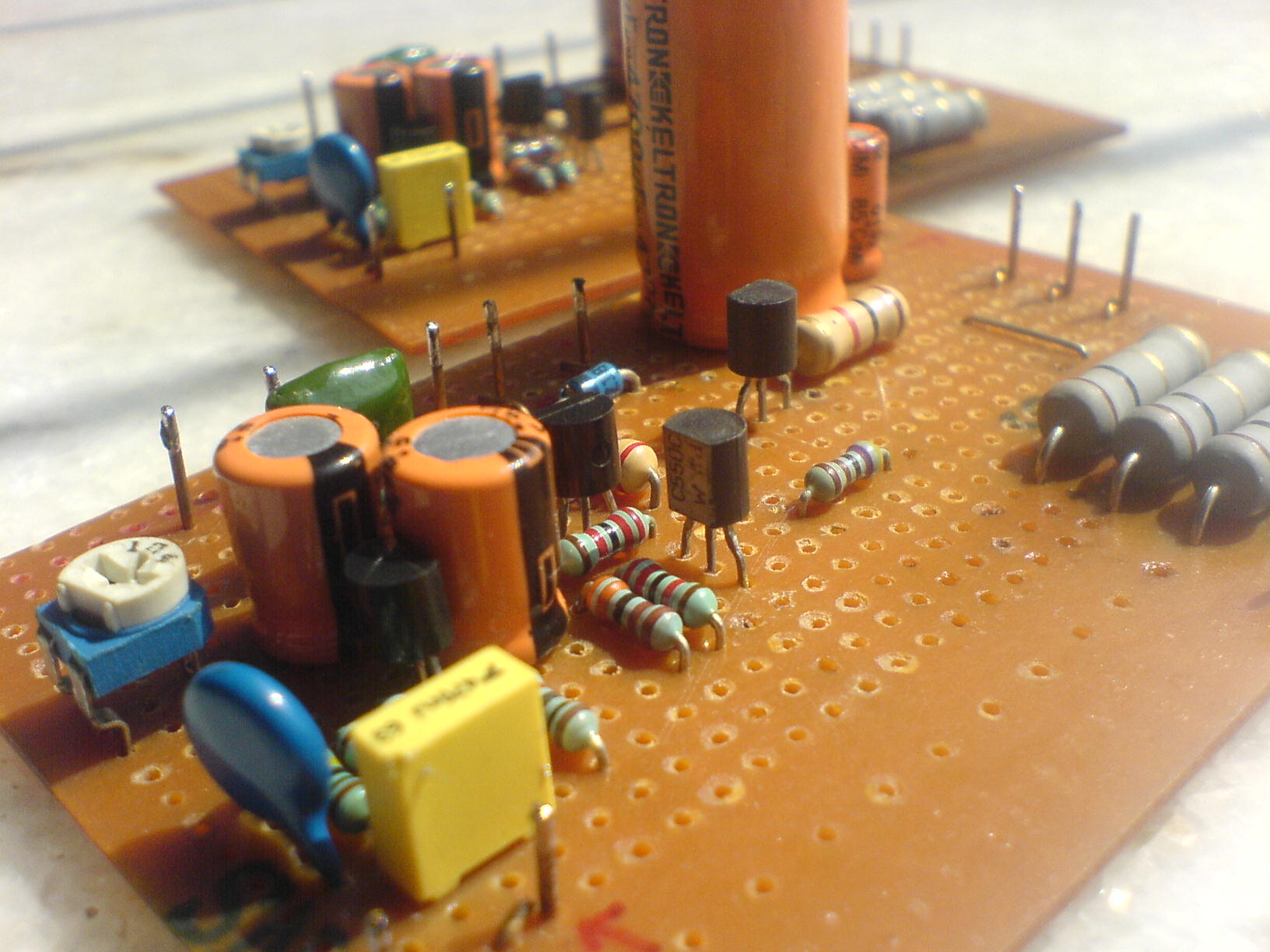

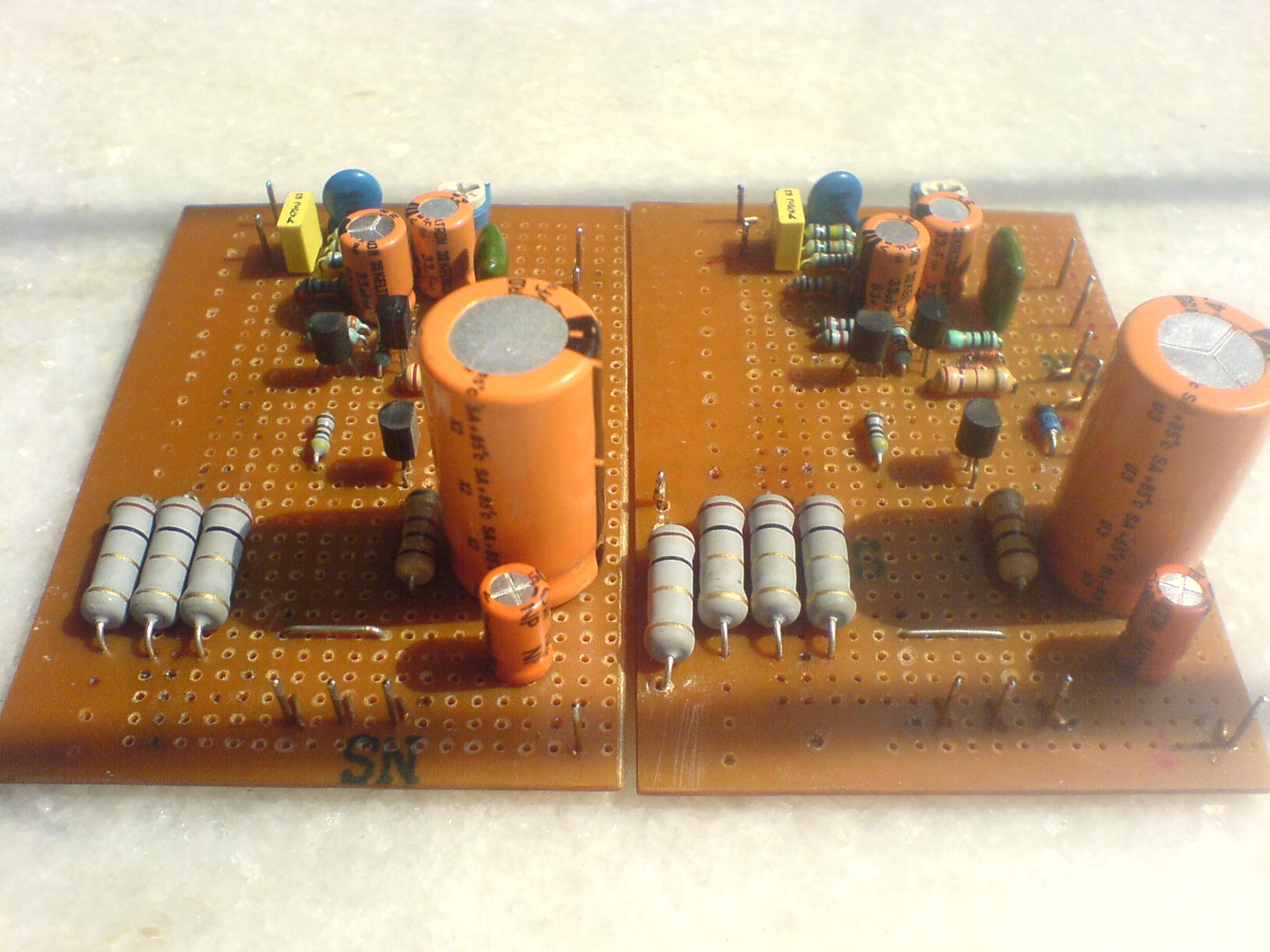

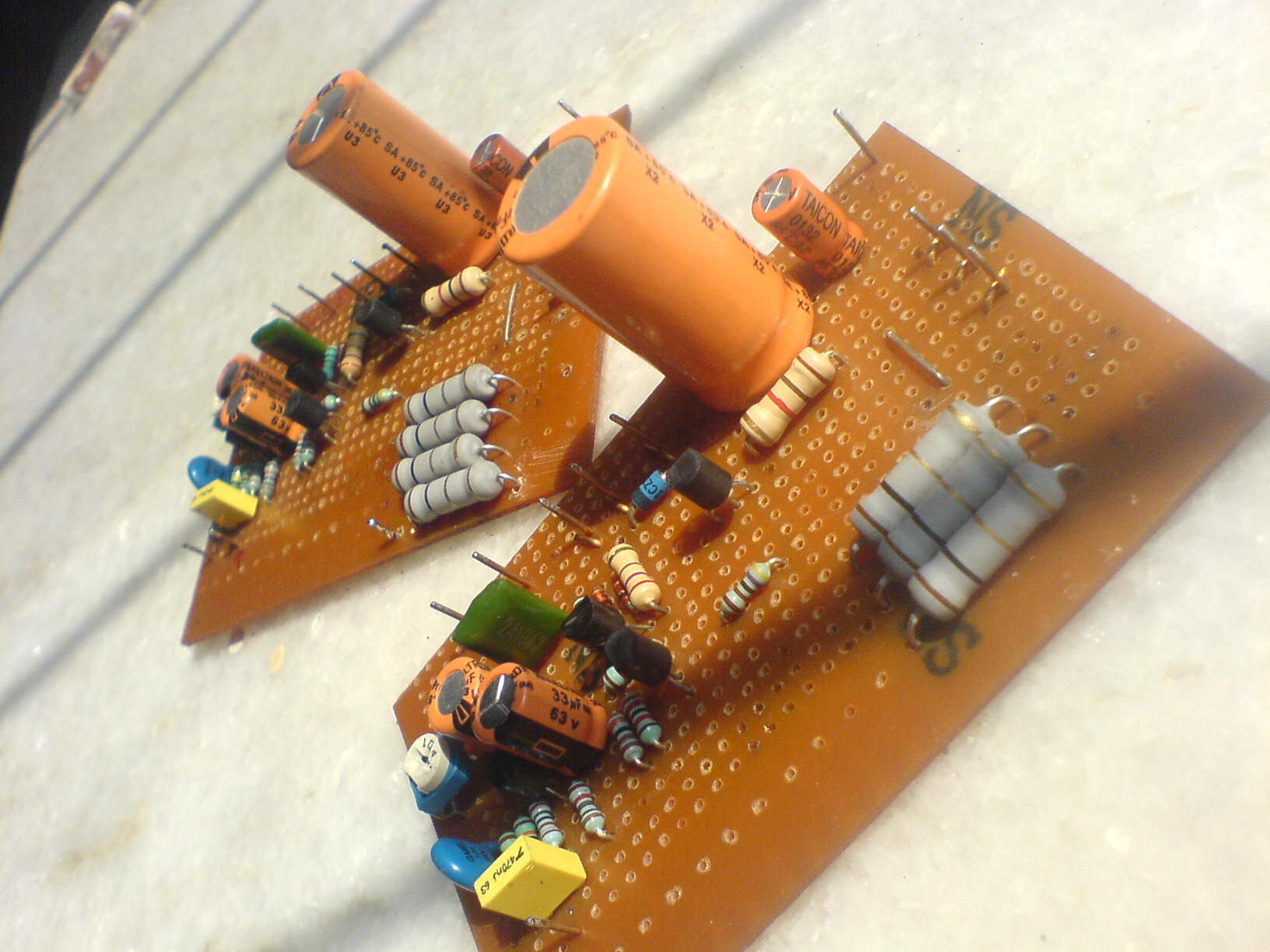

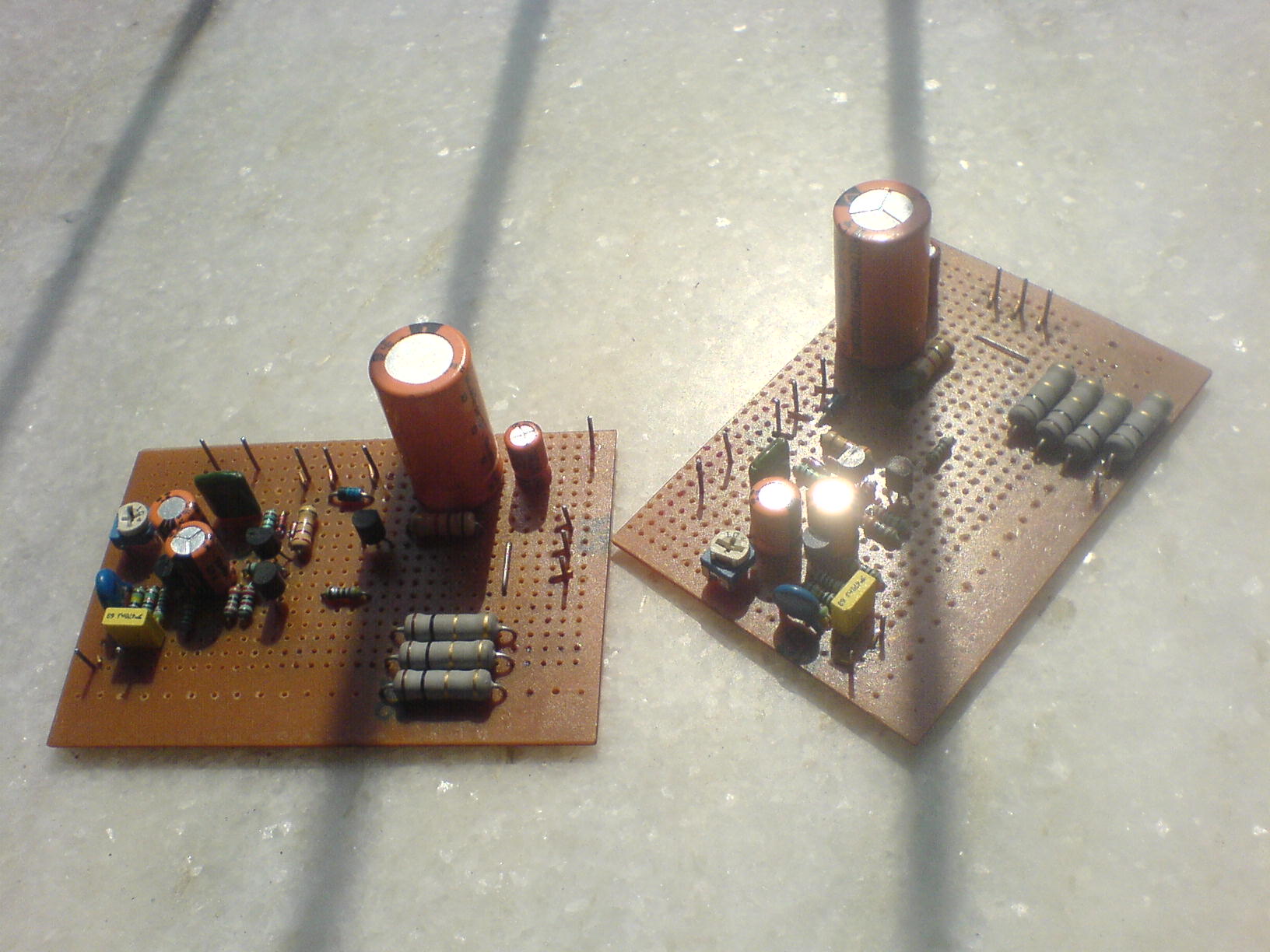

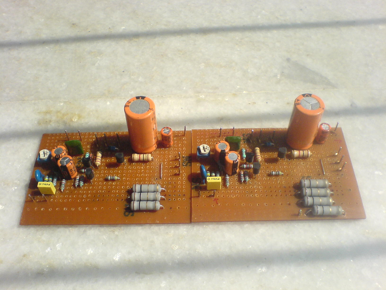

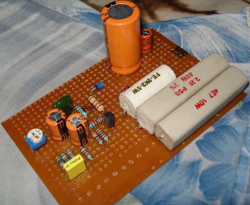

The Boards.
Here are some pictures of my version of DoZ+MPFv2. Both on dot boards, and are the final ones for the system.
The extra 1ohm/2watt resistor seen in one of the boards is the one configured for the summertime 24V/3Amp setting. The other board is going through the same process now. The underside has become "scratchy" in a part of the layout, this happened while removing the BIG 1ohm/10watt resistors. Otherwise I am happy with these.
The "work on progress" version of the original MPFv1 on the same boards can be seen in the last attachment. It was taken around September or so. Note the 2.2+4.7ohm resistors to form a 1.5ohm resistor 😱.

It's looking good Shaan !
On the topic of output emitter resistors. I added these to my simulations. They certainly do a good job of controlling the temperature sensitivity of the bias current. They don't do it any better than putting a temperature compensation diode on the heatsink. But I have realized that I was assuming perfect 'negative thermal feedback' for the diode approach. What I failed to recognize was the fact that the temperature of the silicon in the power device package can heat up pretty darn fast and it takes some time for that temperature rise to 'charge up' the thermal capacity of the heatsink. My diode temperature sensor would never be able to react fast enough to save the power device. On this basis, it's all starting to make sense again.
Perhaps those ThermalTrak diodes in-package can be used to avoid the need for those emitter resistors ?
