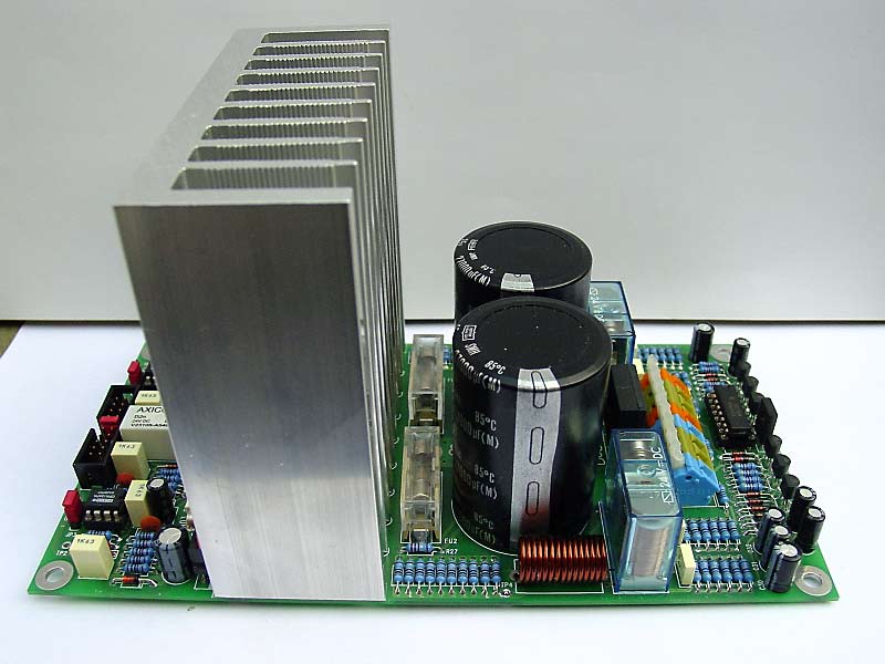

This is a brand new PCB design that Pavel has made. We were listenning to it for the first time here as Pavel described several days ago. I was quite surprised by the sound quality of Pavel's module. For the chipamp it is fanatastic and can beat many of the discrete amps. But a few of the very good discrete amps are still better.
Chipamps have their limitations that cannot be neglected. But they can be recommended as quite a simple way to good result, if done properly.

Here is how it looks assembled 😉

The schematic doesn't include the values of most of the parts so not much coments do do...
But from what I see, many things could be removed, some things could be included and some things could be made in a different way for a much better sound.😀

Carlos, could you speak in more concrete terms? I would substitute Pavel here.
From my point of view, it was very wise that he included input opamps into the design.

Without knowing many of the components' values (including PSU caps), allow me to make some suggestions based on my experience with GCs (yes, I tested all that you can think about, except valve buffers).
- Input op-amps yes yes yes! OPA627 (non-inverting).
- LM4780 - yes, very good, but I would use it as inverting, it's the best combination: NInv. input buffer + Inv. amp.
- Change that dreadful zobel by two paralleled 0.47 ohm/3watt resistors in series with the output, much better.
And... last but not least:
- Change the PSU caps on the LM4780 for 33~100uf and regulate the PSU with LM338.
tbla reports very good results too with LT1083.
BTW, trafo with independent secondaries and two bridges.
But I would have one comment. You MUST keep signal polarity of the amp as a whole. It makes difference if you invert it. At least loudspeaker wires should be turned when using non-inverting OA + inverting LM.
PMA said:But I would have one comment. You MUST keep signal polarity of the amp as a whole. It makes difference if you invert it. At least loudspeaker wires should be turned when using non-inverting OA + inverting LM.
Of course.
Forgot to say.
I invert the wires inside the amp.😀
+ speaker terminals connected to ground and - speaker terminals to output.
