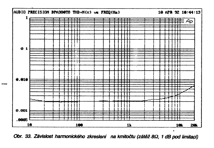

In this concrete amp are SMD devices used in drivers and diagnostic circuits and also in CPU...
Regarding parameters, this was DPA380 THD vs. frequency, 8ohm load, 1dB below clipping:
Nice THD ratio but looking at the schematic i spoted a copy cat
of Bob Cordell s error correction circuit.
Since adding this circuit reduce THD by 40dB at 1Khz and roughly
20dB at 20Khz it is clear that basicaly the DPA380 has high distorsion
and could hardly battle a DX amp if the latter was added the said HEC....
Maybe Carlos should have offered a complete building instruction of his design with Hawksford error correction 20 years ago.
That s not the point, Jacco...
The error correction circuit is simply a copy/paste of Cordell s implementation,
as well as the following mosfet OPS , the rest is a classical symetrical differential
that was very common a decade earlier than this design....
Besides , the said amp s input differentials have no degeneration wich greatly
increase GNFB and reduce distorsion , yet the measured ratios are quite high
considering the design guidelines.
A Crecsendo with miller compensation and with error correction would
be quite better....
be quite better....
