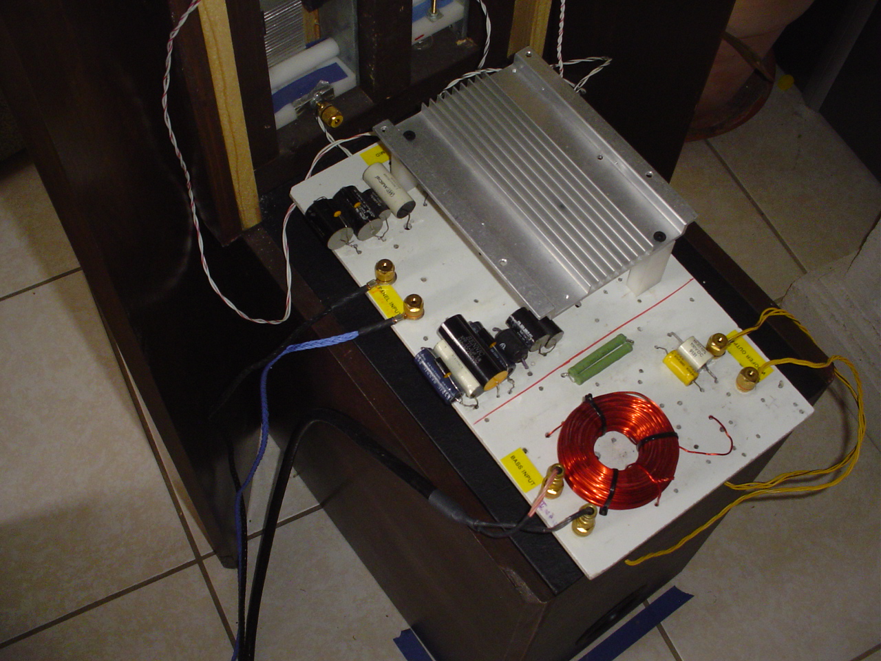

These are crossed at 200hz/12db slope.
The Bookshelfs handle the bottom end.

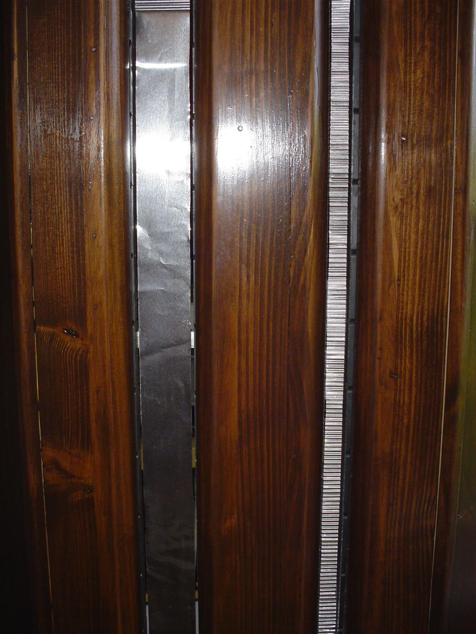

I tried a foil from .22uf cap and it was a SMIDGE clearer up top, but sounded like a trash bag in the wind when lower sounds were cranked.
There is no significant difference in sound to me between the two types of ribbons that a small adjustment to the EQ could not fix.
Pros to lighter foil were higher treble response and (maybe) some more clarity.
Cons to lighter ribbon are higher x-over point, and like 8x the power consumption.
Pros to 4 piece foil ribbon stuck to packaging tape are SUPER durability and they play lower without audible distortion. Loud too.
Cons are extension into higher range somewhat hampered, and (maybe) less clear, but not enough for me to try to keep .5 um foil in one piece on these things. Those are delicate, to say the least...

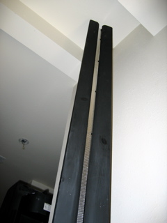

I just made a pair of floor to ceiling ribbons, 80".
I am going to put a sock over these I think.
This wedge design makes them less intrusive, still playing with tensioners.

Resonances in the back cavities
I wonder what are the resonance frequencies of the two cavities in the back?
Around 1Khz and 8 Khz and quite large about 10 dB.
I build the thing and quit with the design because of the large peaks.
De design is perfect for the magnetic pad but not for the acoustics.
Build an normal ribbon later with square iron bars and had only 2dB less output but no peaks at all.
Maybe I can find the measurements then I will post them here.

Yes the pic of the x-over is actually the back , it's sitting on the sub, the rear of the panel is in the background , you can see the ribbons ...
The cavities shown in second pic #27?
From post #15:
The first cavity is made of the space between the two steel bars that hold the magnets. The second, bigger, is made of wood. The second one is easy to see at the bottom of the picture.
Suggestion: line the cavity surfaces with wool felt.
