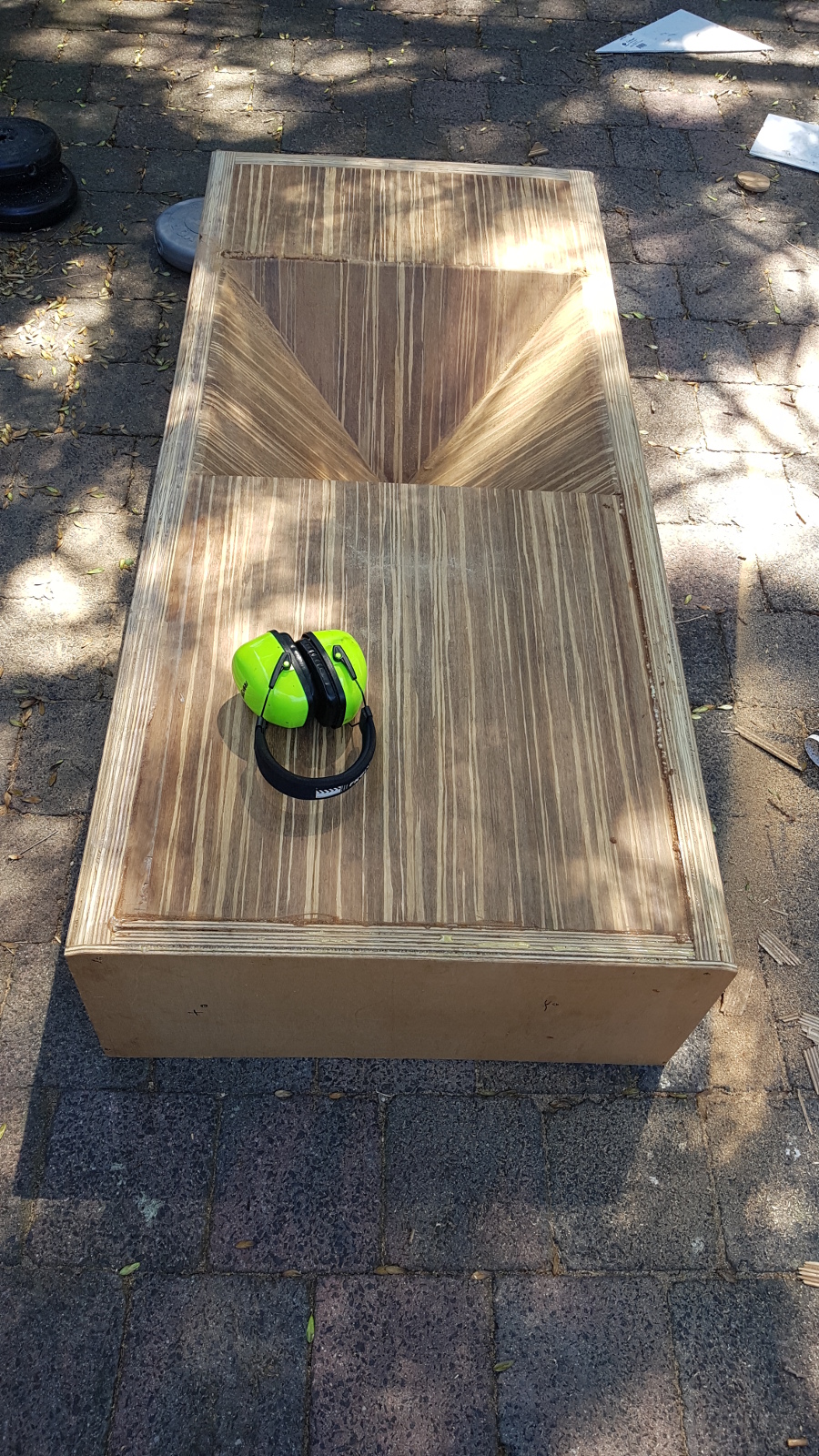

Making slow progress:
-I have complexity addiction
-I'm trying to build this from existing materials / clear my shed / use up scraps. Marie Kondo would approve 🙂
-I fail at the "measure twice cut once" thing
The thick trans-laminated cabinet edges were largely made from of plywood offcuts. The multi layered section is only a few cm deep: I want just enough material to allow for some rounding of the edges. Any more would be extra weight.
I also tweaked the plan, making the horn closer to square (90 x 80 degrees). The mouth is now 500mm high, with 300mm of baffle above it (the section covered by tools in the picture), so it should have ~symmetric pattern control.
The face sections are a laminate [ bamboo || ply || plastic grid ] to try for a high amount of strength and damping for a relatively low weight. I'm using a double layer of bamboo in key spots, to allow me to grind + sand more of a curve into the mouth-baffle transition.
Just visible on the right of the pic is one of the holes for the leaky bass.
TL;DR: I'm trying to smoosh a lot of my recent design ideas and experiments into one project, and make it pretty.
I think I 'understand' the leaky bass section, need to read up a bit more on that.
I don't fully understand it either. I can visualise how a figure 8 pattern can form but not the more complex shapes.
Here are progress shots, showing I how I'm setting the bamboo/plywood panels slightly into the shell, then grinding the shell back to get the edges flush.
This grinding step means it doesn't matter that I jigsawed together a bunch of wonky scraps and offcuts for the trans-laminated part - it makes me a bit sad when I see (otherwise amazing) projects that do CNC translam from whole sheets, generating enormous amounts of offcuts and waste.
The blobby bits in the photo are where I'm filling in chips and gaps with a slurry of glue + wood dust. The bamboo 'heals' remarkably smoothly. I guess it is because the fibres of the normal panel are so smooth / tightly packed that the fixed up section doesn't stand out. In real wood, filler sections look oddly blurry, like they've been photoshopped IRL.
