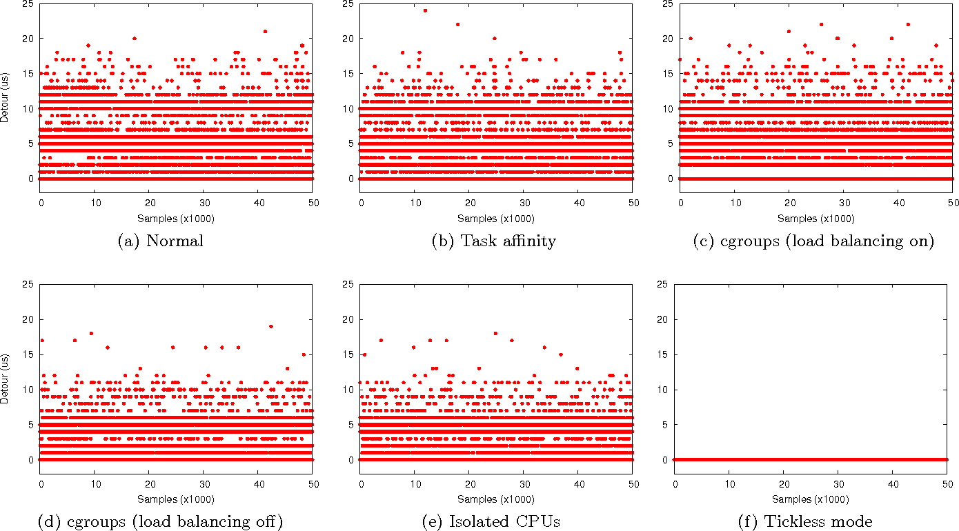

The Linux Kernel brought with 5.15 a new tracer (RTLA)to trace OS-Noise and Latency in a white box approach, so you can easily make your Kernel configurations or system modifications visible....this is a HUGE help to see what does what...and we can now truely measure OS-Noise, so it is not a philosophical believe question.
Have a look just as an example on the osnoise effects of binding tasks to CPU-core vs. isolating the core vs. true tickless operation:
View attachment 1099657From H. Akkan, M. Lang, L.M. Liebrock, Stepping towards noiseless Linux environment)
The RTLA-Osnoise tool is very powerful, it shows you the noise effect of anything you try per CPU-core be it threadning IRQs, isolating core, assigning and priotizing task or running a tickless Kernel. I invite anyone to try it.
Sofar there is a very strong correlation in my experiments between lowering OS-Noise and better, more direct, more transparent SQ with richer tone at the same time, some people would call it "analog" sound...you can measure as well the effects on OS-Noise of

still really curious what tickless mode can do, tho you dont have much cores on the rpi4 to really utilize it, but it might help anyway
