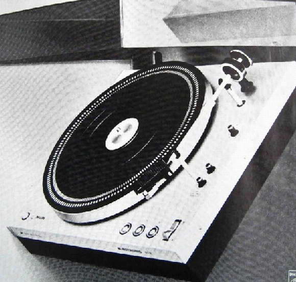

Phillips have used simple flip flop circuits, using discrete, to control
this turntable.... was touch sensors.... need just to touch and one lamp goes on and the circuit goes operating.
Was made by Philips.... a very respectable name.... pionner into CD, cassete technology and a lot of other things.... was made down the eigthies, when we already had microprocessors.
Keep going an moving man!... go ahead with your good work.

Re: Phillips have used simple flip flop circuits, using discrete, to control
The GA-212 with green lights was made around 1975 and followed by the GA-312.
I was absolutely gobsmacked (well, not really as this word didn't exist at the time) by both the 212 and the Beogram 2000 (?). Fortunately common sense prevailed and i ended up with a Dual 701. Still, it looked ultracool.
